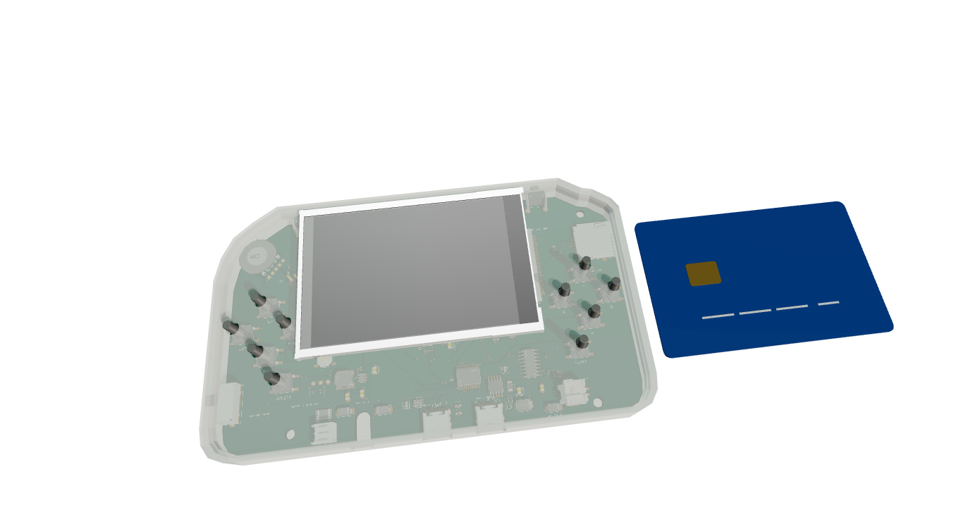

@Abse this is the current state of my
mention this is the current state of my gameboy what about yours? https://tscircuit.com/ShiboSoftwareDev/linux gameboy advance
Started by shiboOct 13, 202613 messages
Last active 6 days ago · plain text
<@398467566588264449> this is the current state of my gameboy what about yours? https://tscircuit.com/ShiboSoftwareDev/linux-gameboy-advance
<@398467566588264449> please review and send me yours to review
<@809856037376491570> Please review

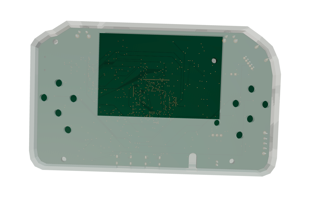

Is this supposed to be this big?
What are these holes for?

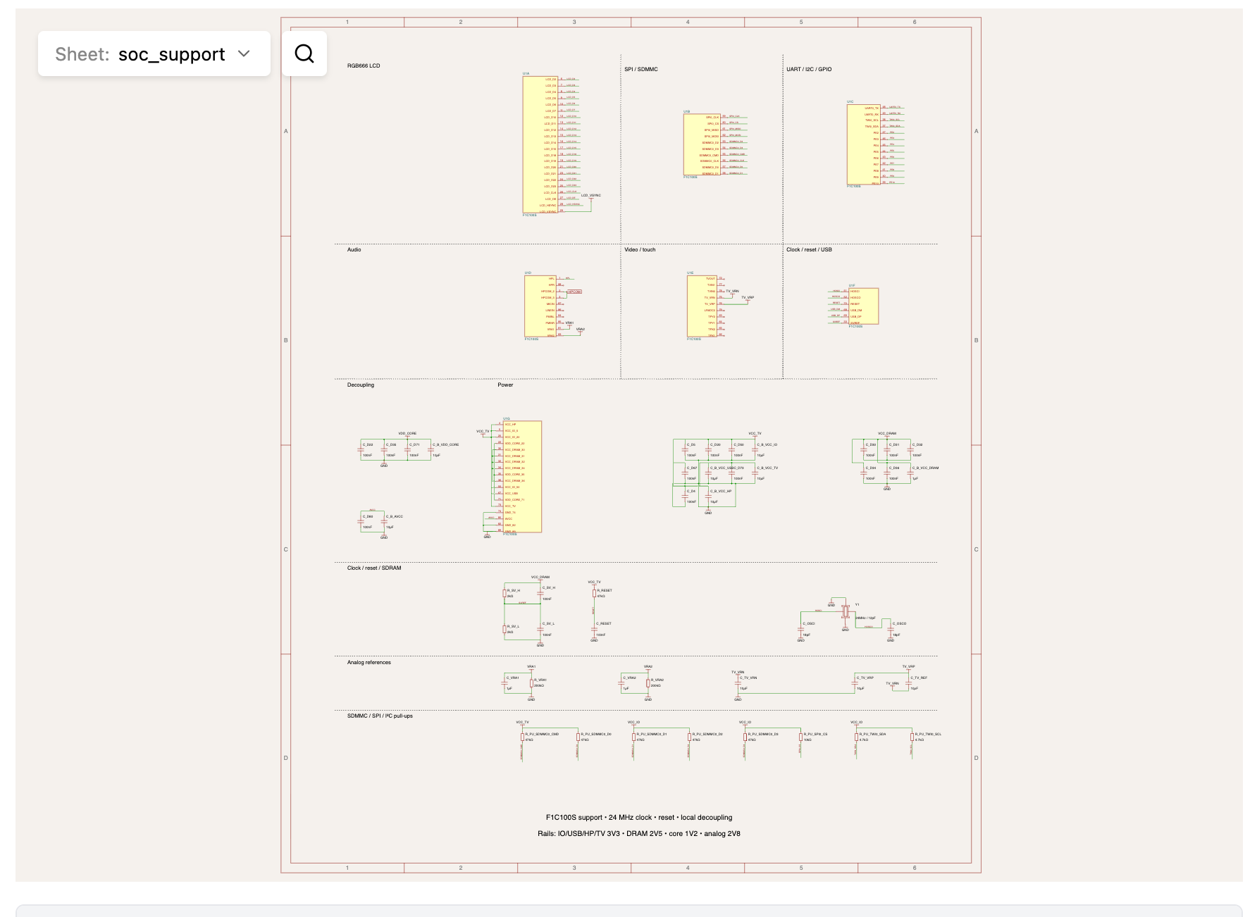

It get's difficult to review if you don't use the standard schematic sheet size

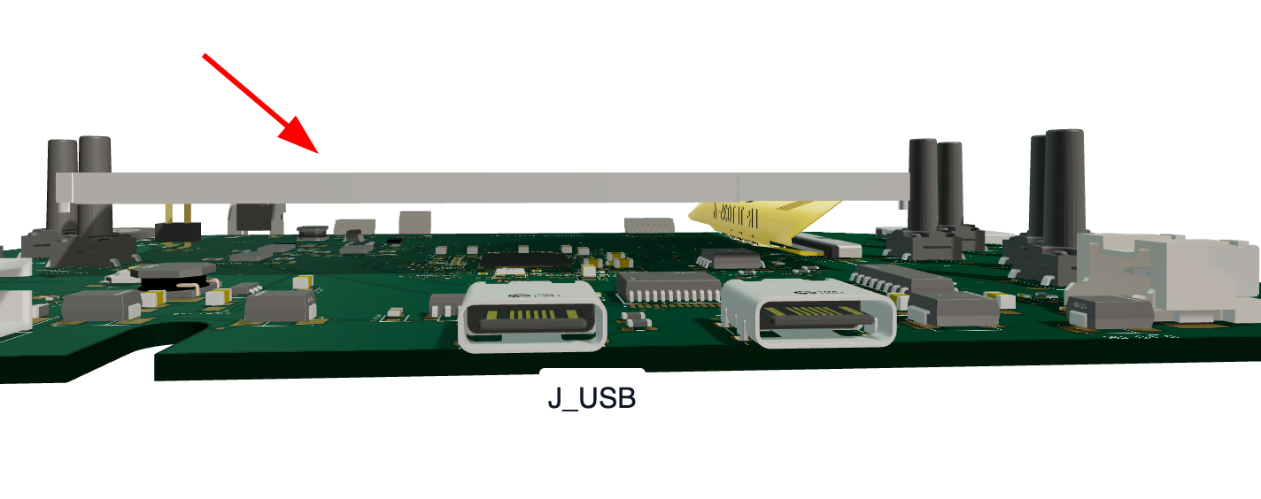

Also, why 2 usbc ports?
I don't think the enclosure is thought out well, where are the holes on the pcb for the spacers to put the screen on?
this is our native enclosure component API, it's very buggy, I'll do a manual enclosure
we always need 2 right? one for power and one for programming
That is for motor controller, this is just a gameboy. It will run through the battery
when we're programming we would use one usbc for data and power?
<@778624824875941908> for low power devices you only need one usb-c for power and data because you don't need higher voltages/power
