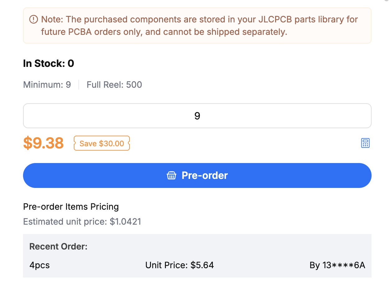

Is your optical sensor in stock
no, is preordering an option?
Consignment? Ideally not for first version, eventually we will cuz mustafa needs it too

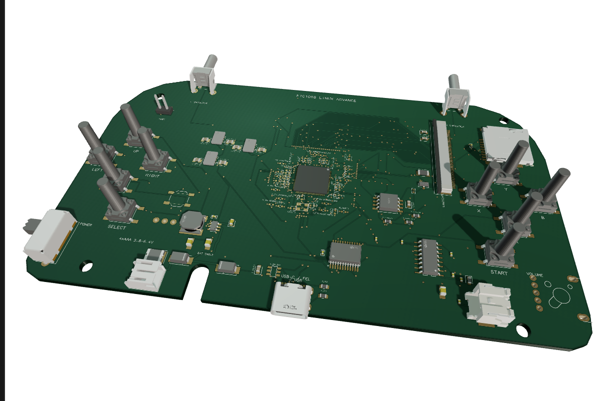

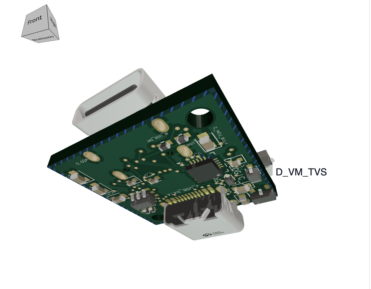

linux gameboy: https://tscircuit.com/ShiboSoftwareDev/linux-gameboy-advance#3d 20x20 nema8: https://tscircuit.com/ShiboSoftwareDev/nema8-20mm-usbc-pd-controller#3d I'm fixing some 3d rotation issues for it, and it's also using blind/buried vias which is not desired correct?
gameboy: make sure the connectors are in the right places, microsd is too far, power is in an unusual place and will get accidentally pressed, J_SPK i'm not sure what it goes to. What is the display for this? Try to populate all 3d models and check for jlc availability. Try to add an i2c and spi jst. You need a uart jst as well (there is a standard for this- see the standard programmer)
NEMA8, make sure <@809856037376491570> takes a look, if you can get both usbs on the top that will be better for space clearance, better to have the driver and mcu etc. on the bottom then get the connectors on the top
yes you cannot use blind/buried vias
it will drive the cost too high
you can create a TSX file that loads a NEMA8 GLB to test the assembly if you're so inclined, don't worry about that too much because we might make it easier by having modelprinter strings for it

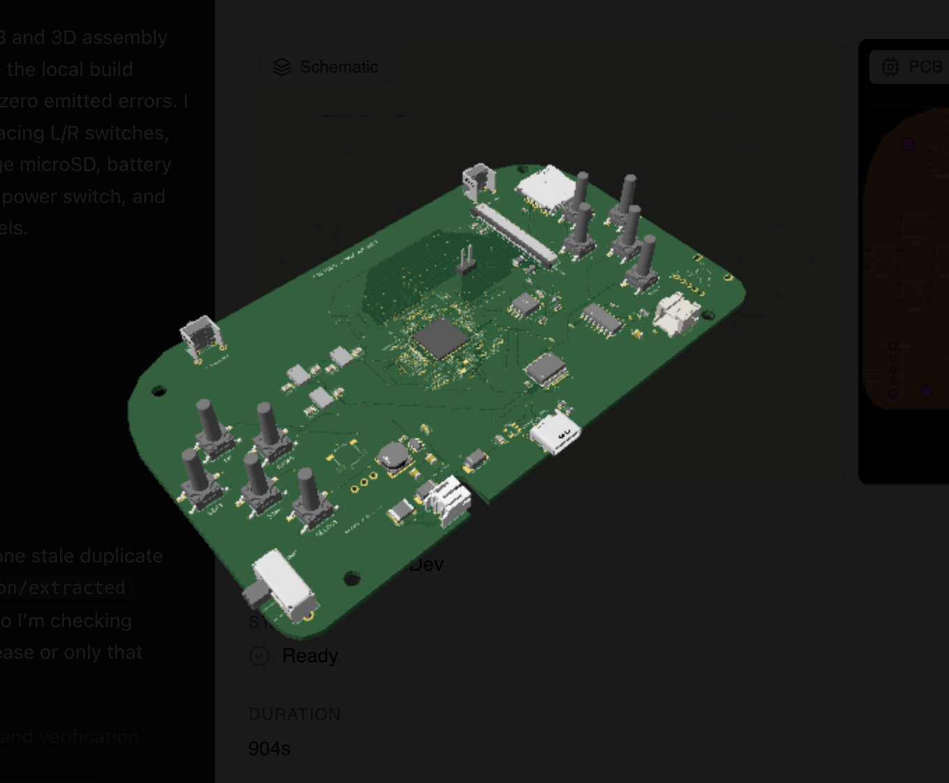

looking pretty good
i'll connect a SPI display to the allwinner maybe we can do some kind of performance testing- how much storage do we have by default 🤔
<@778624824875941908> jlc is on holiday for 2 more days, so you have some time before there's pressure to order
