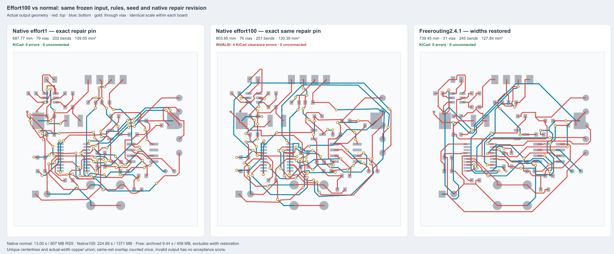

0hmx - asked ai to compare us to free routing
Started by 0hmxSep 30, 202621 messages
comparing the effort right now
are you sure this is pipeline9
can you use the latest version and pipeline09

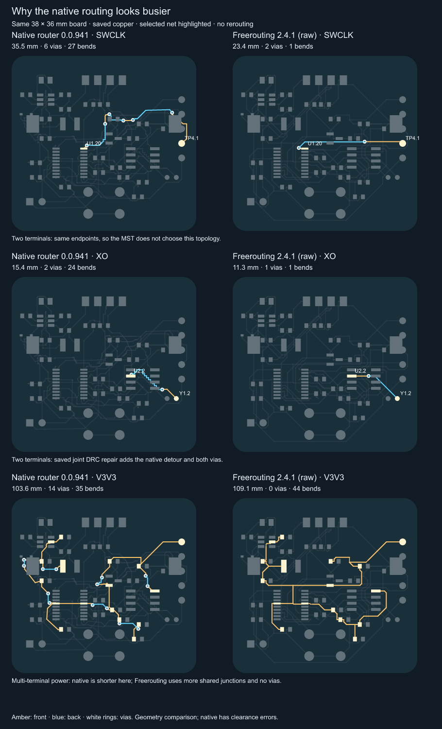

also freerouting fails on 50+ trace boards, it is pretty decent on small boards for sure
I asked the ai to see if our previous stage of graph Coloring optimization algo and we can expose that as an algorithm to use in simplification stage if it works well enough I am not sure it's working background
effort is just completely broken right now, we might as well turn it off everywhere and just run simplification longer for higher effort levels
