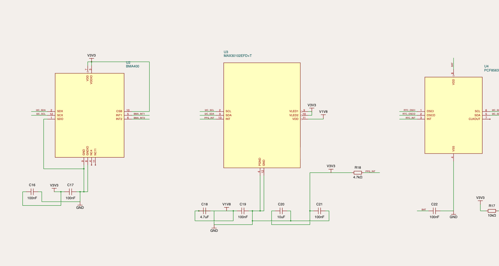

not routing yet
ask ai to break up the schematic into sheets and sections
hard to read it as is imo
anil
yes fixed all now

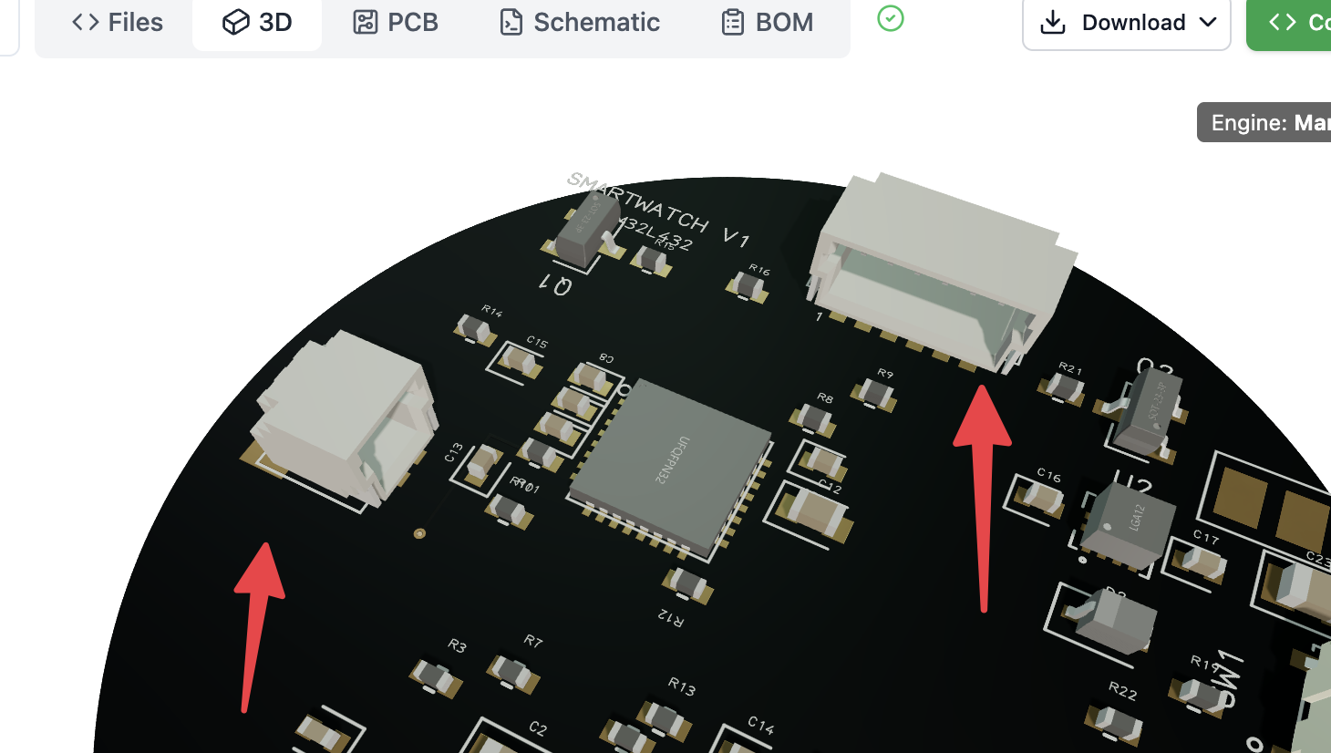

i say try to keep things on top layer , i think those caps could be harder to assemble some connectors could be placed easily with hand.
anil
Fixed, moved everything to the top layer.

how do you program this ?
yea i see the programming pins from STM were exposed on J3

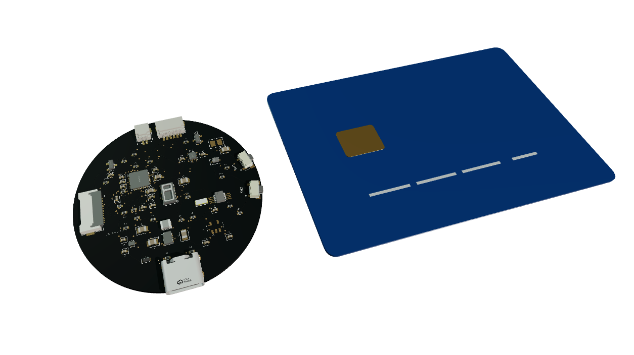

also did you find the correct display module for this board ? make sure the board don't overflow the display size.

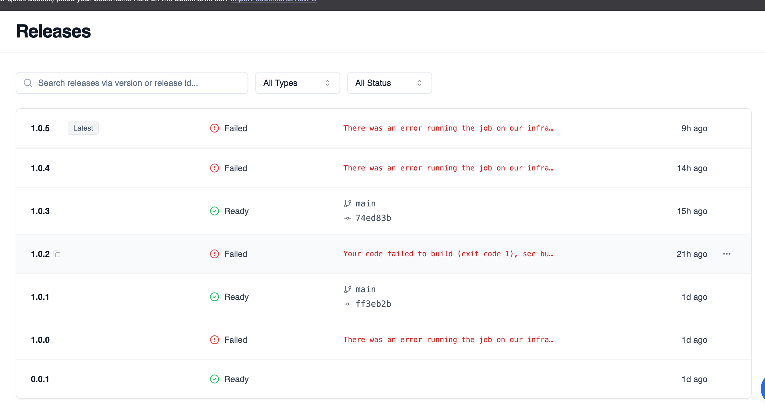

<@1507703667237716221> hmm why isn't it building
try rerunning maybe
anil
build is done this time.
the heart rate sensor means that the board has to be pointed onto the skin of the user
i'm not sure how you can do that with the usb port etc. sticking out
the heart rate sensor is like $14 so not exactly something you'd want to mess up basic placement on- i think it has to be on the bottom or just remove it from the first version
