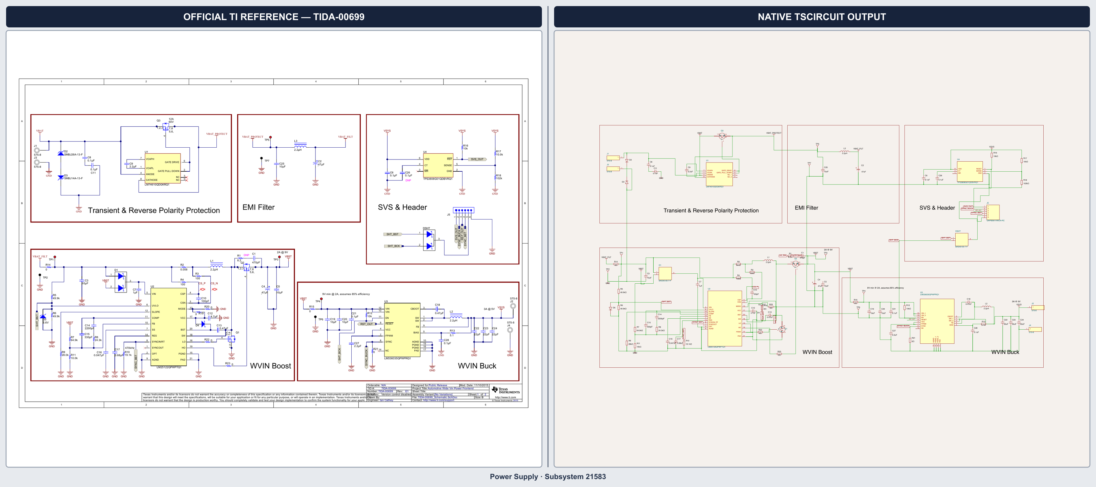

this channel is for physical board designs, this is more appropriate for mention for now, you should use schematic sections not boxes otherwise it's pretty good it'll probably be even better once all the schematic trace solver changes are live these should be test points likewise

this channel is for physical board designs, this is more appropriate for <#1265314333764878387> for now, you should use schematic sections not boxes
it'll probably be even better once all the schematic-trace-solver changes are live

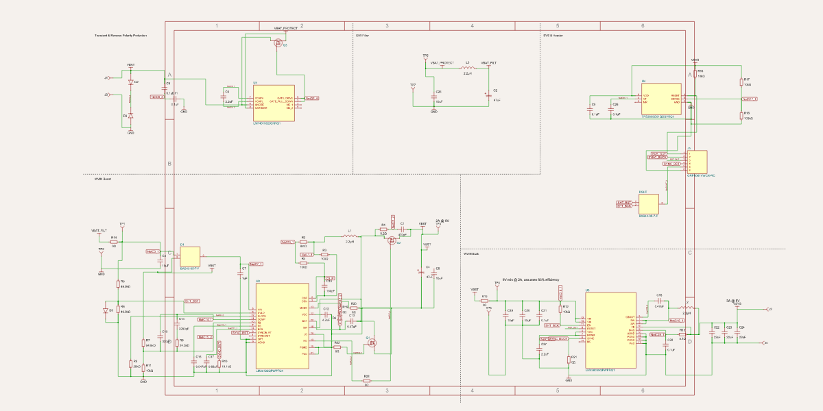

yea i think this happens if you set schSize to a number
i was tell <@436098556974333952> that that messes things up
well make sure to have a <schematicsheet />
it might not fit
see in the bottom right how it says "Size: B"
that's a "large" sheet, ANSI_B, <@436098556974333952> is trying to add support for that but it's not supported yet
he's afk i don't think he has support for it yet
<@436098556974333952> can you see discord mentions?
fwiw tho
your schematic is too big
i think you could make it smaller
i THINK you have a lot of extra spacing
you can probably fit it in size A and the pdf will probably look better if you do
