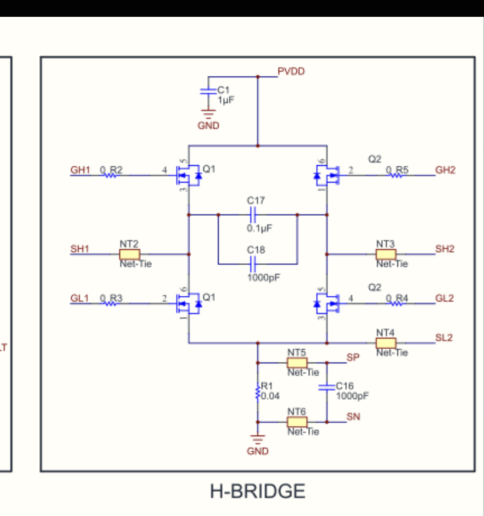

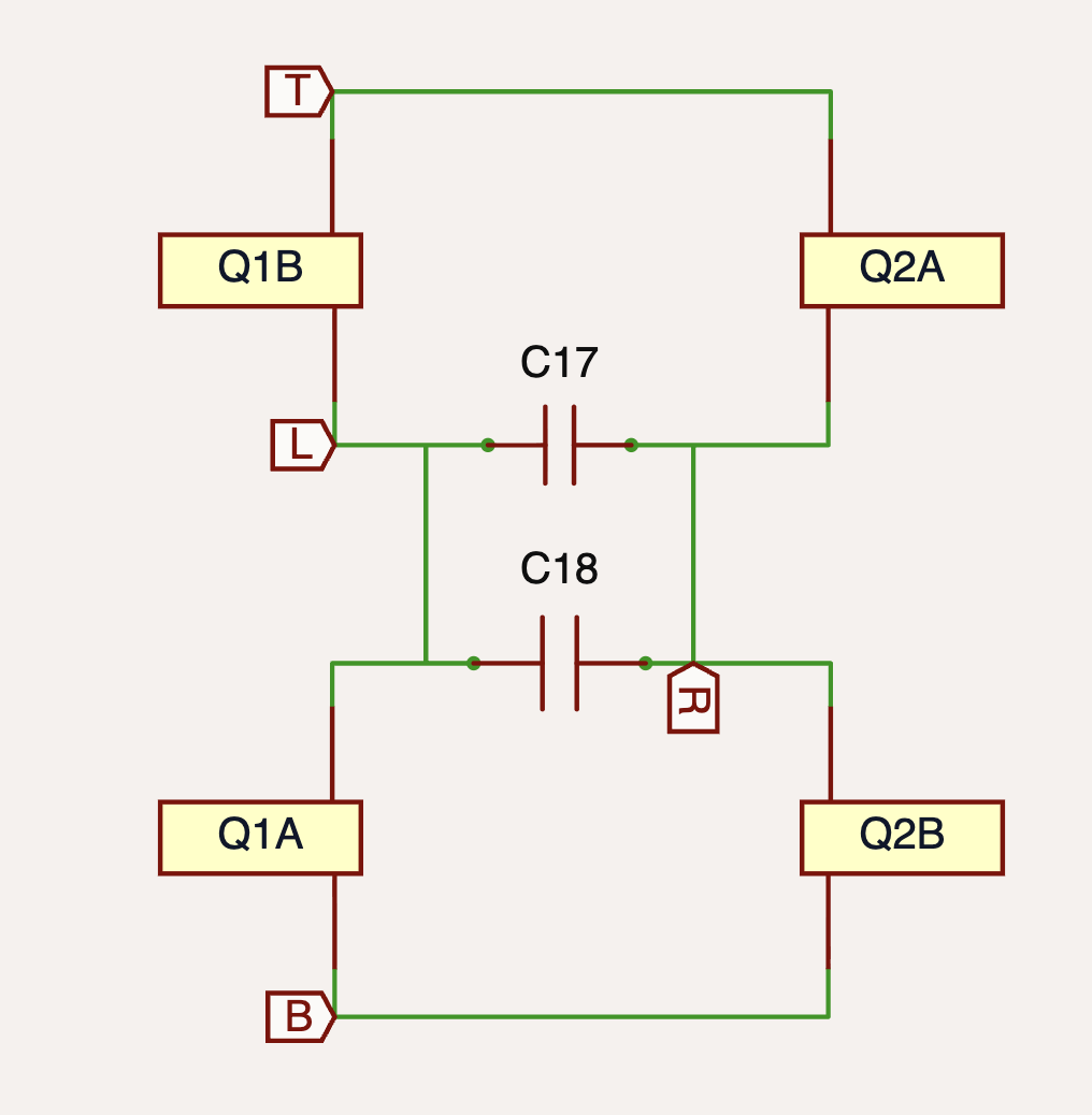

ehhh i disagree with your solution, now that i can see it
where is the reference
idk ur call
<@757706909351411845> <@809856037376491570> can I get another review on this https://github.com/tscircuit/ti/pull/132
Wdyt?
<@757706909351411845> wdyt should we follow the ref?
hhmm
i don't feel strongly about this case tbh
the net labels are annoying though
Should we keep the routing as it is now?
Wdym?
Like the auto generated ones?
the L, R etc.
i think we should inline or remove those

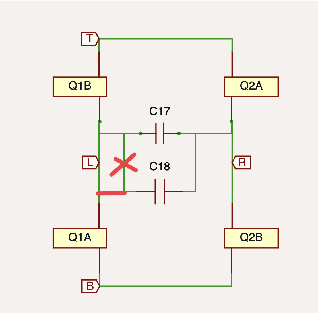

<@757706909351411845> https://github.com/tscircuit/schematic-trace-solver/pull/973/changes#diff-60f4dfa882b09810a2721a841cdf06680ecf388b78ec594c5942130110dedffb
revmoed the net lables not sure if we are going to merge this or not ?
i don't think we should merge it- i'm actually confused what you're doing with that pr
it's a core issue if core is asking for the net labels to be provided
removing it from the test doesn't make it so that core does the net labels better
i don't think it's a clear win from a schematic perspective
Im only trying to make the routing as the ref
there are other solutions that would improve what we're doing but disagree with ti
yea i don't think the ref is perfect on that one

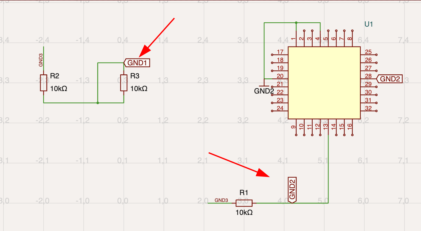

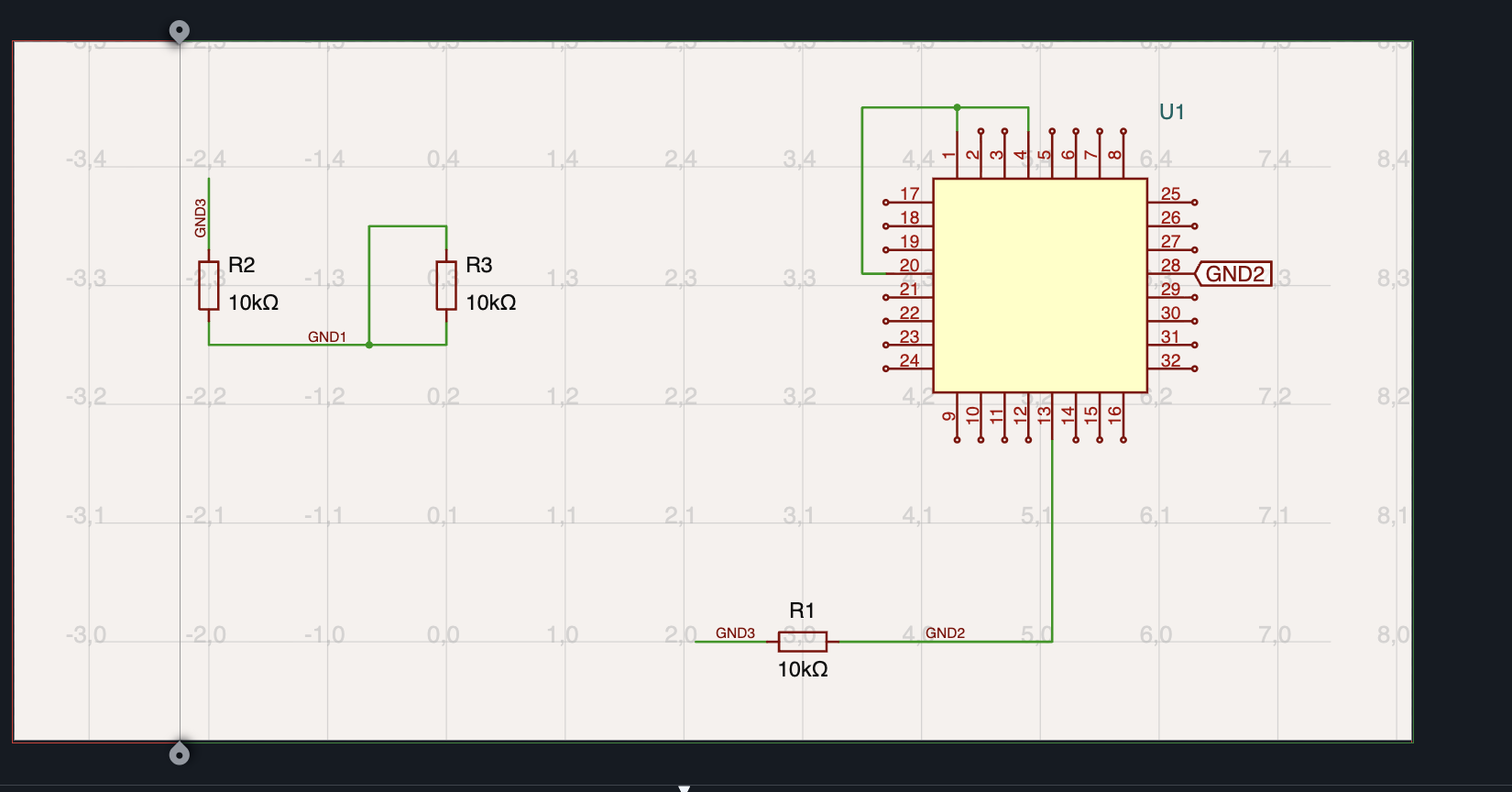

<@757706909351411845> <@809856037376491570> https://github.com/tscircuit/core/pull/3522
<@757706909351411845> <@809856037376491570> for this pr do we only want to preserve the gnd symbols ? like is it ok to replace the GND net lables with on trace label
I can see that we want to keep the generated gnd symbol but what about the normal gnd labels pointed by the red arrows
I think on trace label replaced with the netlabel is okay, but yes the GND symbol should be there
sg
