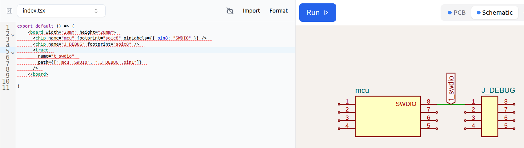

0hmx - @Seve @Rishabh was this intended somehow...
mention mention was this intended somehow?
Started by 0hmxJul 30, 20265 messages
<@757706909351411845> <@809856037376491570> was this intended somehow?
<@1079361271687807026>
Yes that is correct
Name on trace will be a netlabel
Vanuan
This is an incorrect schematic. It implies there is `t_swdio` port somewhere on another schematic sheet or section. In addition, if it was a proper port, there should be a junction point stemming out from a trace to the port. In addition, this shows the signal is coming from somewhere else to both chips. This is not a correct schematic representation of what tscircuit does to electrical connections or what the code implies.
