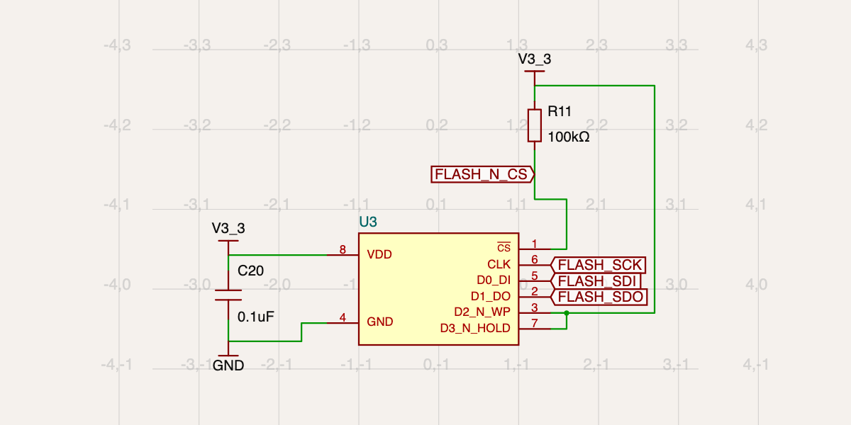

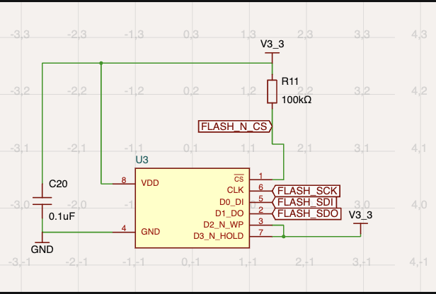

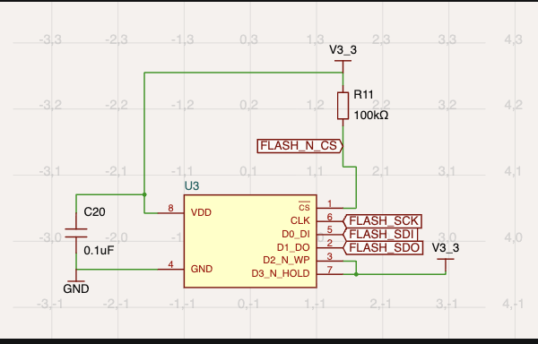

<@757706909351411845> can you tell me which one looks better.. by redability ??
or this ?
i feel like the second is better .
yea second is better
Vanuan
It depends on the role of that capacitor. Here it seems it's the decoupling. I'd say neither. First of all it should be rotated, secondly it should be as close as possible to the pin it's serving. Topology suggests it's a bulk decap for VCC. Small capacitance and awkward placement near the pin says it's decap
Vanuan
This way better communicates the intent, although VCC could be further or more to the left, while the ground could be placed immediately after the cap
how is this now ? <@375462685728440330>
Vanuan
Routing is really good if this is not automatic placement
Vanuan
Though I would rotate the VCC anchor to be on the side
Vanuan
Or draw a global vcc wire on top and tap local wires from there
Vanuan
One could also separate grounds, but that's besides the point of autorouting
are you saying like you don't prefer the GND to be routed ?
Vanuan
I guess it's an authoring and design intent issue.
