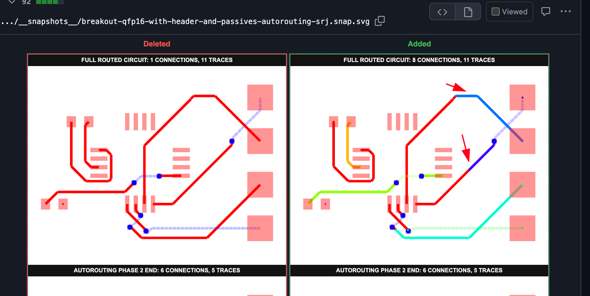

<@757706909351411845> hay I'm heading to bed let me know if this is what you meant if not would love some comments to help https://github.com/tscircuit/core/pull/2512
taking a look
this is interesting, i wonder if we should color traces based on global connectivity net key- i don't think it's wrong but it's interesting- maybe helpful
this looks pretty good so far, i just wonder if we should have a new render phase to make it more clear what's happening
you have a lot of db insertions that are "uncontrolled" like they don't have a class
that's generally not good- it means that it's hard to control the lifecycle of that db element, the group has to manage the lifecycle
i'm doing some experiments but tacit approval
i would MAYBE consider taking one of these snapshots that changed and making sure DRC isn't dramatically different haha- our DRC is a hero if it's not breaking with this new configuration (good!)
this is what i asked codex: ``` i'd like you to refactor this PR https://github.com/tscircuit/core/pull/2512/files, i think that it's not a good idea for the Group class to essentially be doing insertions into the db for source_net and source_trace, it would be better to introduce a new renderphase called ConnectExposedSubcircuitNets that creates classes that can manage that in the "regular" render process. ```
