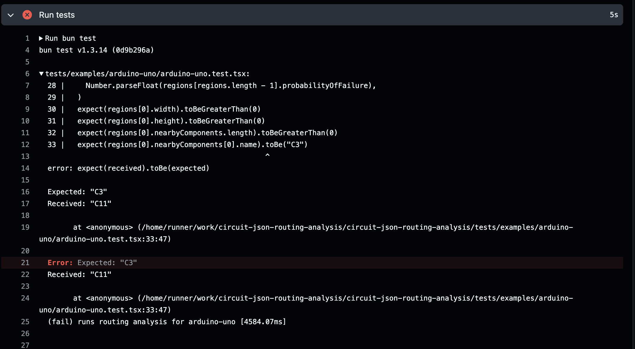

https://github.com/tscircuit/circuit-json-routing-analysis/actions/runs/28143723886/job/83346245869?pr=3
https://github.com/tscircuit/circuit-json-routing-analysis/pull/3

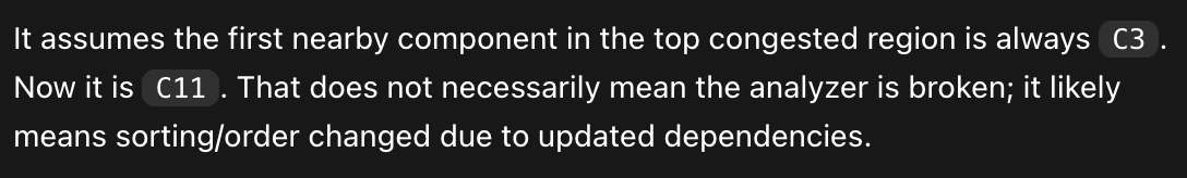

can i update the assertion ?
you can

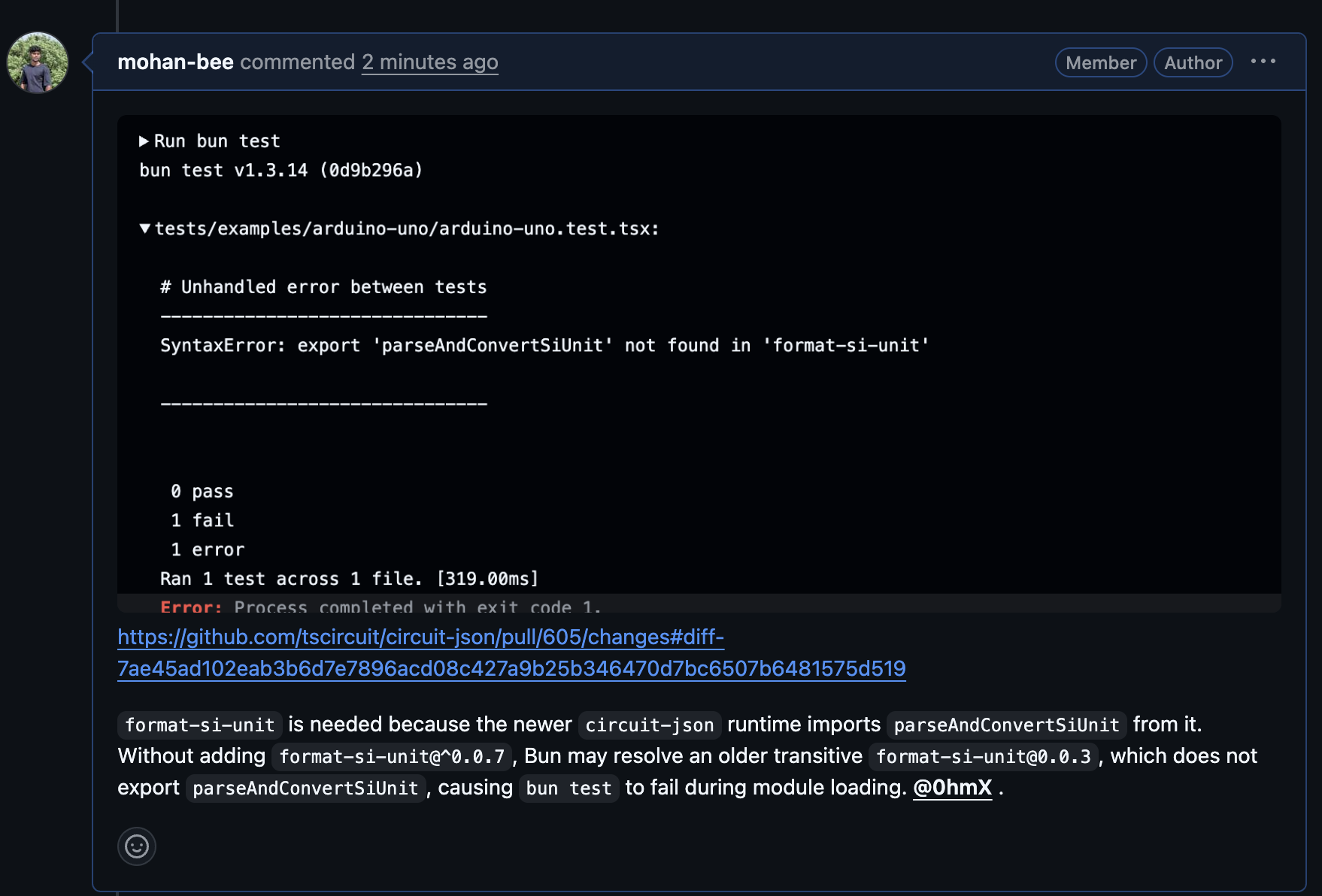

<@400684445054795796> I added `format-si-unit` because the newer `circuit-json` package now needs it. Before, `circuit-json` had its own unit parsing code. In the newer version, that code was moved to `format-si-unit`, so `circuit-json` now imports `parseAndConvertSiUnit` from there. take a look at this : https://github.com/tscircuit/circuit-json-routing-analysis/pull/3
