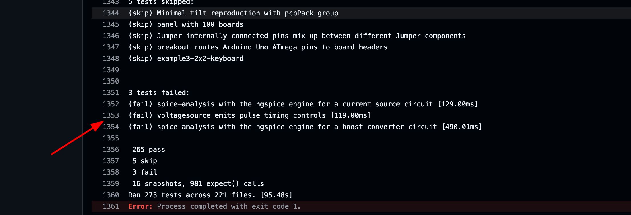

<@778624824875941908> Why are these tests failing?
they passed in my PR so I'm not sure

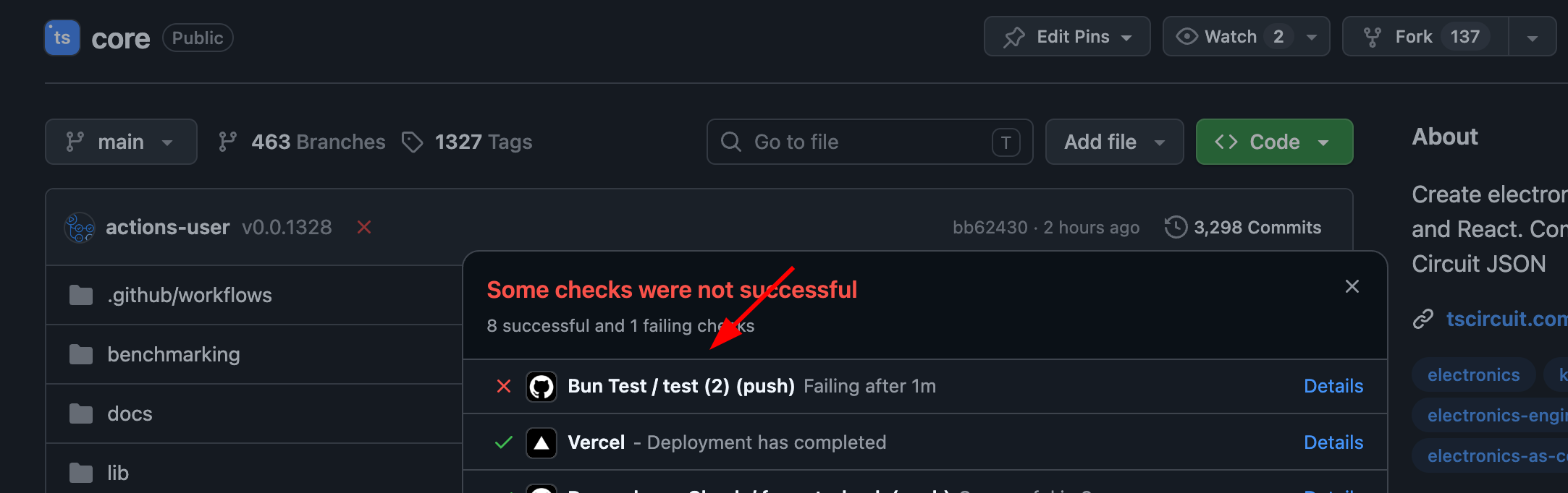

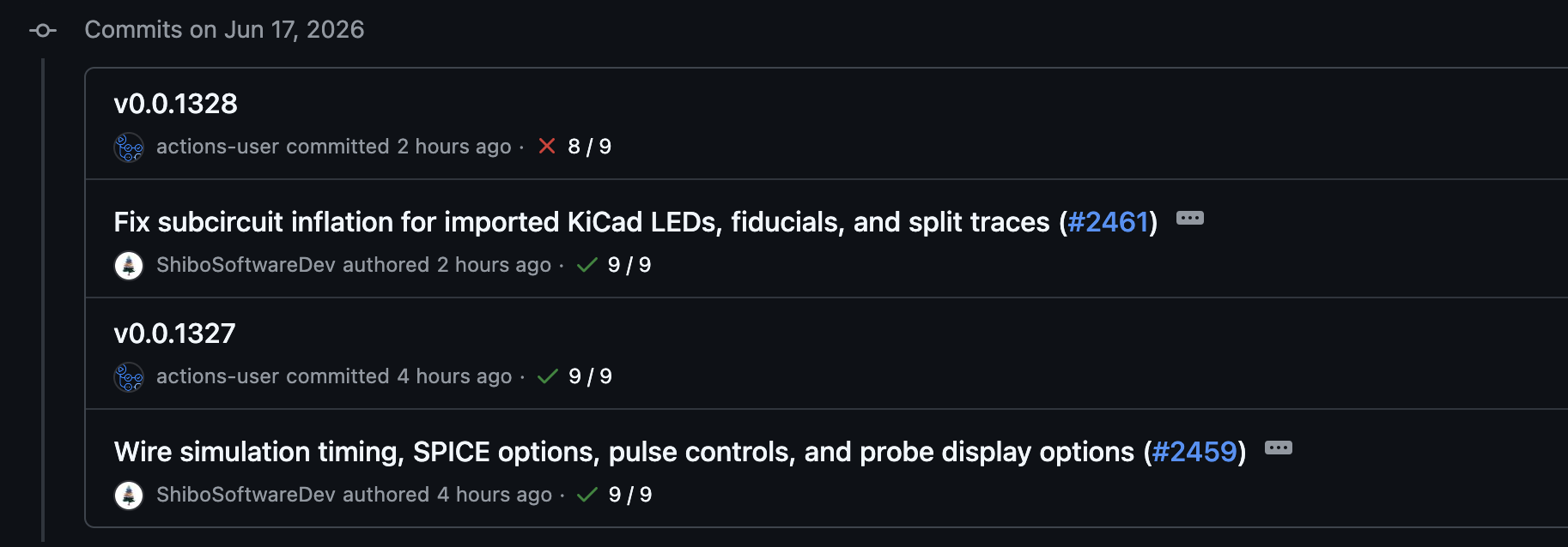

All the core PR's are failing these tests, even though the changes are unrelated

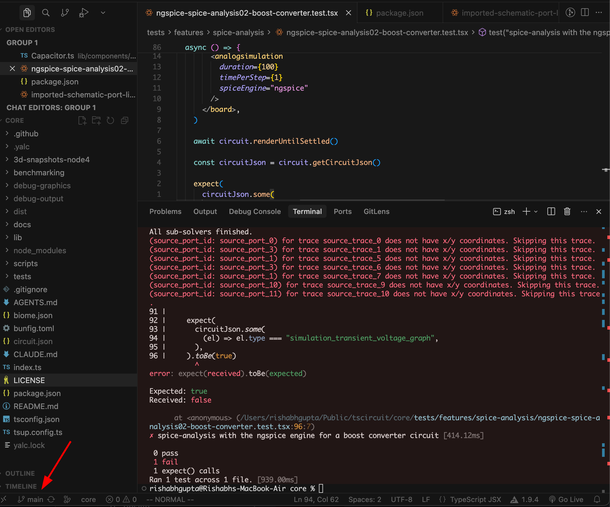

it started failing randomly:
It's failing for me locally too, can you look into this
for me it's passing locally
after I deleted and reinstalled the node_modules it fails

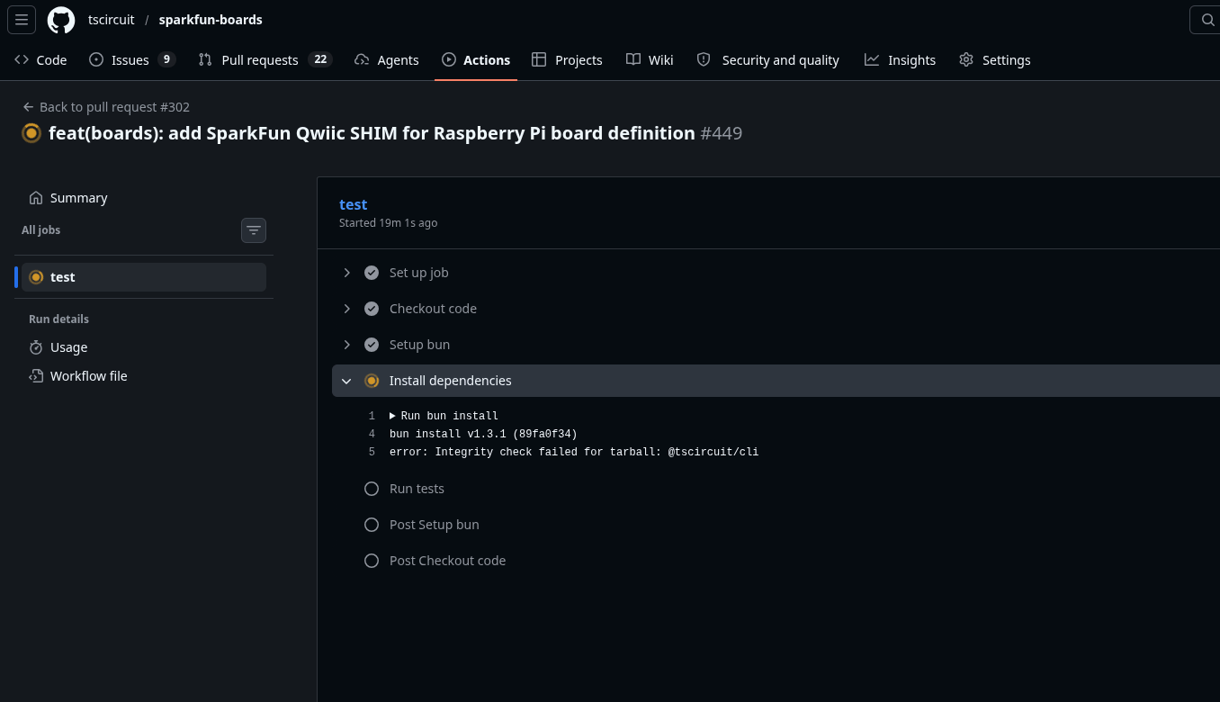

error: Integrity check failed for tarball: @tscircuit/cli
tarball related issue
https://github.com/tscircuit/sparkfun-boards/actions/runs/27715752490/job/81988115100?pr=302
