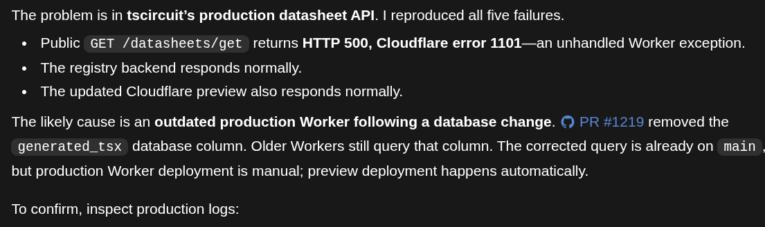

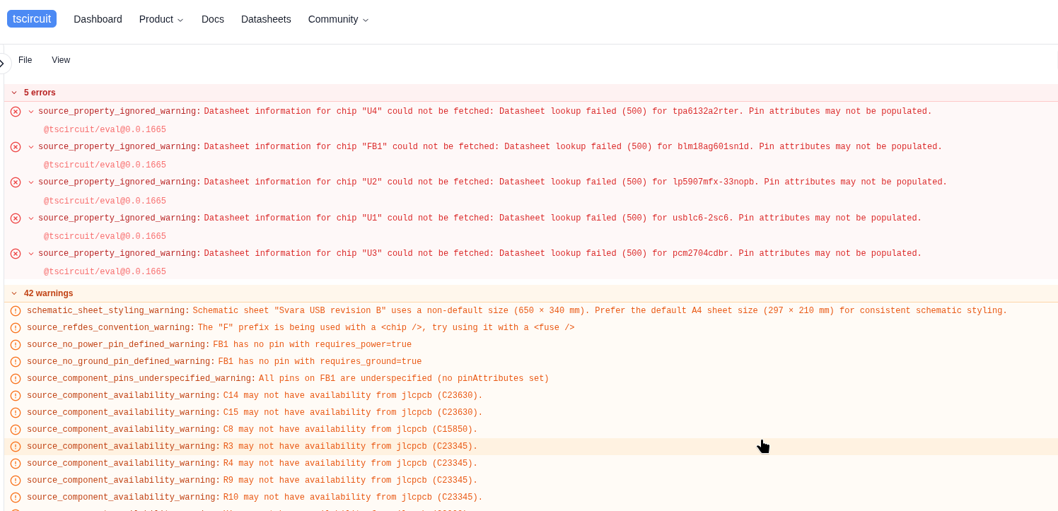

https://github.com/tscircuit/api.tscircuit.com/pull/1219
https://tscircuit.com/rushabhcodes/usb-audio-dac#files
<@398467566588264449>
<@809856037376491570>
I don't think my PR is the reason for that error, cause we are not storing that column but we still do generate the `generated_tsx` on the fly and the response has that
