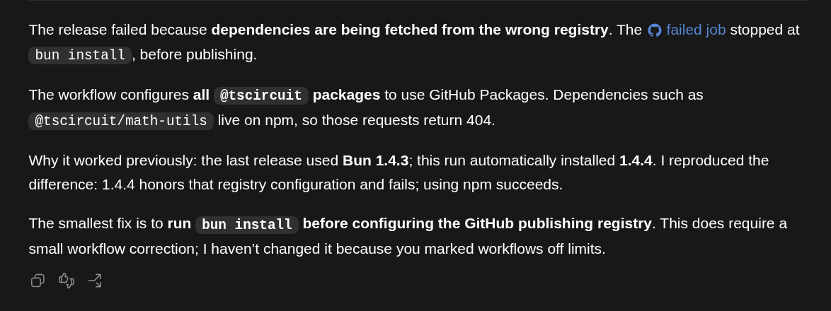

https://github.com/tscircuit/circuit-json-webgpu/actions/runs/39880923880/job/120177831212 <@809856037376491570>
You can switcg to jscdn
We reserve github packages through the jscdn
And it doesnt require auth
[PR #76 — Fix dependency installation in the publish workflow](https://github.com/tscircuit/circuit-json-webgpu/pull/76)
The v0.0.10 URL https://jscdn.tscircuit.com/@tscircuit/circuit-json-webgpu/0.0.10.tgz currently returns 404 because publishing failed during dependency installation.
merged
