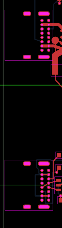

I have not seen this kind of footprint used for usb-c, can you double check if it's right

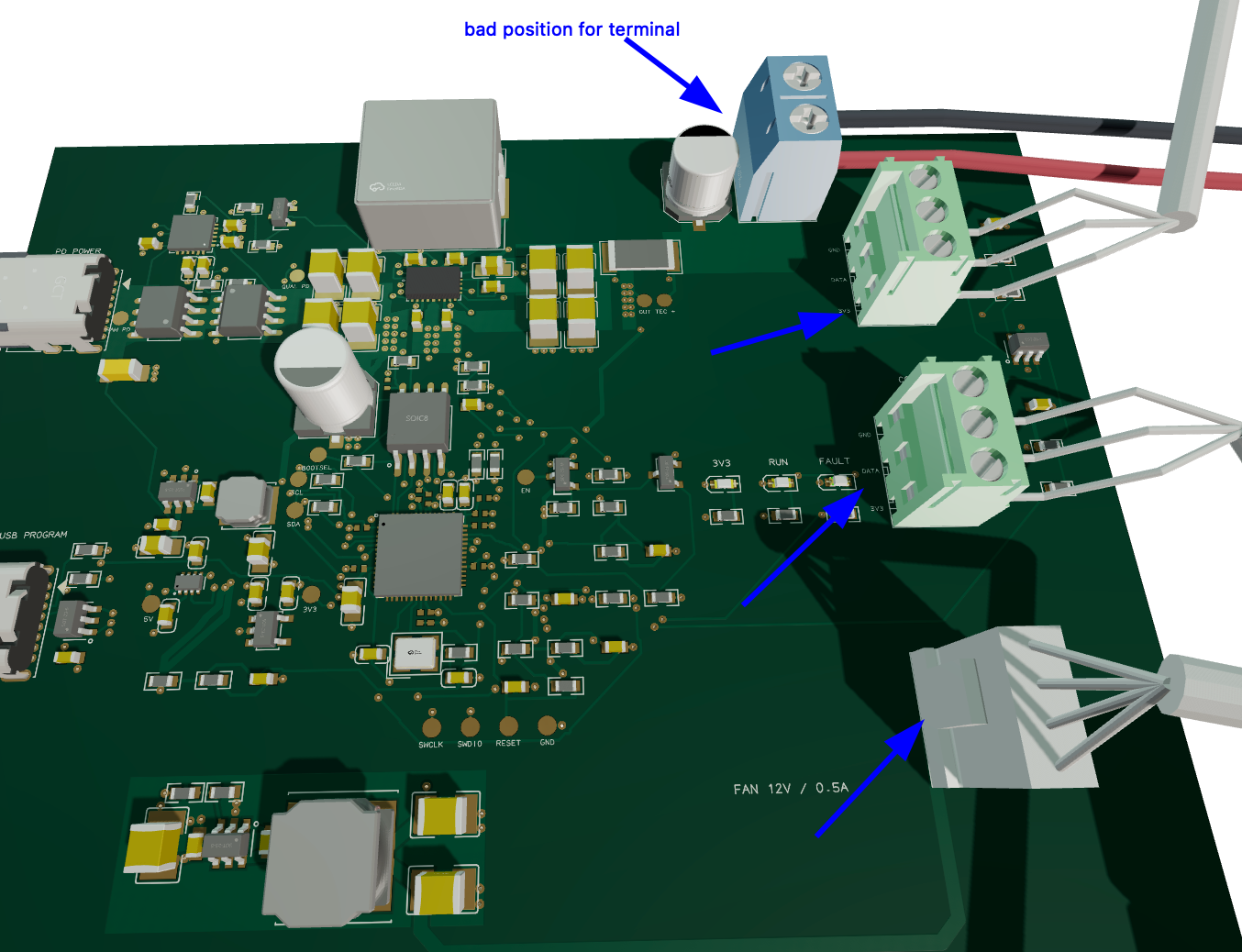

Move the terminals to the edge

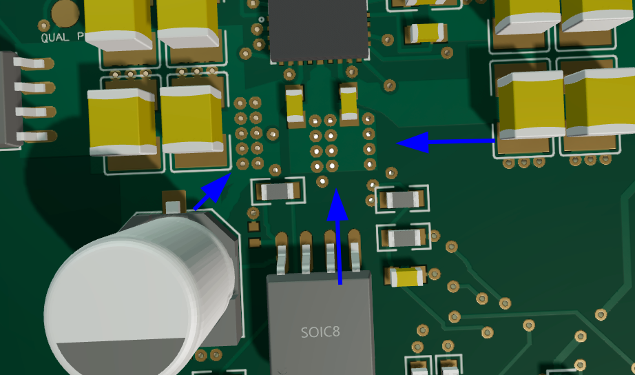

What are these holes for?
i think that is for power via stitching
the issues are fixed
