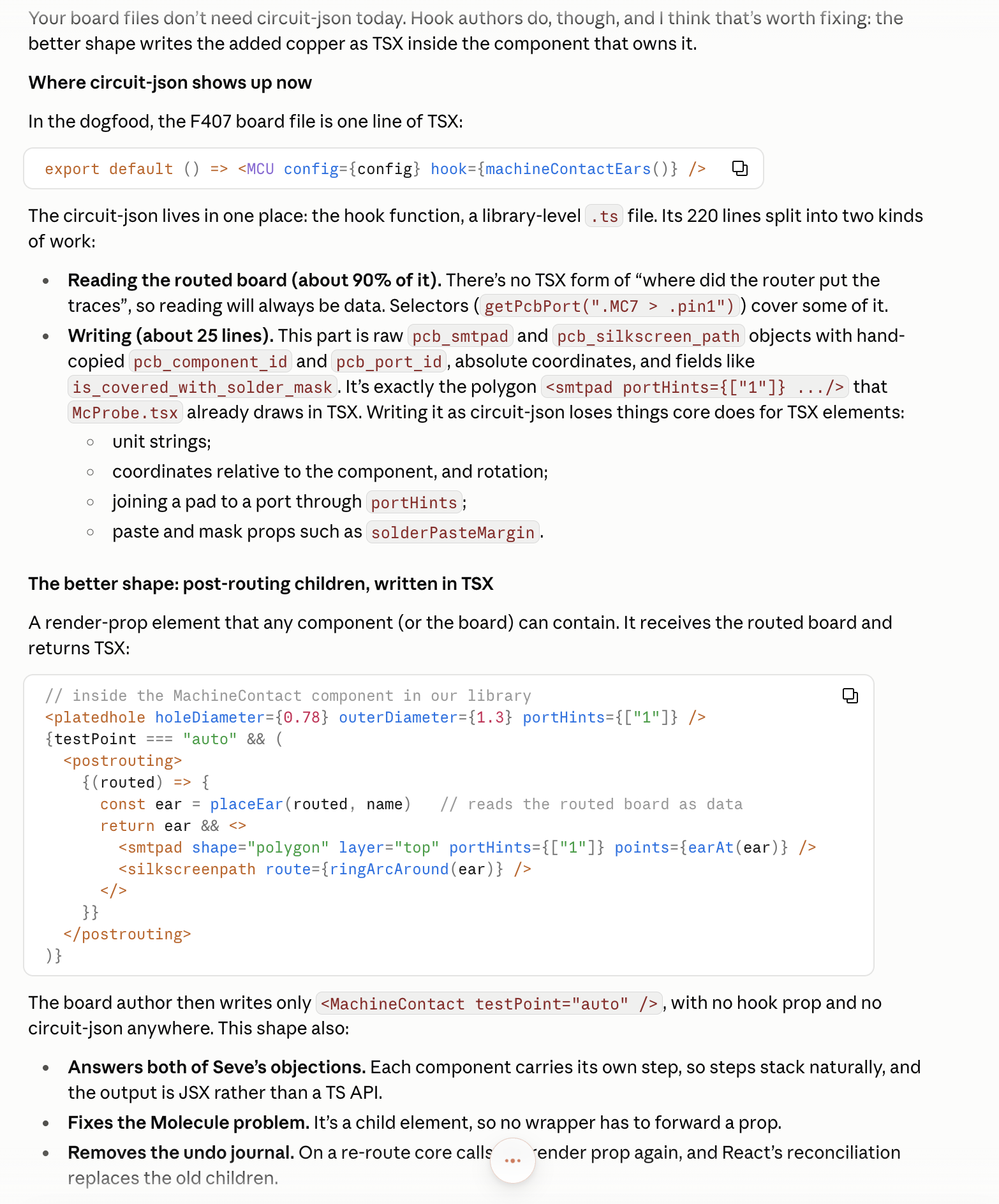

I tried it. autoroutingphase + algorithmFn on core main can't cover this:
- a phase only runs when it has connections, reroute+region/connection, or pcbTracePaths. A trailing "after everything" phase with just algorithmFn never gets called
- with reroute+region it re-routes: it cuts traces at the region edge and hands the solver the pieces, with obstacles as abstract rects
- the output is SimplifiedPcbTrace[] only. I returned a pcb_smtpad and it was silently dropped, so no test pads, silkscreen, keepouts or custom DRC errors
- returning the existing traces wider left both copies on the board (0.15 and 0.5), so it can't edit the router's traces either
The hook's job is editing circuit-json (insert/update/remove any pcb_* element) after routing and before pours/DRC. That's a different contract from "routing problem in, traces out".

an even better solution that might also address your issues is to actually be able to write tsx that handles post routing hook. I'm dogfooding on my own contacts with ears design now.
it seems like if we adjust how reroute works it could work- reroute should be able to work without a bounded region

i think we may want to use real hooks
i.e. react hooks, that's how this would conventionally work in a react paradigm
basically if you want to adjust based on output and insert new elements, that's actually a pretty normal thing in react
we just don't support conventional hooks right now
but you could do a lot more if we did
