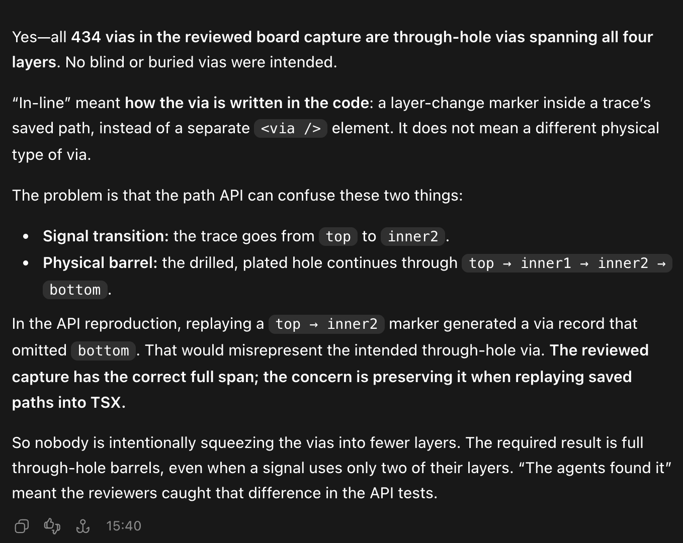

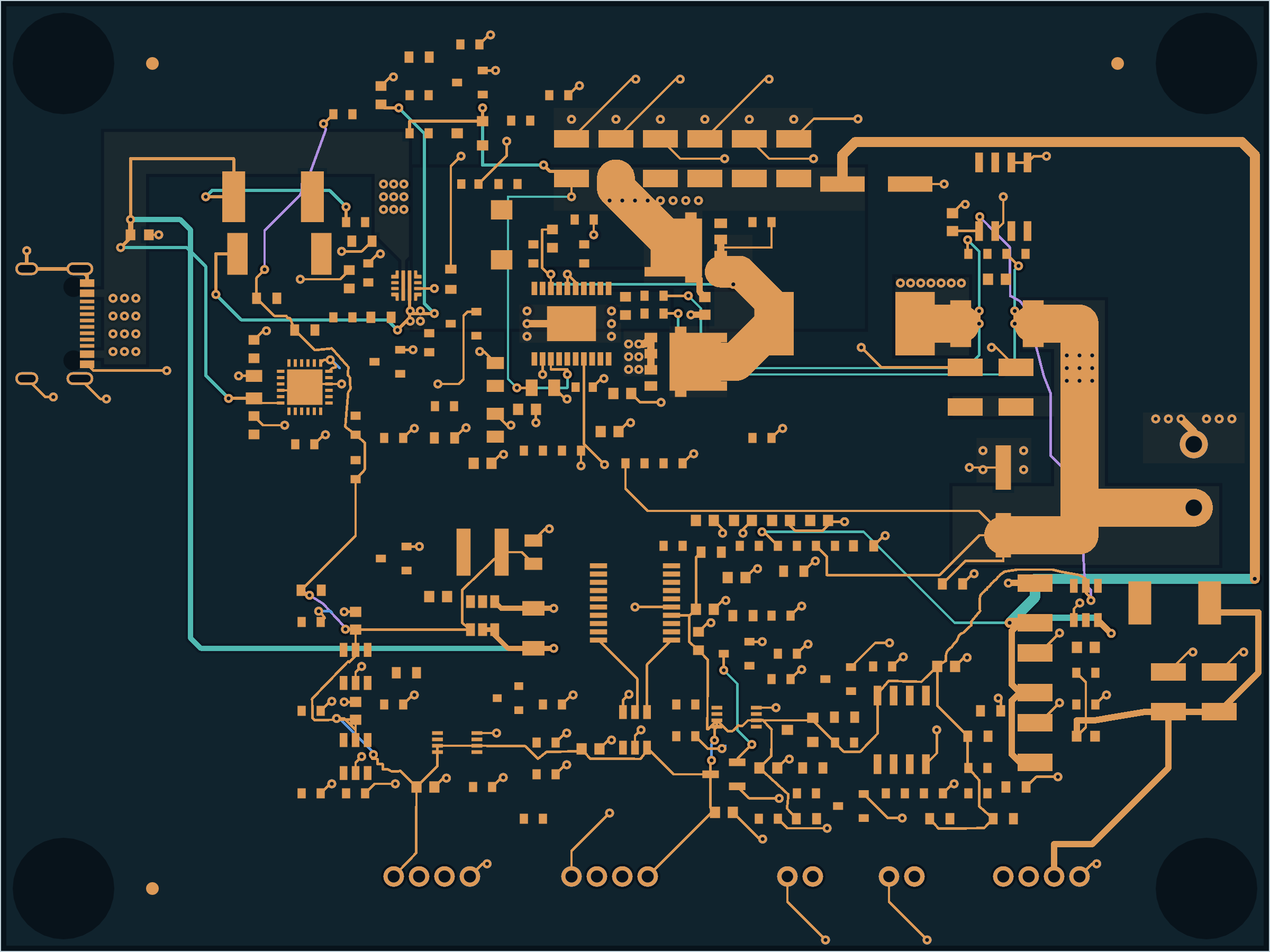

If anyone else wants good routing, set your sub-agent limit to at least 20—the higher, the better—and ask Codex to use 20 or more agents just for routing. Tell it that auto router results aren’t that great and ask it to manually edit the routes. In my experience, this can produce some great routing, but it can take more than 10 hours in some cases. Mine is still going, and I’m not even routing DDR. But i like the route and placement
use sol 6.1 on extra high and still did not burn my weekly limit even with this crazy workflow it has been more than 16hrs of running combined with other works

looks cool but does it pass jlcdfm
will use it once the board is ready
