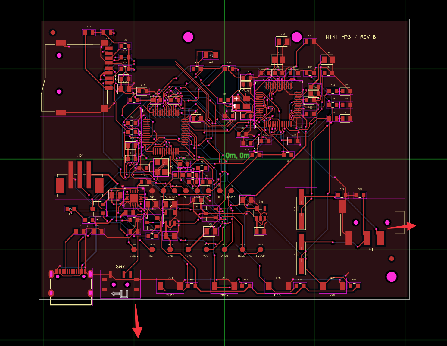

https://tscircuit.com/mohan-bee/mini-mp3-player <@757706909351411845>
Style Analysis issues
also too much empty space in sch view
your pcb is floating, there's no mounting holes to mount it inside the enclosure
maybe for the sd card slot too
eh it might be ok with your little 3d printed thing for power
but i would just expose the power switch hehe
yea that design is bit bad , will redesign
