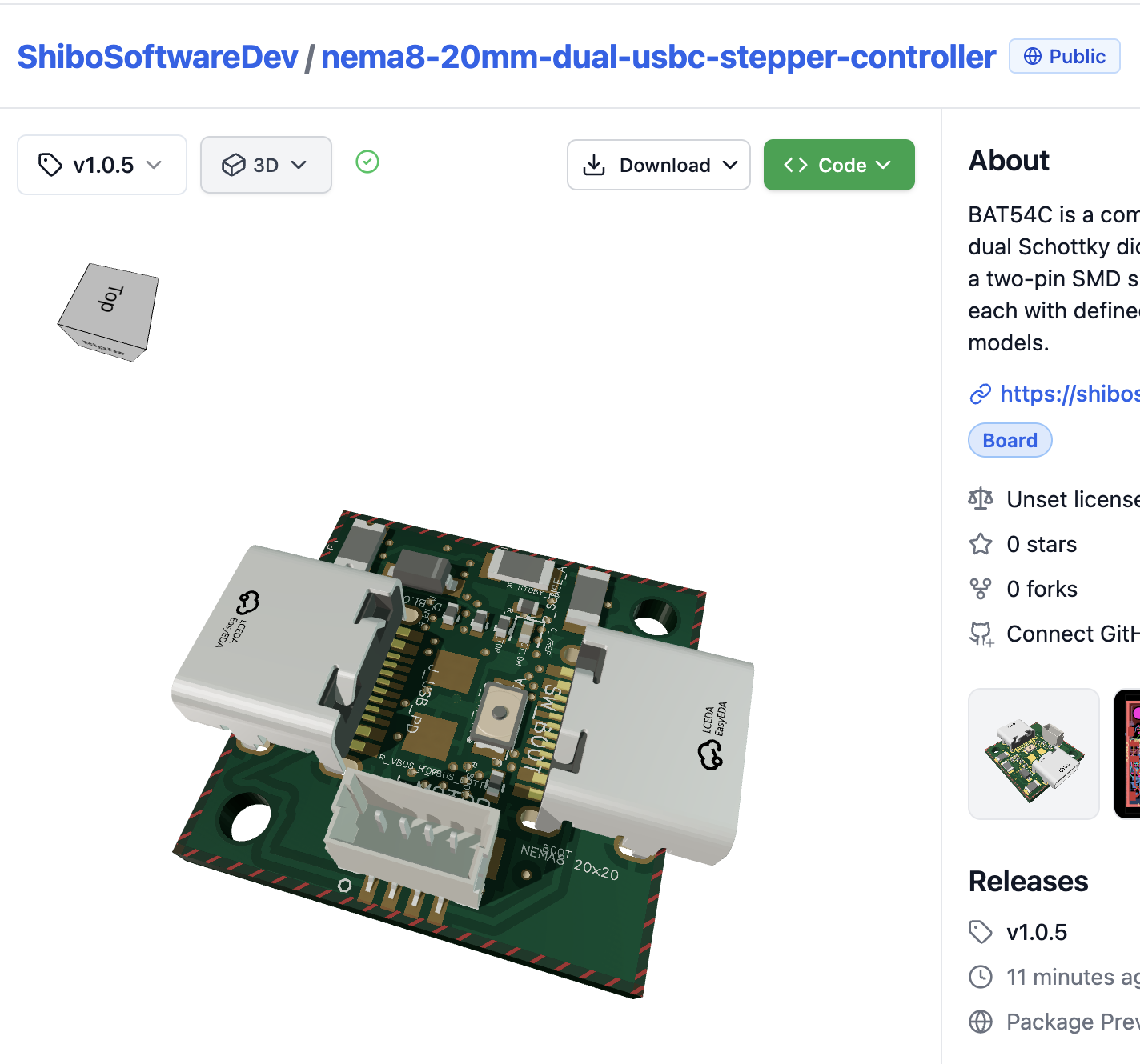

<@809856037376491570> https://tscircuit.com/ShiboSoftwareDev/nema8-20mm-dual-usbc-stepper-controller#3d
make sure the PWR and DATA is clearly marked in silkscreen if possible, also ideally 4 mounting holes
you should really try to get the driver on the top haha
i'll try yeah, just wanting to get an initial review
you can also use an edge-facing JST, might save space not sure
well the board is 6 layers
and it has to be 4
actually it's 8 layers
idk how you didn't see that tbh lol
people aren't doing self review haha
I didn't know we had a 4 layer limit
upload it to jlc and check the cost
if the cost is ok maybe we can do 8 layer but it's probably not
yeah 8 layers is 90 dollars extra off the bat, pre tax and all
that is a bit high
i think you might be able to find a usb-c connector that uses less space
one type of connector that uses a lot less space is a vertically mounted connector, they are less secure though, probably not the right fit for this
ideally usb-c ports on same side
how you secure a vertically mounted connector is you make an enclosure that can help hold them. So it is possible to use a vertical usb-c connector for this, the enclosure isn't that hard to design
i'll make this my last option
