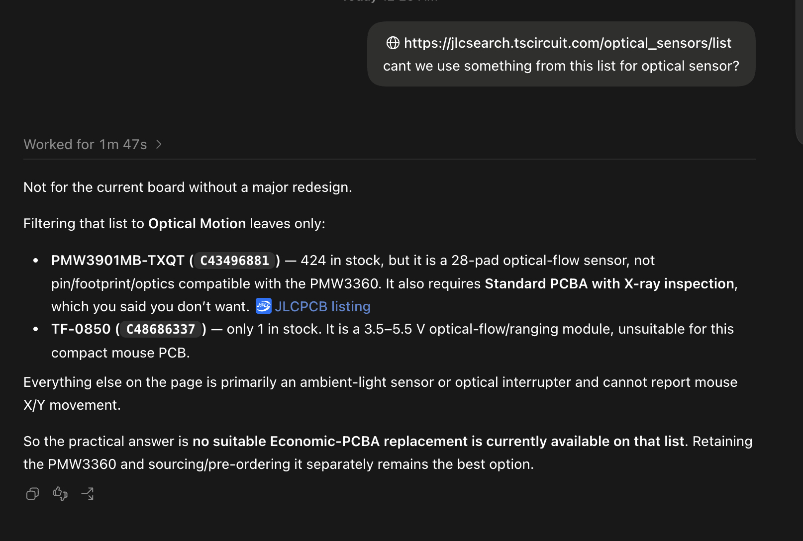

trying to open an "Optical Sensors" category to jlcsearch https://github.com/tscircuit/jlcsearch/pull/603
guys please only post screenshots of AI with a comment- we are going to crack down on fake engineering

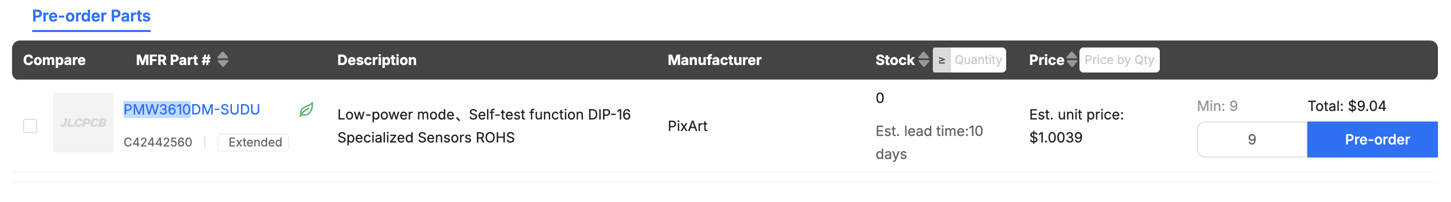

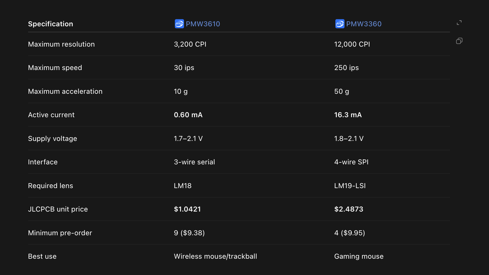

the one you're using is a lot better but more than twice the price, the cheaper PMW3610 could work if the mouse you're making is not a high performance gaming mouse
ik, we're deciding on which to preorder so we all use the same sensor
do you need the better more expensive one? or is the cheap version good for you?
Yea works
<@757706909351411845> I guess it would be the cheaper PMW3610 then, it costs around 1 dollar when the other costs around 2.5 dollars
<@778624824875941908> what should we do?
i'm ok either way, if the cheaper PMW3610 works for you then pre order it
yea PMW3610 works but ill have to redesign the board to use this sensor instead. I think it'll work. <@757706909351411845> Should we preorder? I never pre ordered, whats the process and how many should we order?
PMW3610 is $1.0039 and the one my board uses is $2.4873
