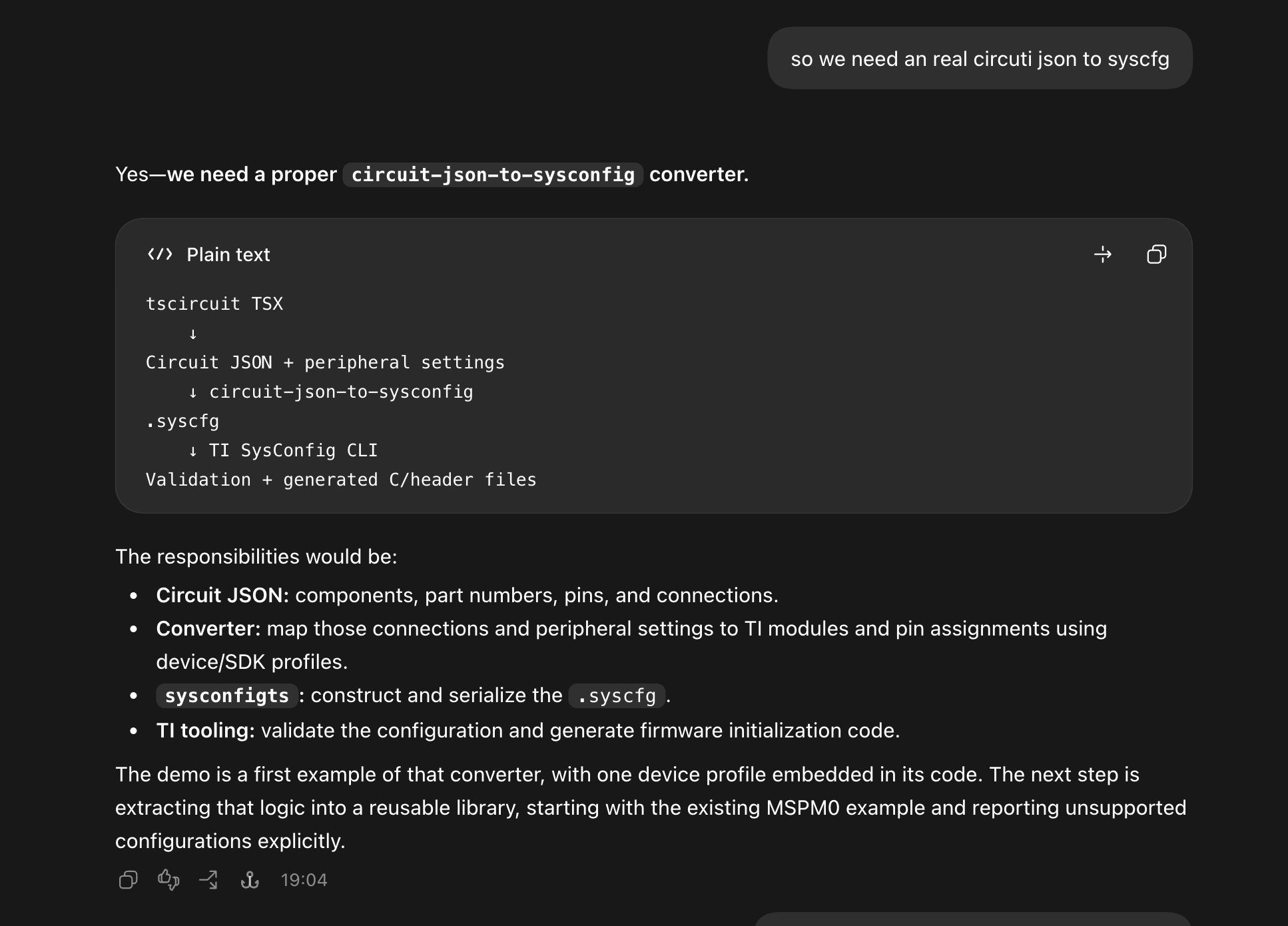

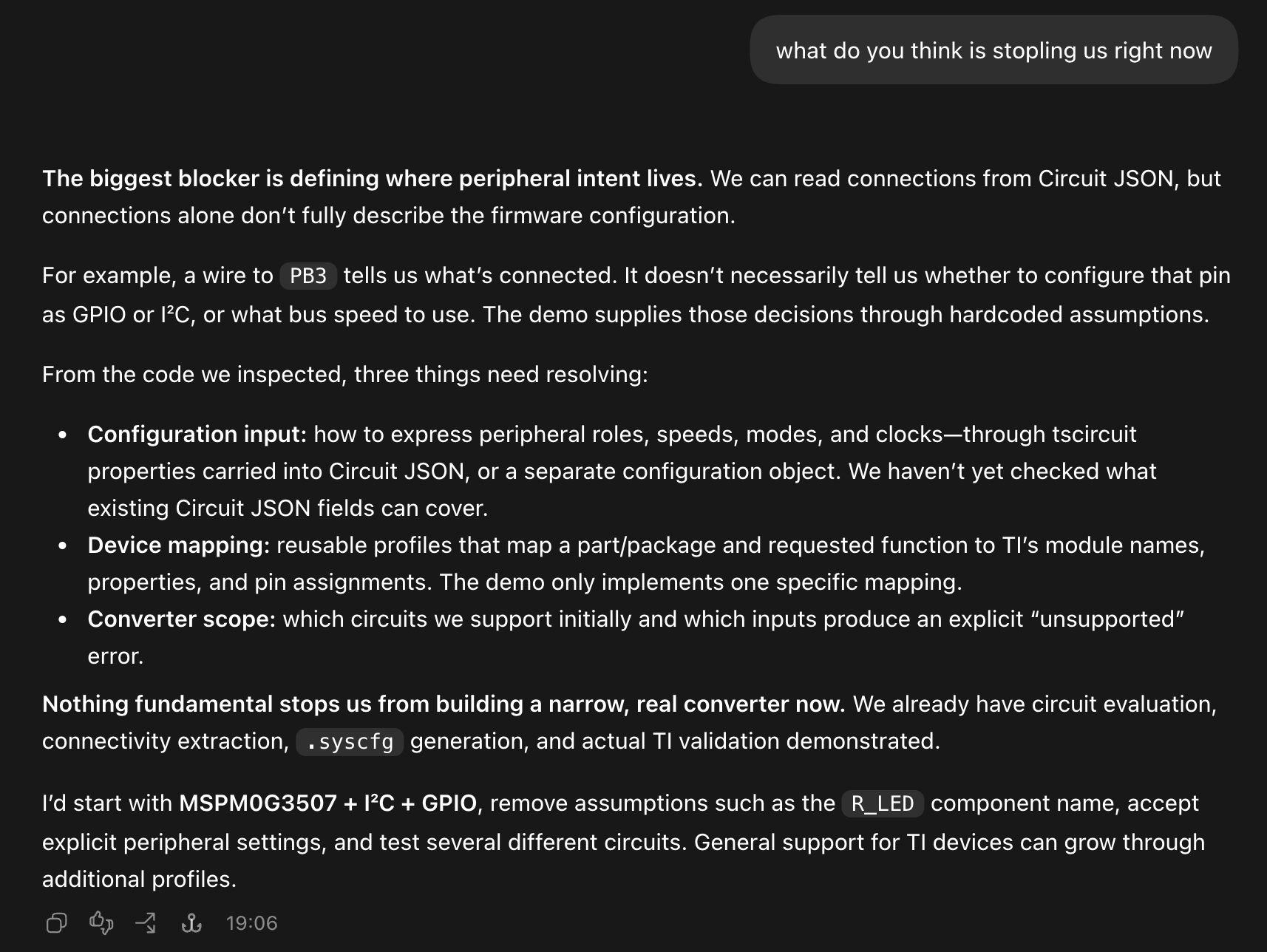

was trying to make circuit json to sys config
Started by 0hmxSep 24, 20267 messages
jsyk, we always get the parser library (which is prohibited from working with circuit json) pretty solid before doing the circuit json conversion
this is critical, projects that do this wrong end up creating months of tech debt
you can also chat with <@809856037376491570> if you're curious about how we build these libraries
but it is possible, there is no limitation, we haven't even started generating/parsing sysconfig files yet 😁
when sysconfigts is near completion we start working on circuit-json-to-sysconfig
that's how that works
