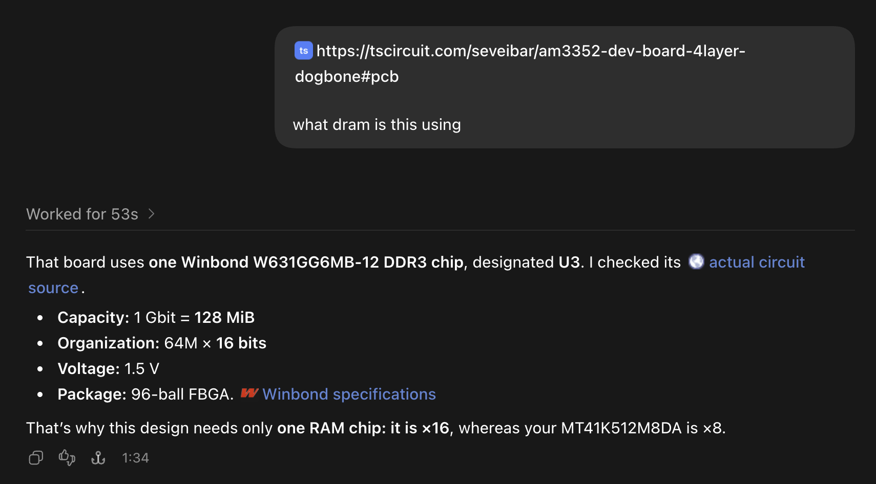

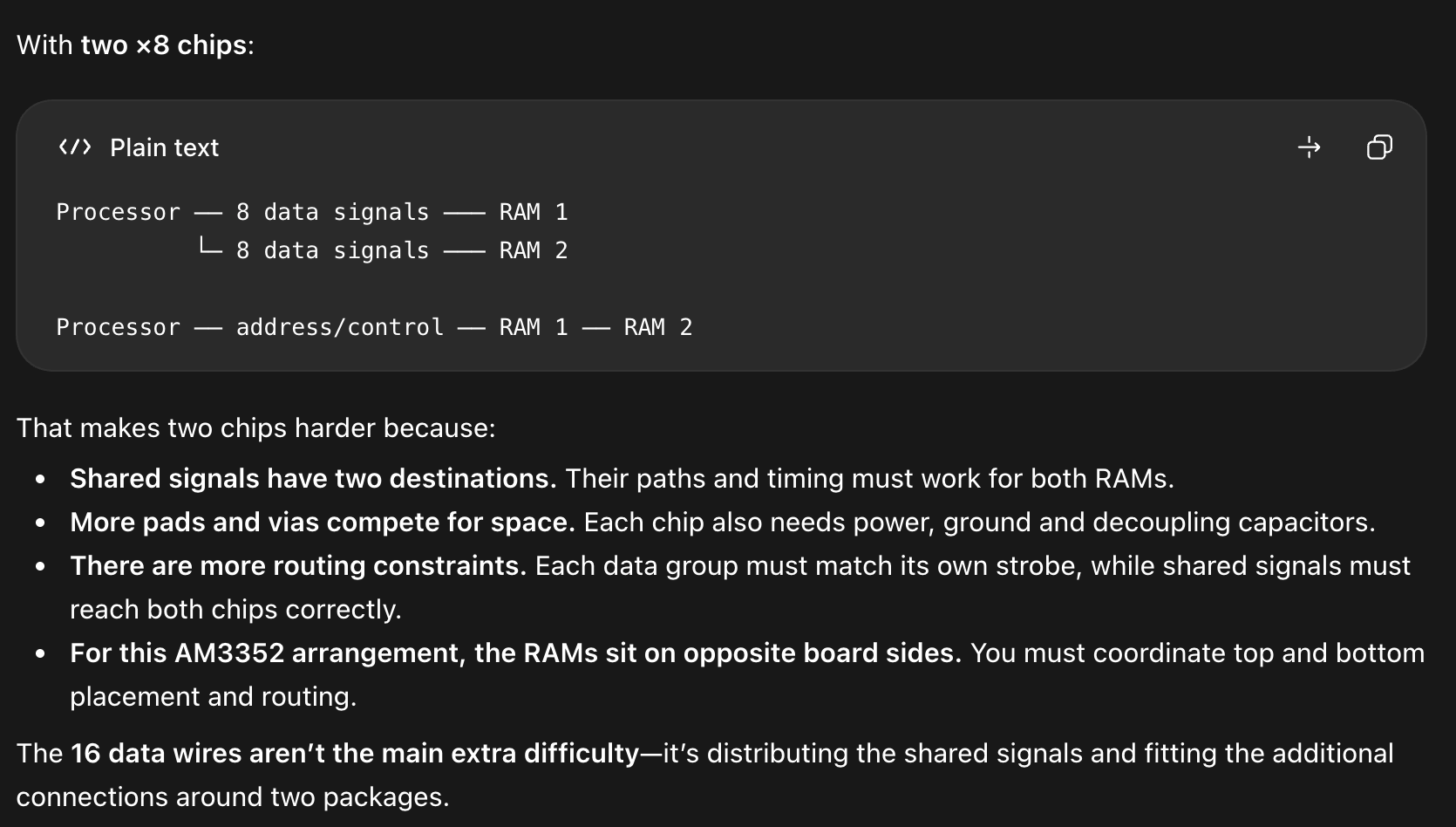

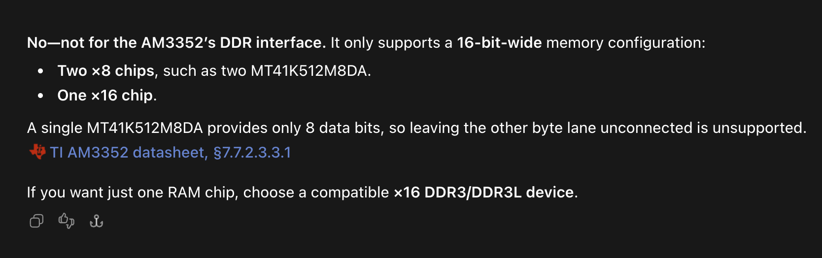

you have to have 2 dram chips if you are using MT41K512M8DA
Started by 0hmxSep 23, 20264 messages
<@757706909351411845> your board is good its using 16x
