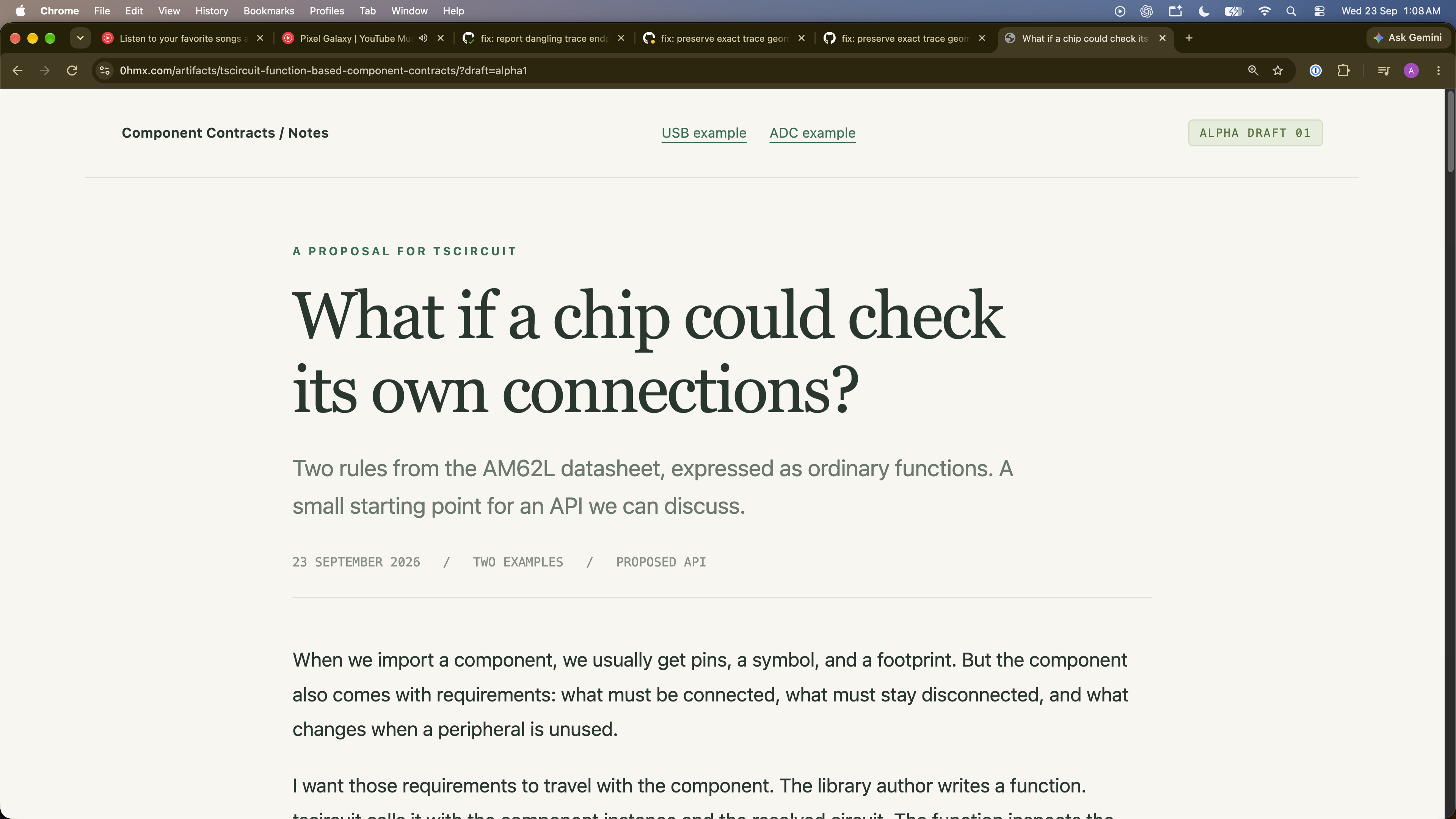

https://0hmx.com/artifacts/tscircuit function based component contracts/?draft=alpha1 is this what providers want when they what to convert datasheet rules into actual rules?

https://0hmx.com/artifacts/tscircuit-function-based-component-contracts/?draft=alpha1 is this what providers want when they what to convert datasheet rules into actual rules?
yes, but.... i can say with some confidence that it's a bad idea to introduce a DSL, working within TSX is the only way that things won't get out of hand with training data etc. so you want to create the schema to represent 99% of the checks that manufacturers have. We don't want people defining custom functions often, and when they do, we want it to be in such a way that implementations can't differ greatly It's tempting to introduce a DSL-function system but it would be self-sabotage. TSX is the way to go It is actually not smarter to create generic systems- this is a trap that our competitors fall into. It is far, far harder to design an API with great terms that represent the manufacturer's intent. e.g. `<pinrequirement requirementType="requiresEnablePin" pinRef="U1.ADC1" enablePinRef="U1.EN_ADC1" />` Of course generic checks should be possible in userland. But there are far more variants of the function-DSL representation than the TSX representation

> e.g. <pinrequirement requirementType="requiresEnablePin" pinRef="U1.ADC1" enablePinRef="U1.EN_ADC1" /> I think I get the idea! But chip-level DRC could be difficult, especially for cases like the example in the blog. It could also extend the existing `<drccheck />` tag. I didn’t know we already had this tag; otherwise, I probably would have designed the API differently. but do you think the 2 example that we picked is a real case to handel?
The big idea I have in mind is to convert these datasheet rules into component-level DRCs. Since tscircuit is so easy to share, I think this could become something really unique to us.
