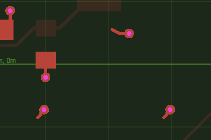

<@400684445054795796> https://tscircuit.com/seveibar/am3352-dev-board-4layer-dogbone#pcb
dangling dangling
are they connected to pours?
that's interesting
we should detect dangling w/o pours ig
i also think the x-ray feature might not handle pours properly
