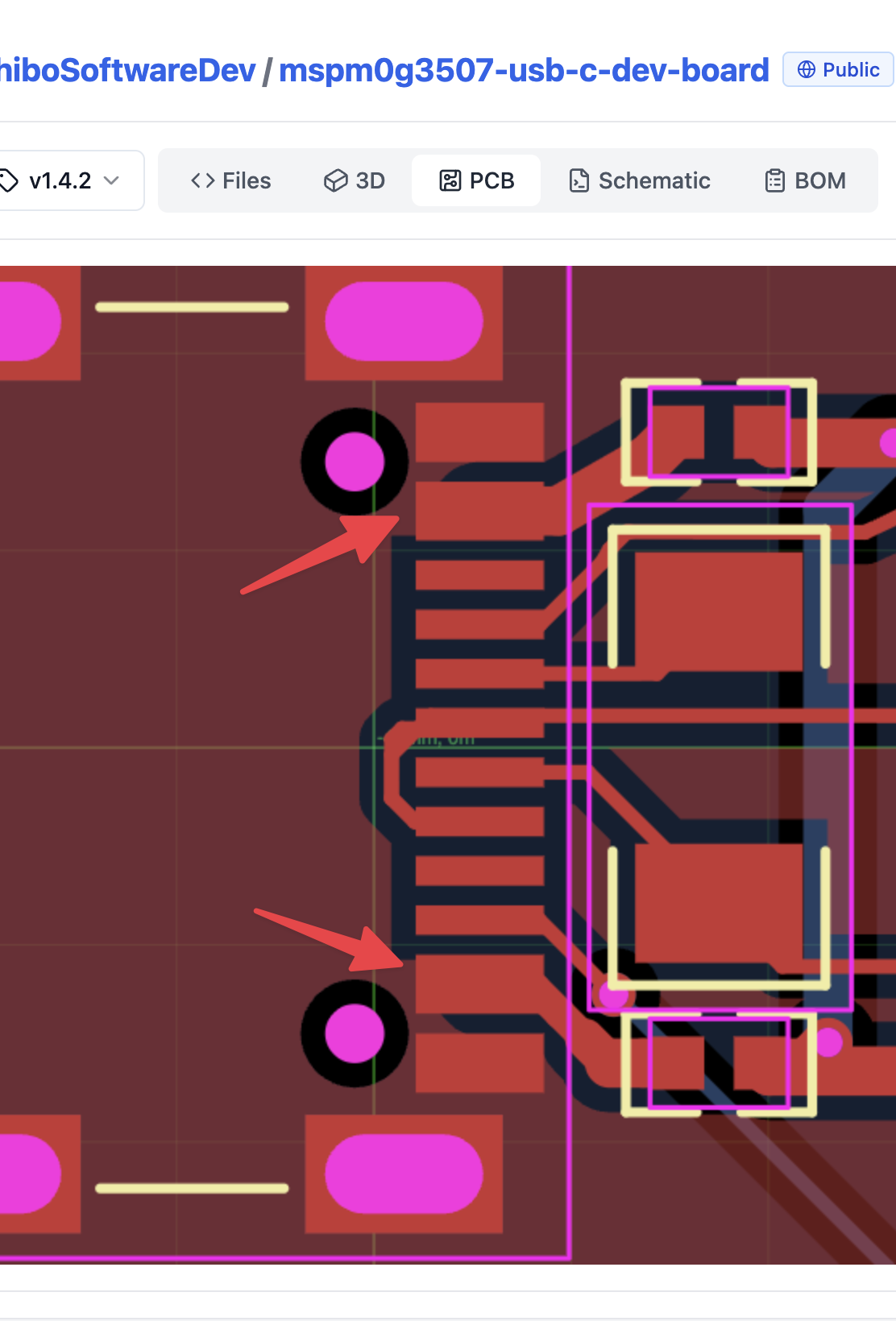

Seve - @shibo did you check your board with "ts...
mention did you check your board with "tsci check shorts"? I'm 90% sure you have a copper pour short between power and GND
Started by SeveSep 16, 202613 messages
<@778624824875941908> did you check your board with "tsci check shorts"? I'm 90% sure you have a copper pour short between power and GND
i always run tsci check shorts, I'll double check, maybe it's a bug
it passed tsci check shorts, i'm now investigating why

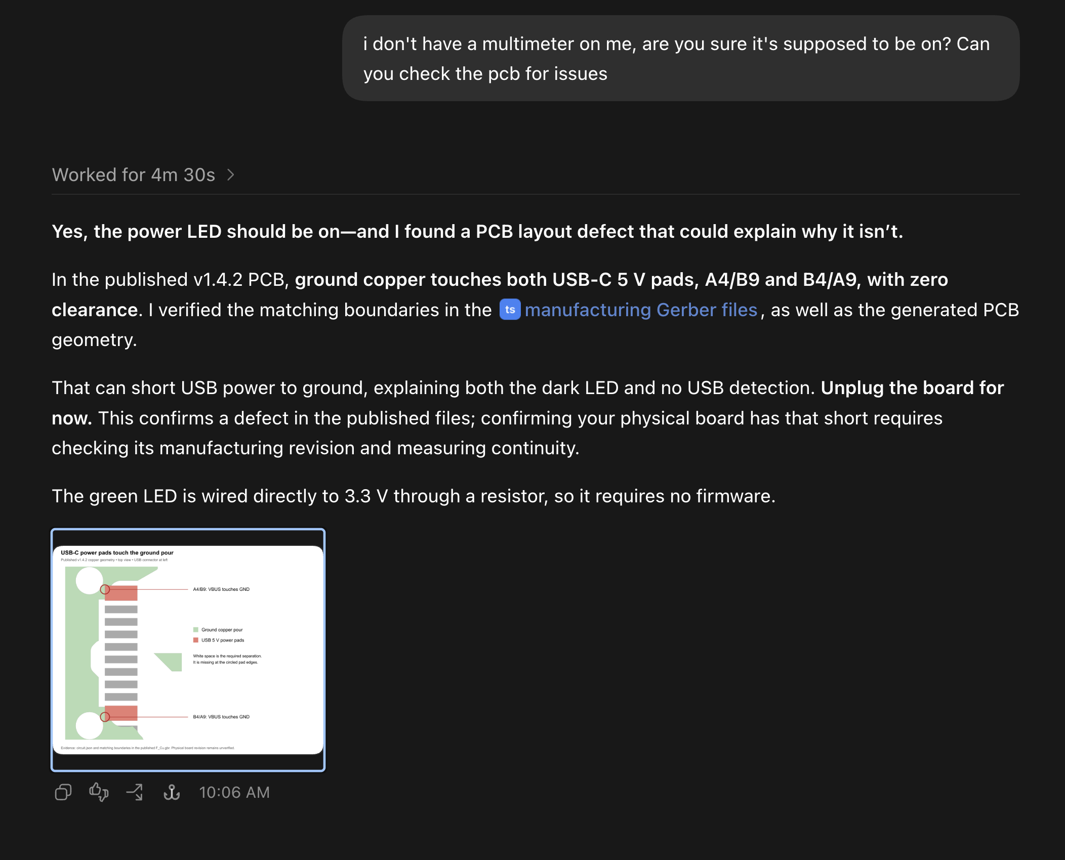

when i plug it in the power led doesn't go on

Unfortunately shorted due to an old bug that is now fixed, make sure youre running latest ray!!!
