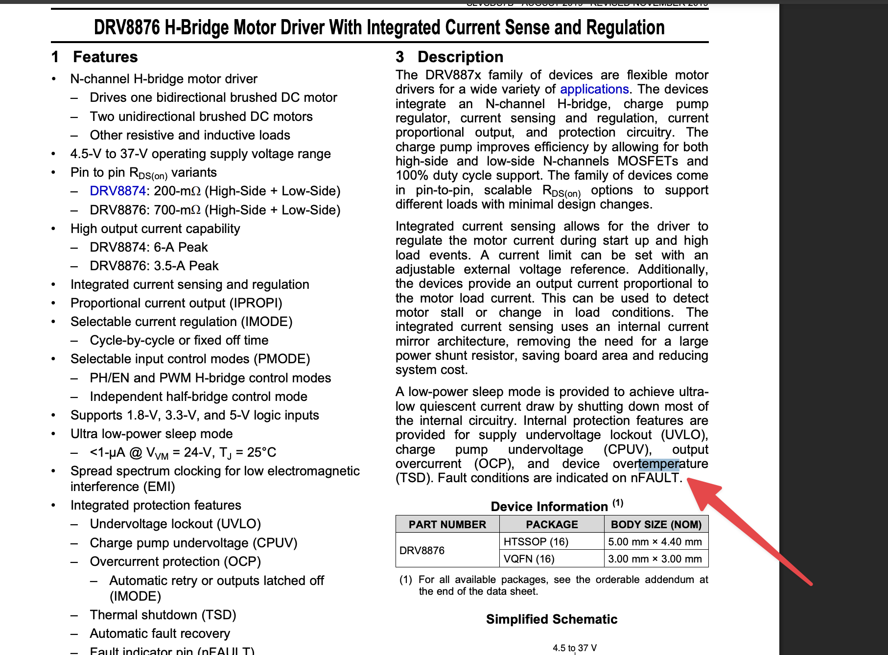

i still like having the temperature sensor i think
i don't think it emits temperature, it just has some protection for it but we know that doesn't save it from experience
