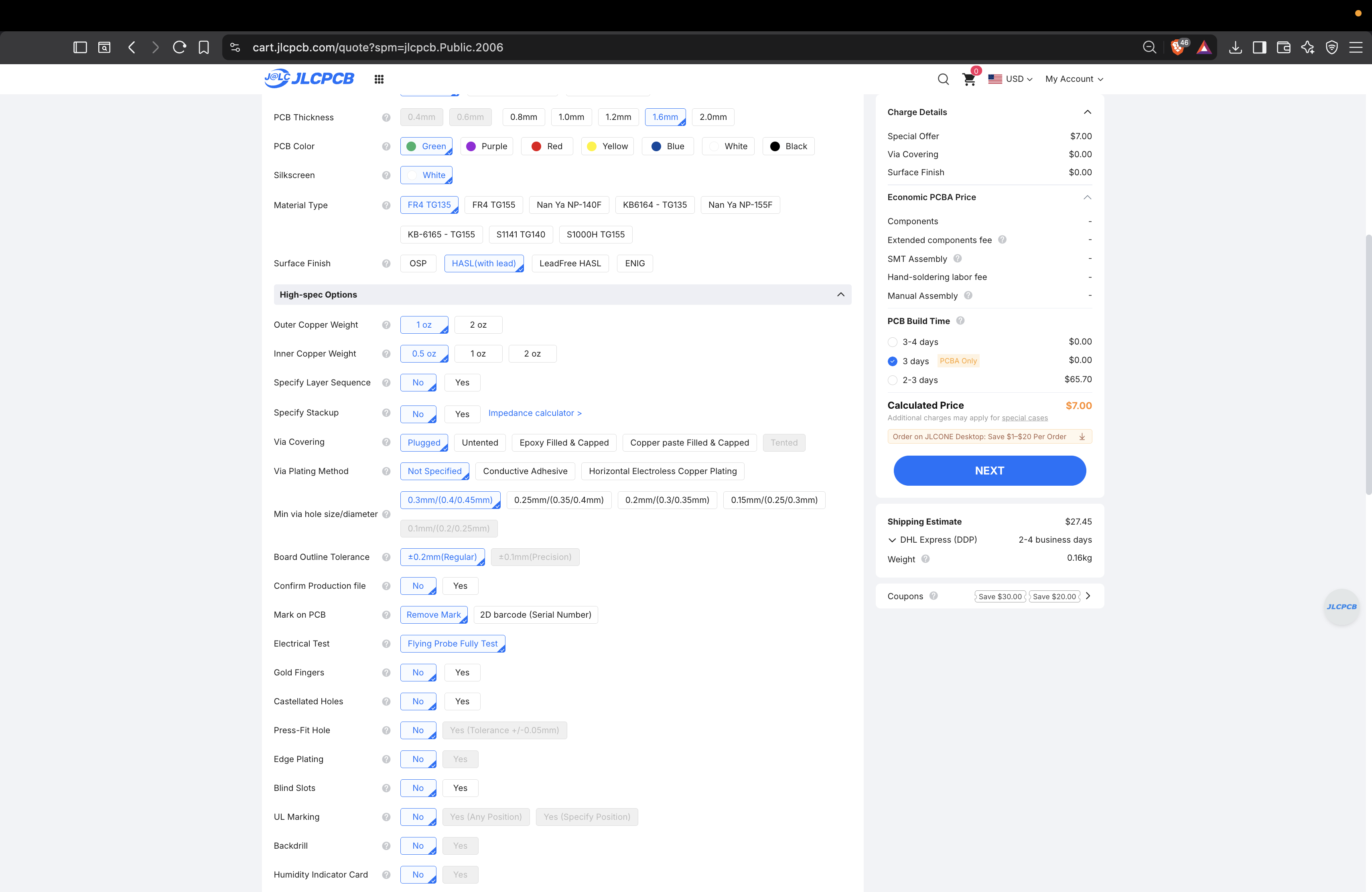

click OSP maybe
because it doesn't have lead which is nice

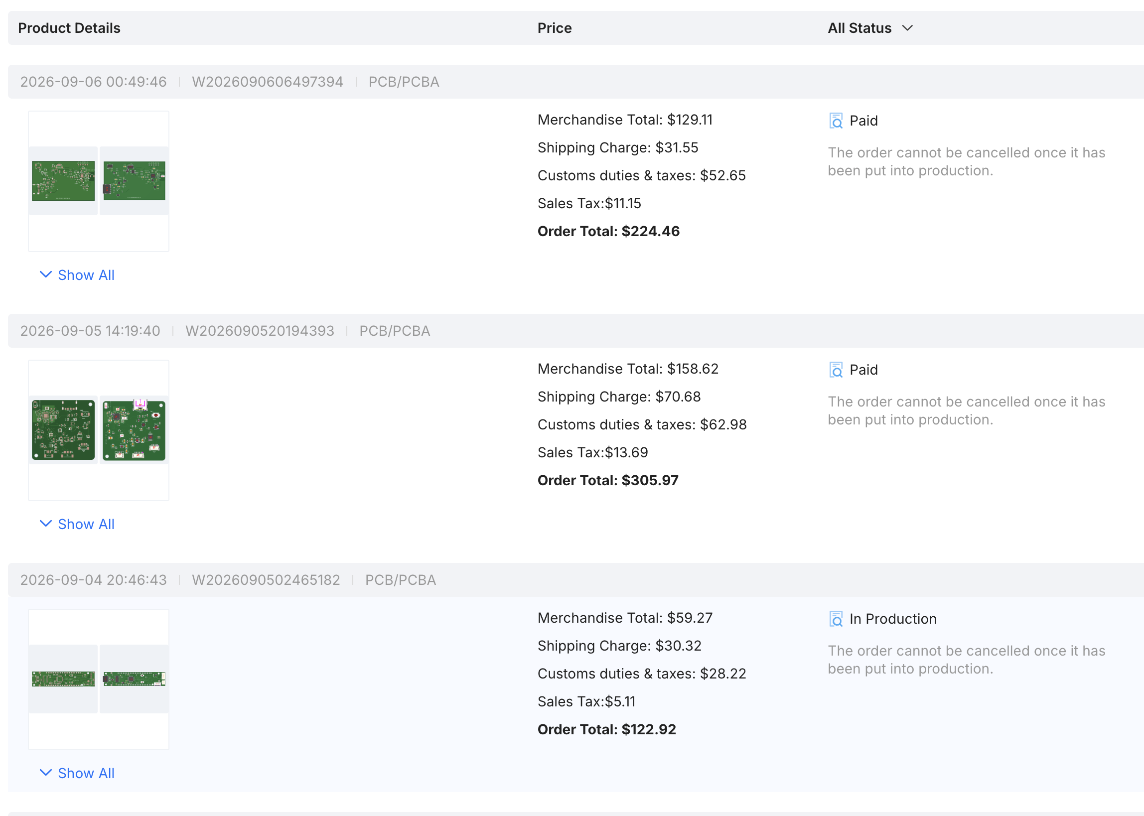

what was the price?
yea i did figure you would show the full price not the fake price before ordering 😁

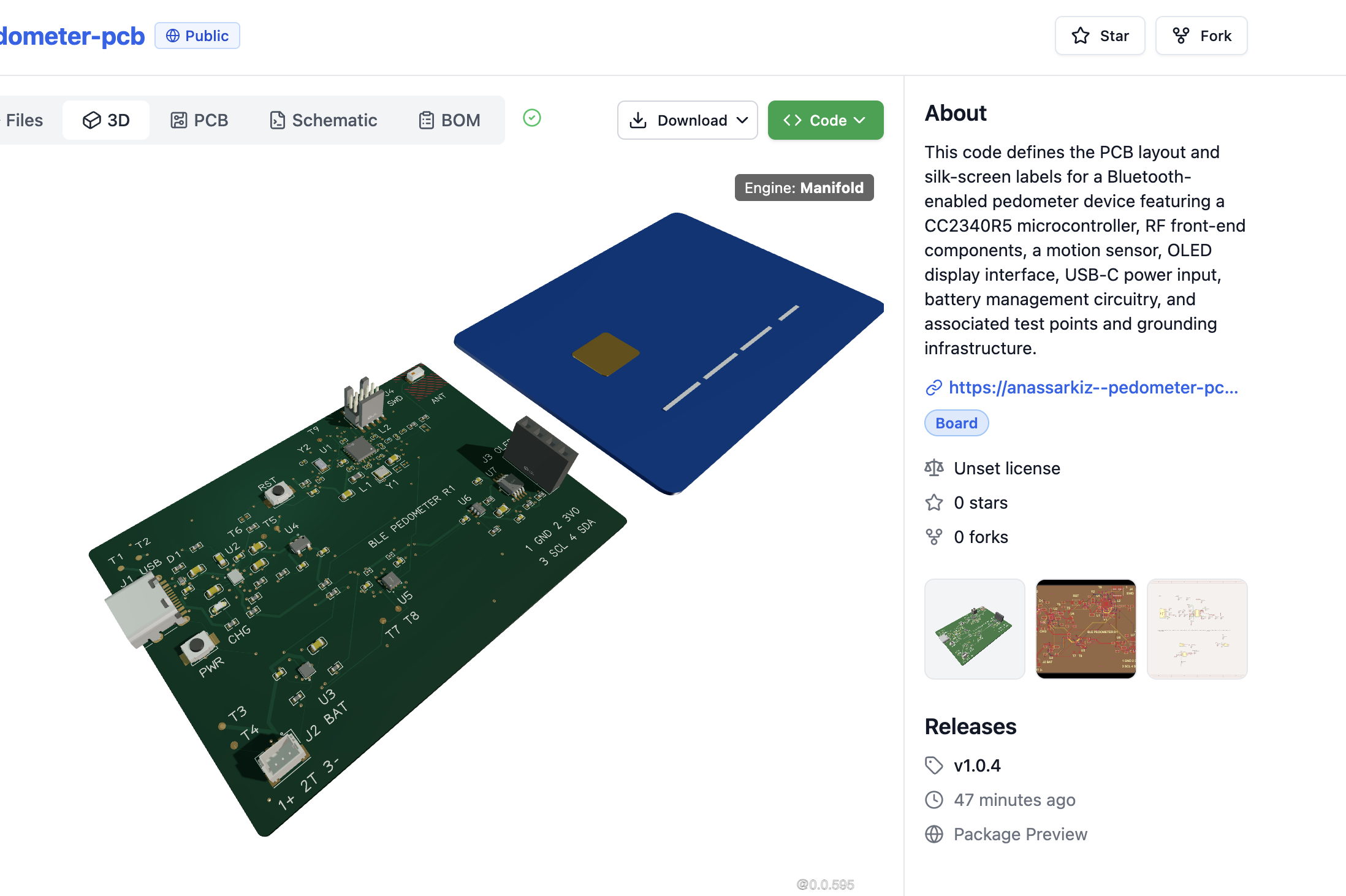

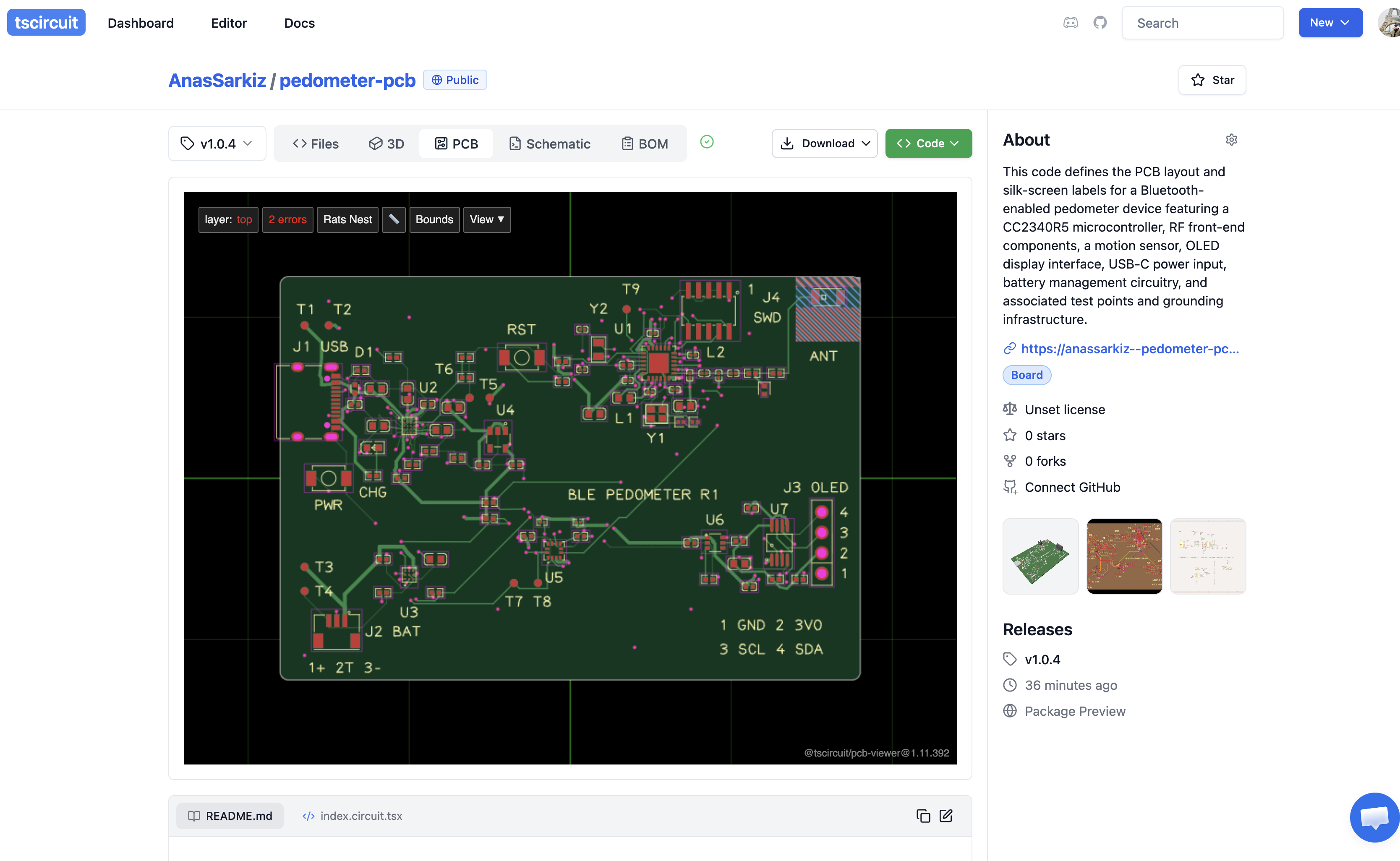

I have another pedometer
Anas
board
<@809856037376491570> s was way more expensive
<@809856037376491570> you were twice as much to ship i think it's due to the size
we should shrink the boards more

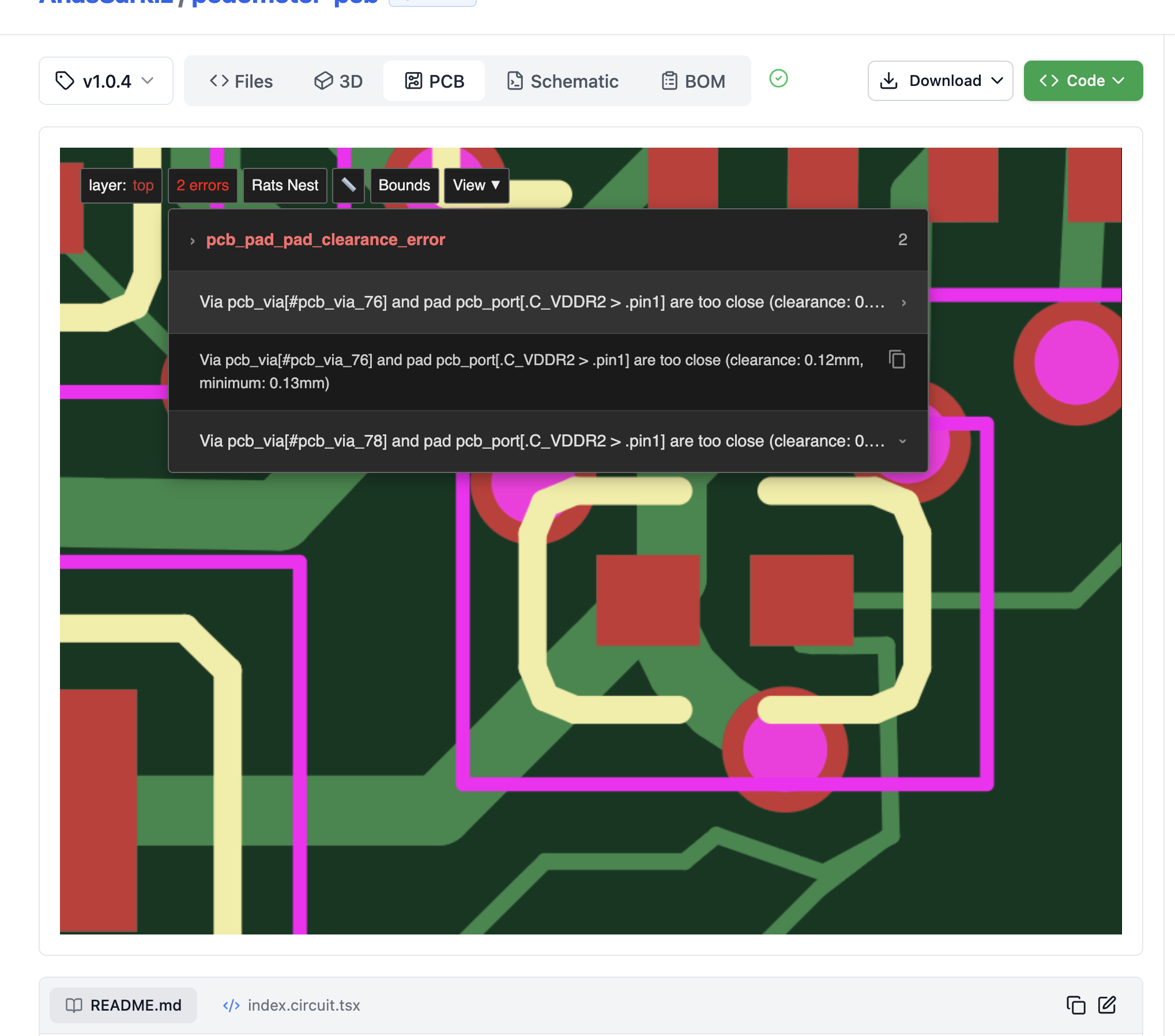

looks good but looks like you have two DRC
Anas
it has 2 DRC errors but Astra said its fine because the clearnce are 0.12
ok
that is supposed to be adjustable via board props

https://tscircuit.com/AnasSarkiz/pedometer-pcb#pcb
Anas
https://tscircuit.com/AnasSarkiz/pedometer-pcb#pcb codex gonna update the config and push the code; heading to bed rn. feel free to order it lol 😆
ya nice work

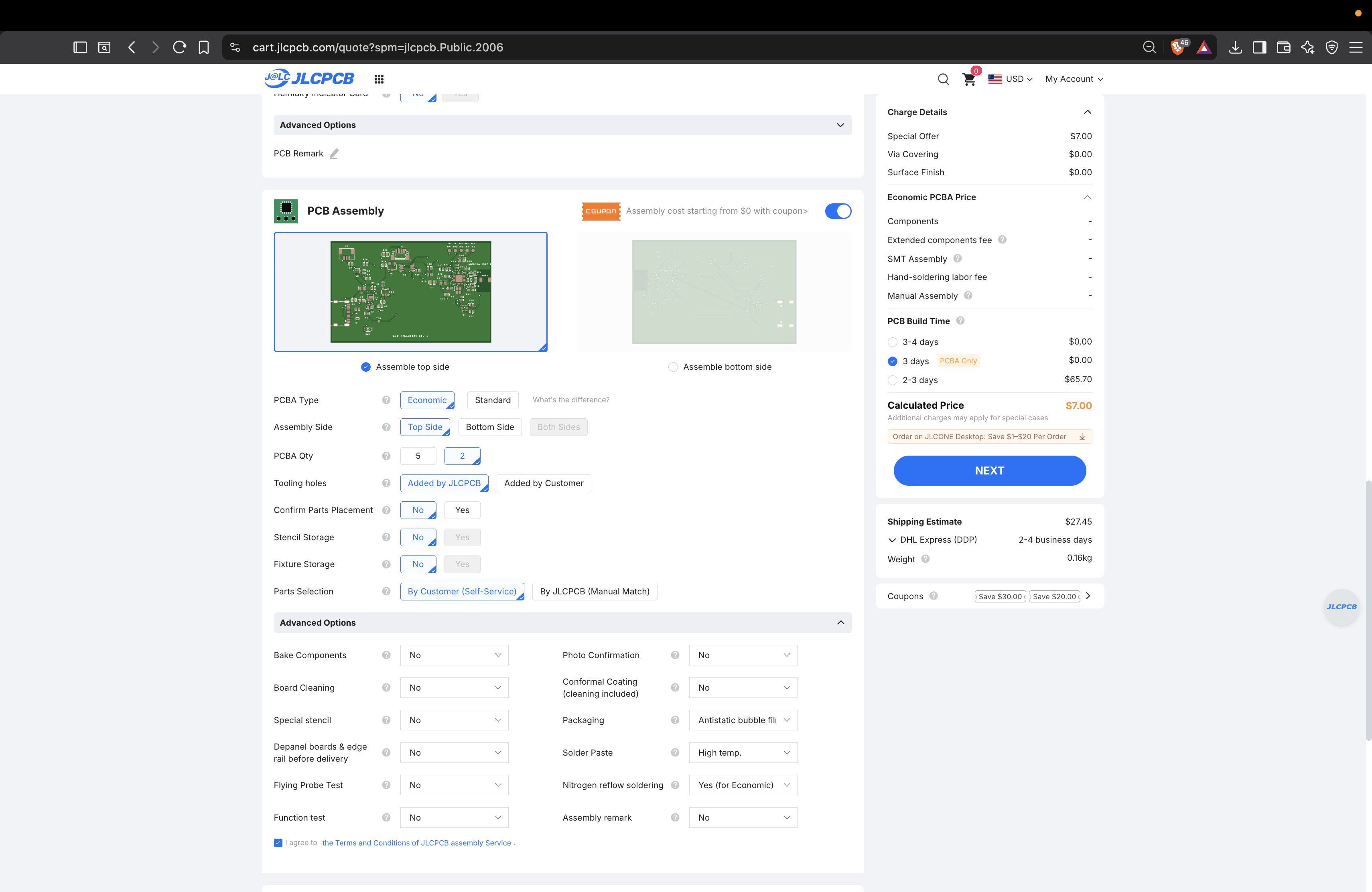

My board is tiny. I think the price was more cause of some components could be assembled only in standard and not economic
Anas
I did same thing in BOM step they ask me switching to Standard IDK why
