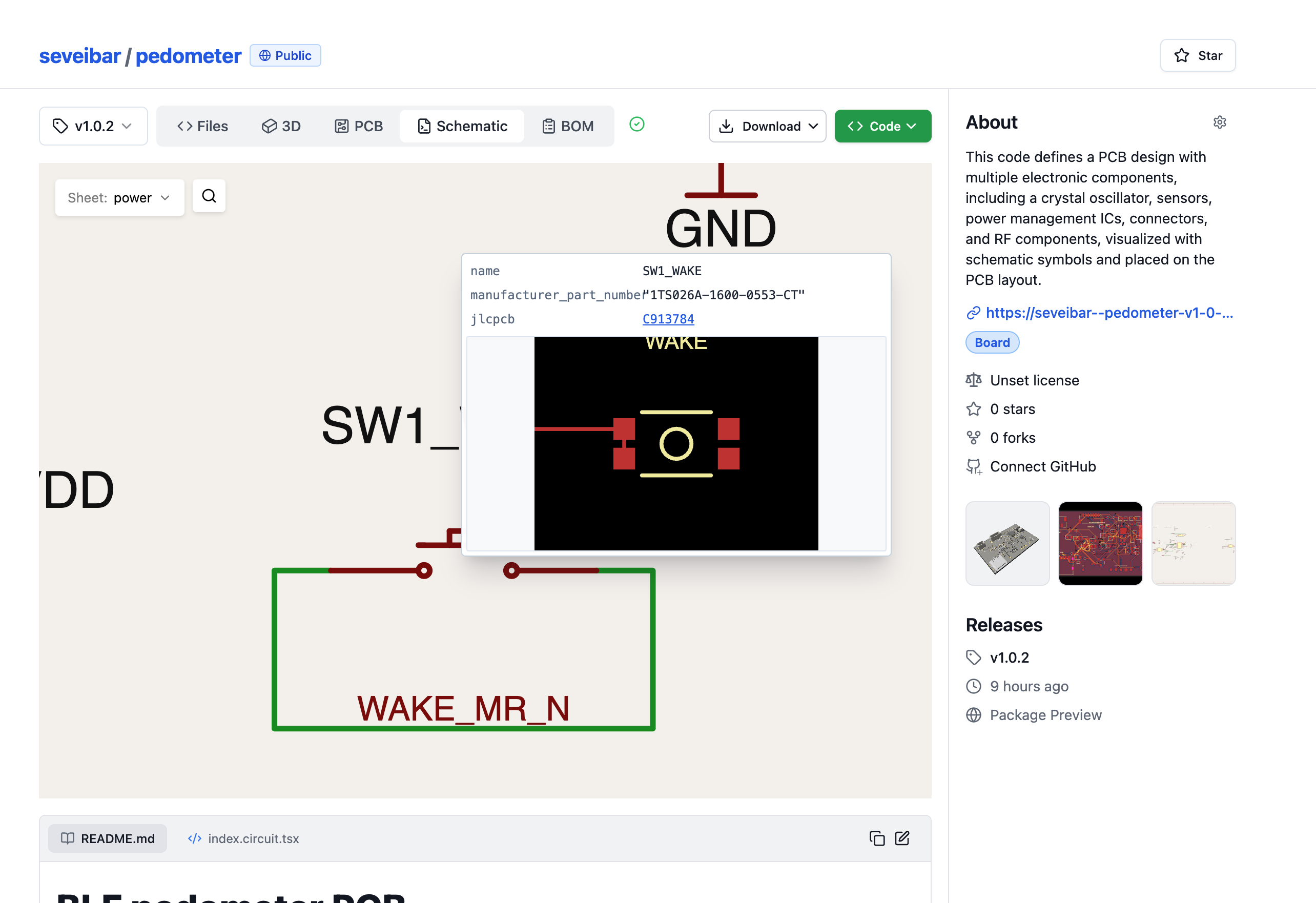

https://tscircuit.com/seveibar/pedometer#schematic

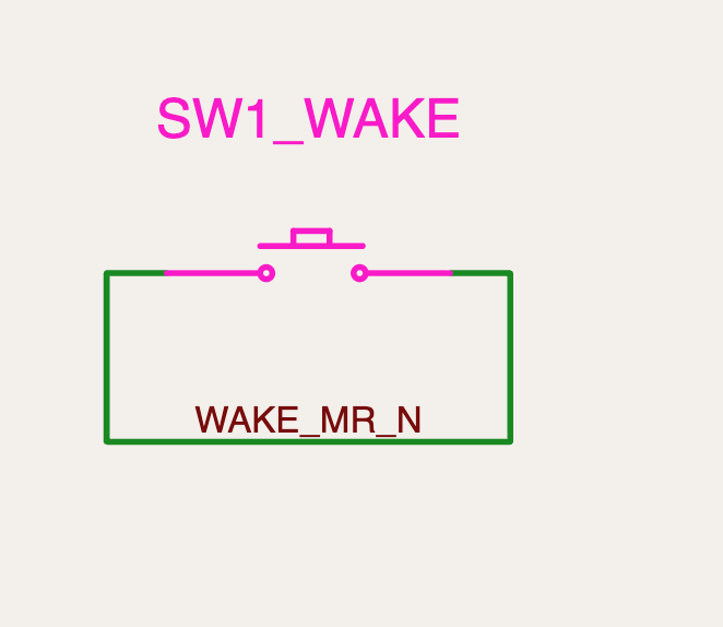

supposed to be four pin ?
no but a button connected to itself does nothing
this should never happen
will take a look

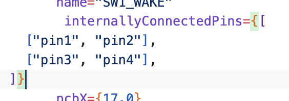

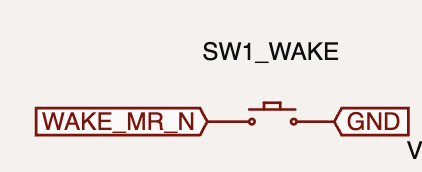

this is fixed with adding internallyConnectedPins, i think we need a check for this "Pushbutton has both schematic contacts connected to the same net"
or am i wrong
https://github.com/tscircuit/checks/pull/263
good, see comment
done take a look https://github.com/tscircuit/checks/pull/263 <@757706909351411845>
