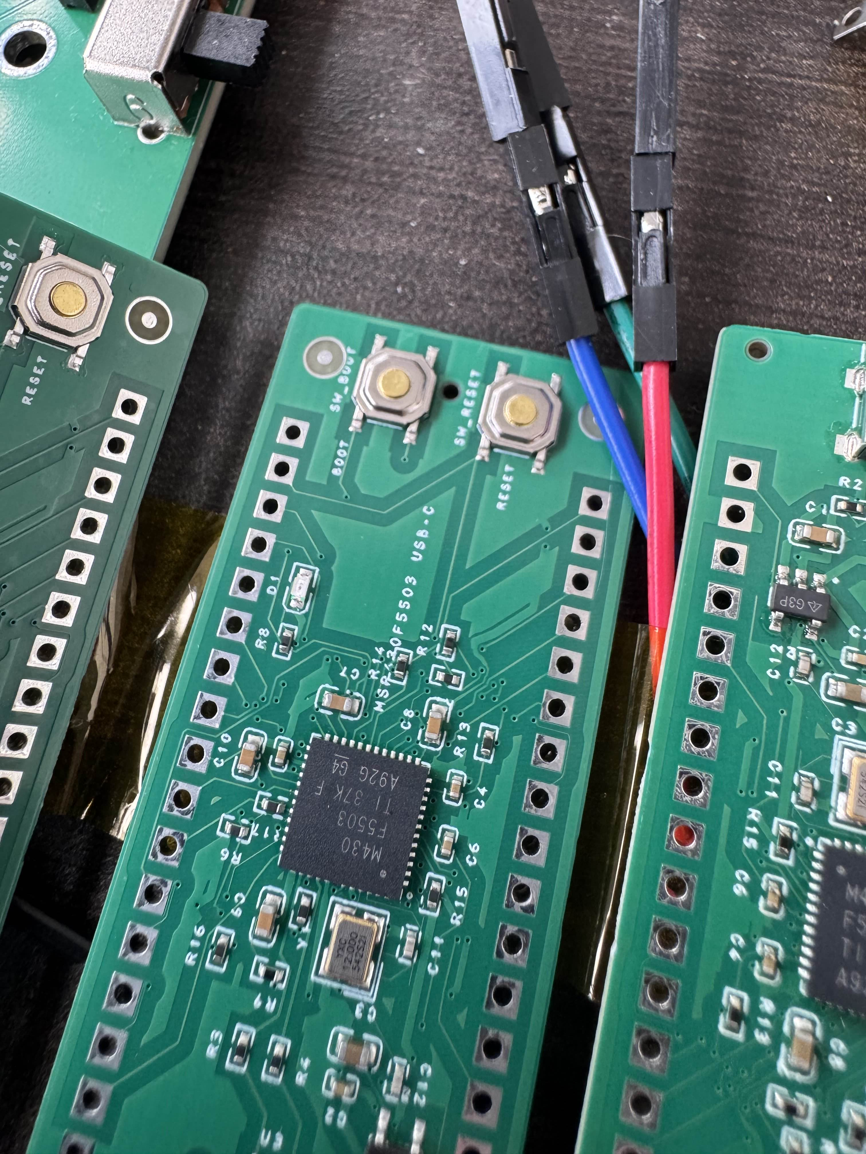

<@778624824875941908> โ€˜s board arrived!!! Has messed up holes ๐Ÿ˜ญ
oh why everytime
what was that .. it is in design too

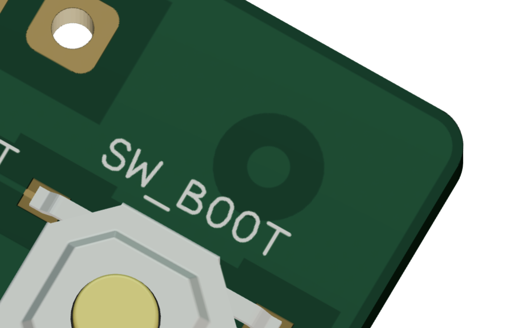

i believe that is a fiducial mark
yea right
yea
<@452450065941004289> no

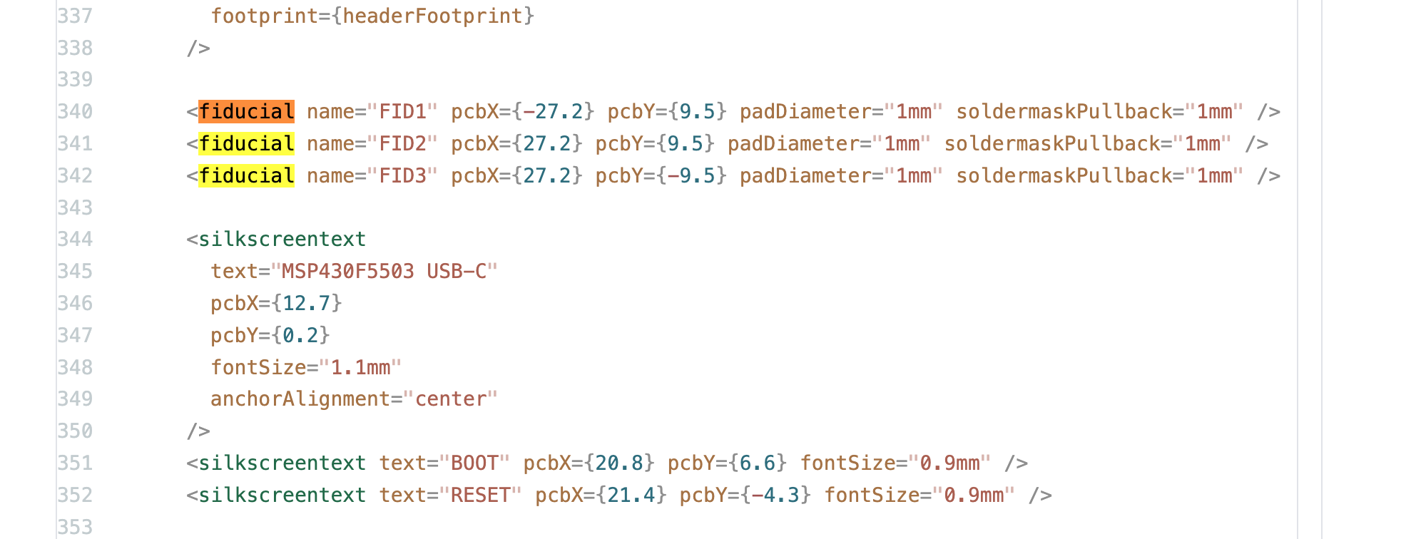

it is not a fiducial afaik, it is a bad hole conversion
i see some fiducial component used in the code too
