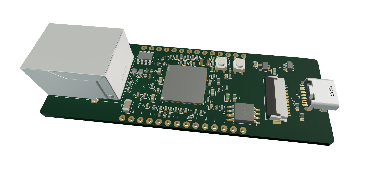

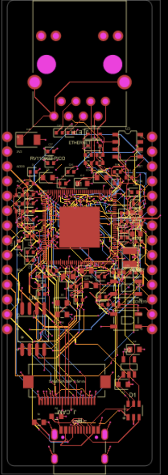

<@757706909351411845> <@809856037376491570> <@400684445054795796> etc.. i have been trying to route this board , but this stuck at some phases ,, any tips .. so that this board gets routed successfully ..
Custom auto route function
Or increase the board size
it looks like it is routing?
there is room to make the board a bit less cramped and personally i would remove the pinheaders and replace with a JST for the SPI line for example
