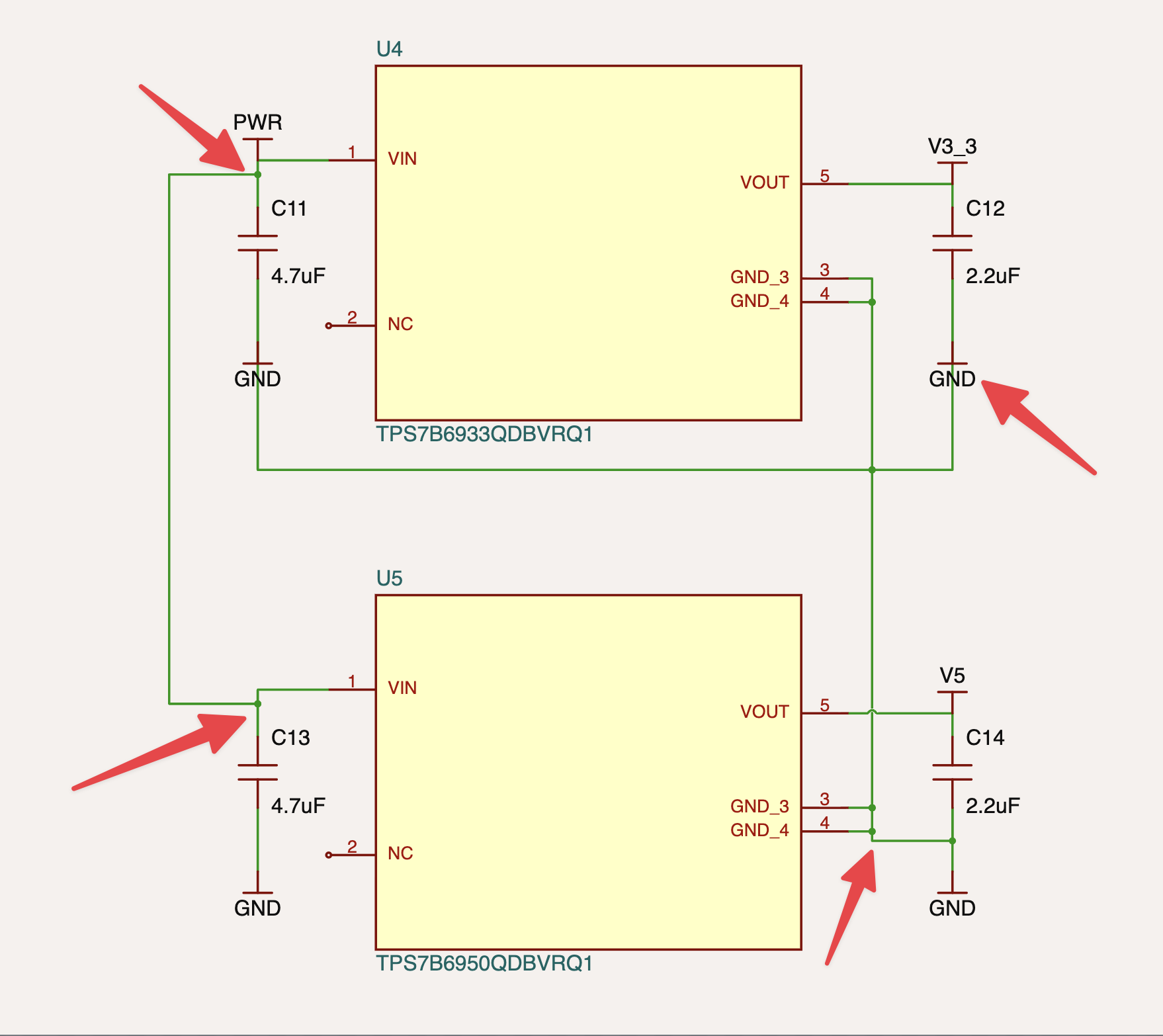

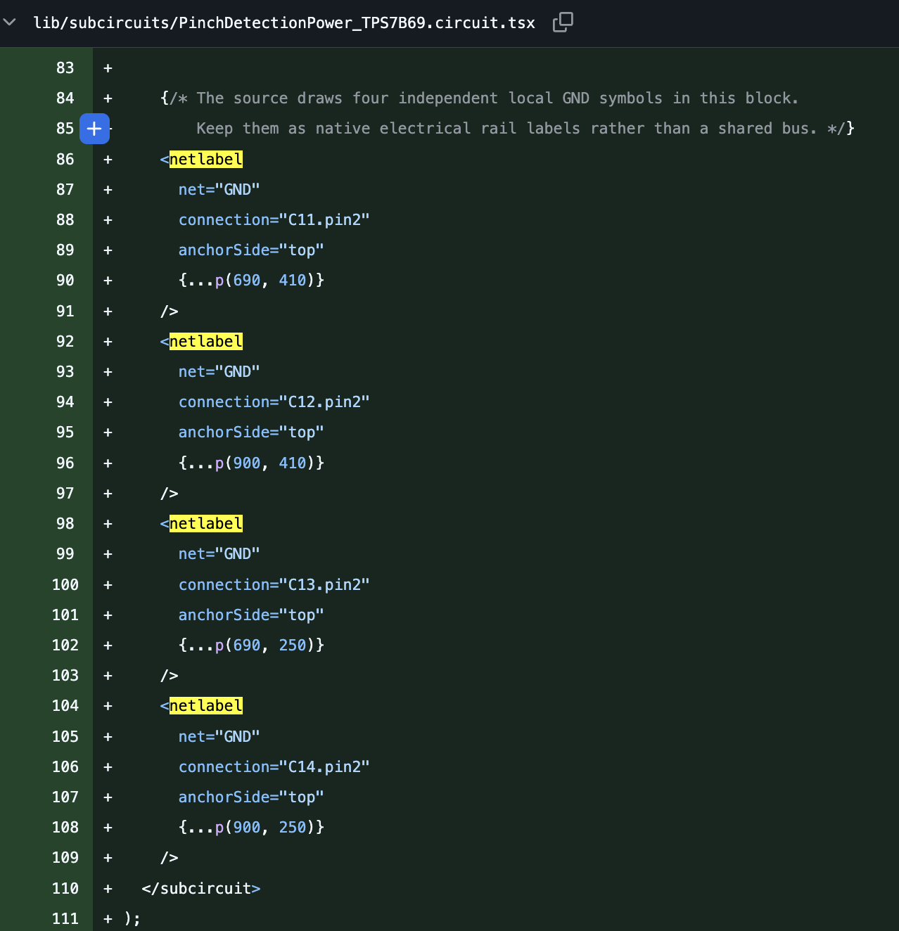

Seve - @Abse found a really good repro, super s...
mention found a really good repro, super small and tons of trace bugs https://github.com/tscircuit/ti/pull/134/files diff 6fb420e46f6876a56a2e3d3a178f2c8572dcea1df084f9823ec9c7f63f00b03e
Started by SeveAug 31, 202618 messages
<@398467566588264449> found a really good repro, super small and tons of trace bugs https://github.com/tscircuit/ti/pull/134/files#diff-6fb420e46f6876a56a2e3d3a178f2c8572dcea1df084f9823ec9c7f63f00b03e
will make repro ASAP
Will fix it
Im working on this tbh
i think the code has some manual netlabels
Ohh ok, then <@398467566588264449> you only have to fix trace alignment if you reproduced it.
Mustafa I think this is fixed in the latest schematic trace solver maybe we are out of date?
You can take it if u like I'm little bit busy sorry
Ok I'll try to repro it if it's not fixed
Ty ty

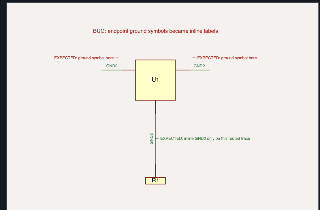

<@1079361271687807026> <@757706909351411845> is this a good repro for inline net label removing GND symbol label https://github.com/tscircuit/schematic-trace-solver/pull/1022

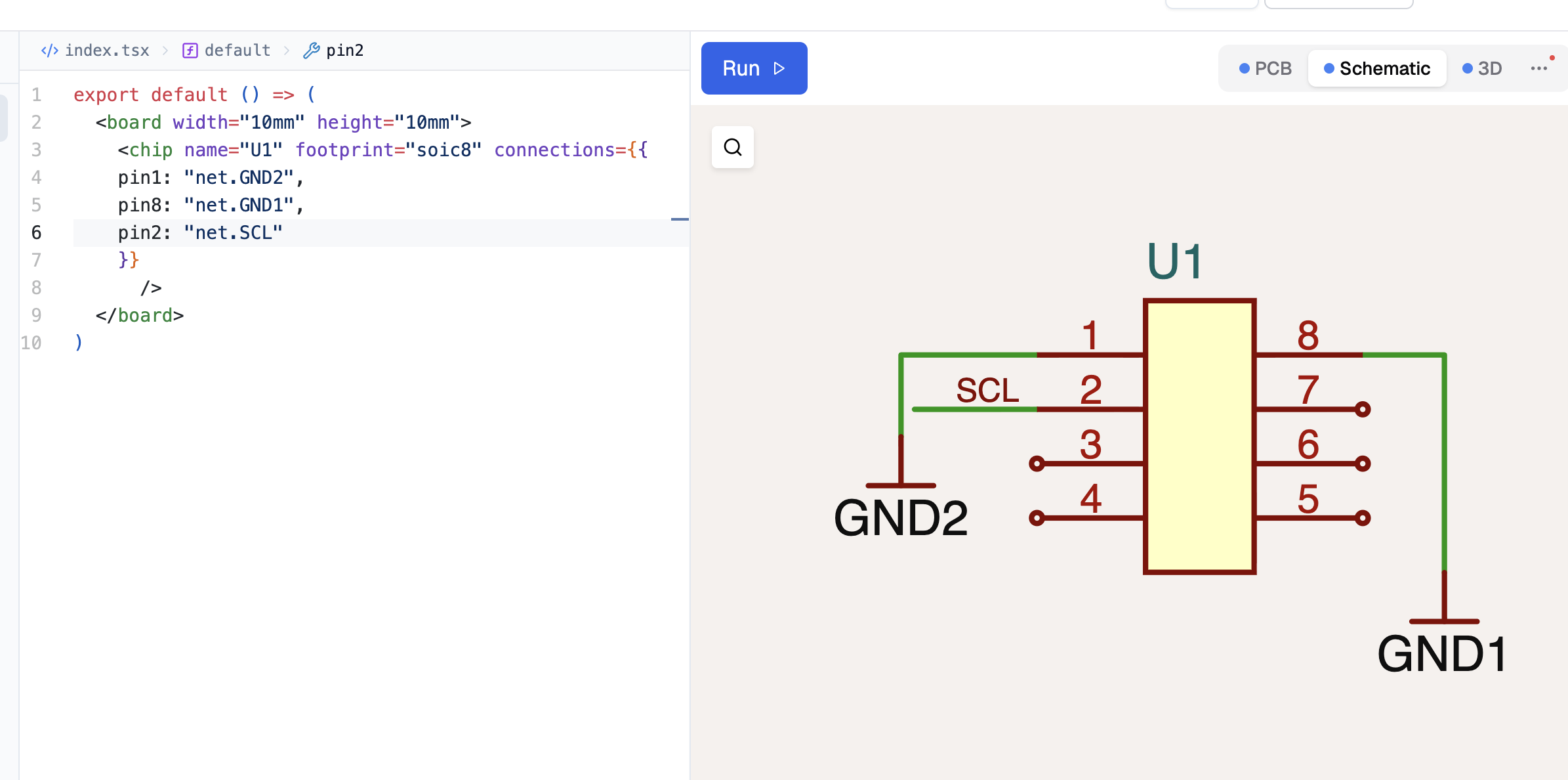

Are you sure? This was the output on tscircuit.com/core?
First test on tscircuit.com
Im not sure anymore , when do we want to use GND symbol and when we just want inline net label ?
GND needs symbol
power/ground labels are always symbols and any other label can be a inline label
