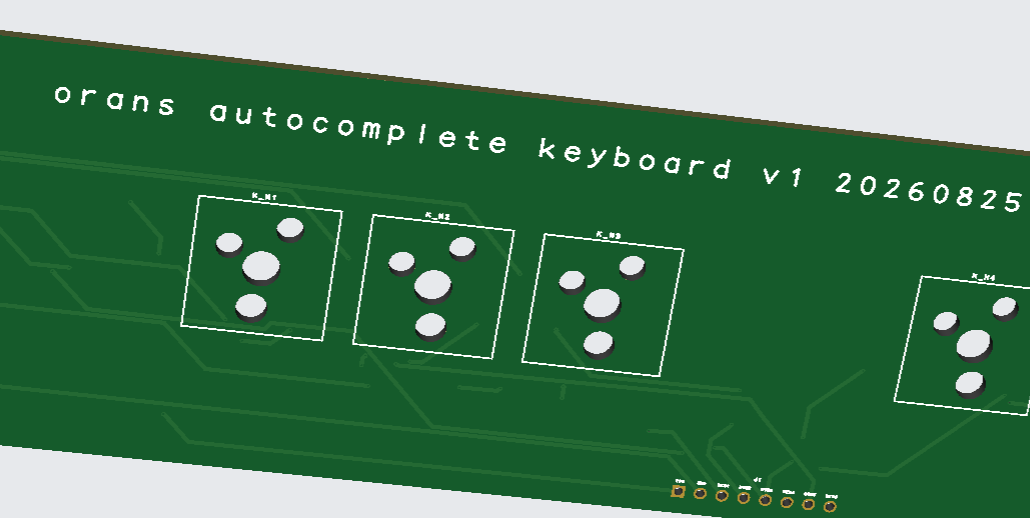

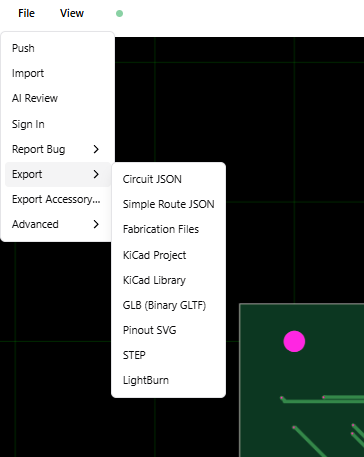

Hey tscircuit peeps! How to fix drill file not populating? ISSUE: Drill holes not showing up in drill file when file export fabrication files & upload to JLCPCB context: im building a keyboard with @tsci/seveibar.keyboard utils WORKAROUND FIX: import and export using kicad. any t

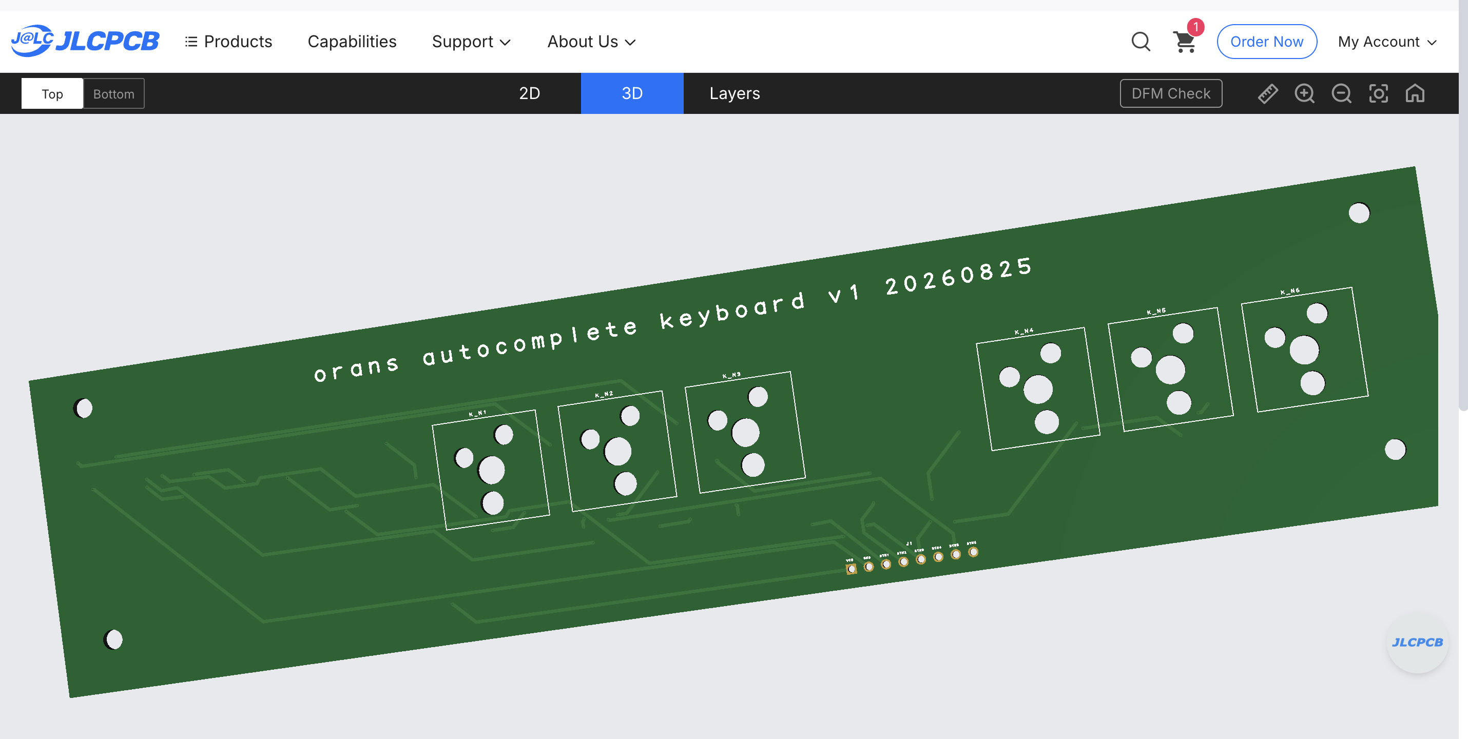

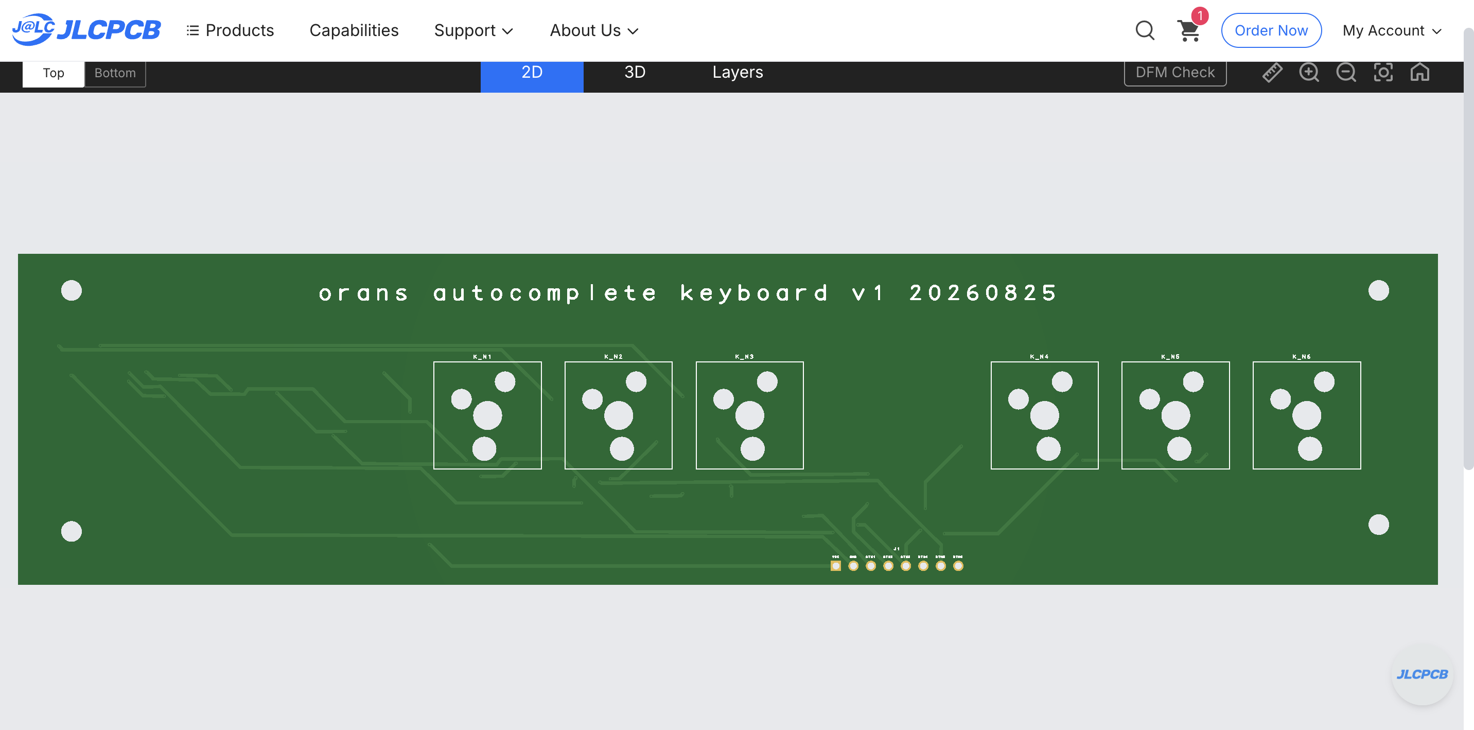

Hey tscircuit peeps! How to fix drill file not populating? ISSUE: Drill holes not showing up in drill file when file>export>fabrication files & upload to JLCPCB context: im building a keyboard with @tsci/seveibar.keyboard-utils WORKAROUND FIX: import and export using kicad. any thoughts?
Hey, Probably circuit json to Gerber bug

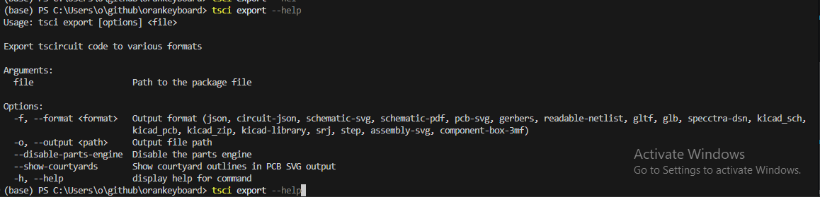

are you using the cli to export ?
hmm this may be because of a recent adjustment where we centralized the gerber generation

no
oran
oran
i try with cli export see if that fix
oran
should i export as gerber?
yep

what gerber viewer are you using
oran
jlcpcb
oran
was on 0.1.2020
oran
heres the old gerber

now I remember fixing this before, should just be an update ( I see the bug from your file)
let me know if that didn't fix it and I can investigate further!
oran
yep solved! updated and that resolved the drill issues @tscircuit/cli@0.0.2020 ❌ @tscircuit/cli@0.0.2021 ❌ updated to : @tscircuit/cli@0.0.2461 ✅
