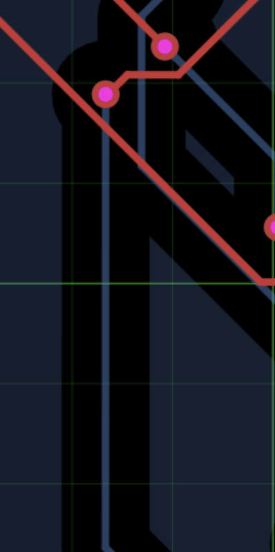

some of the traces look a bit odd

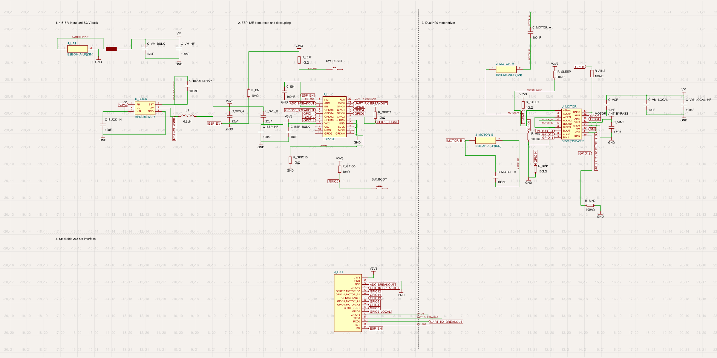

yea maybe add schematic sheets

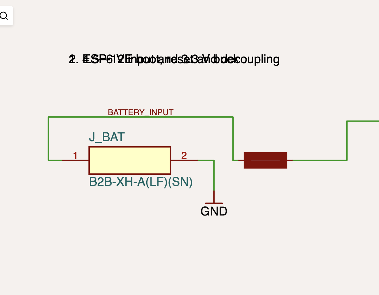

i'm surprised you're missing refdes etc. on one component
actually the issue is two sections gets overlapped when the section 2 component manually gets into section 1 it becomes a single section and the displayName overlaps
tried to render the line that doesn't come well ... probably we can have a offset horizontally , this could be fixed in the code itself butt i see this type of overlap most of the time

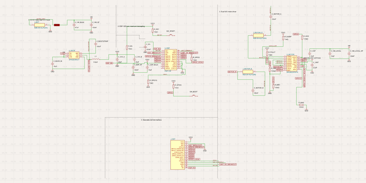

the schematic is better but still not readable tbh
make sure J_MOTOR_A has pins on the same side, make sure the passives are cleanly/appropriately arranged
