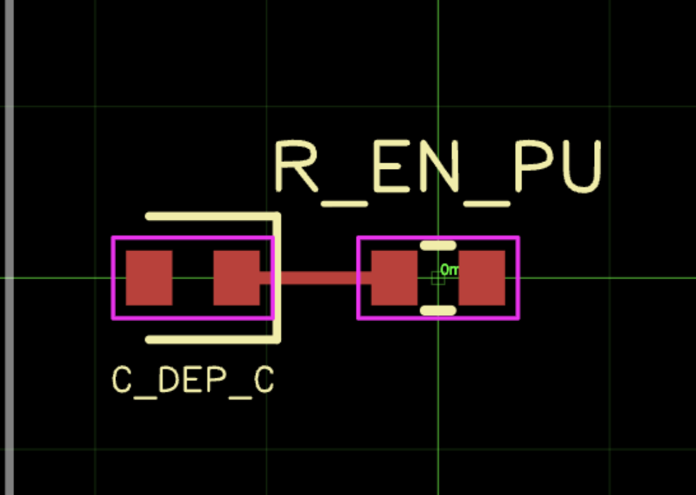

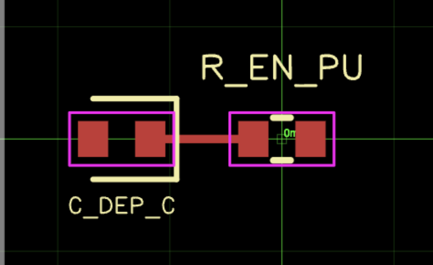

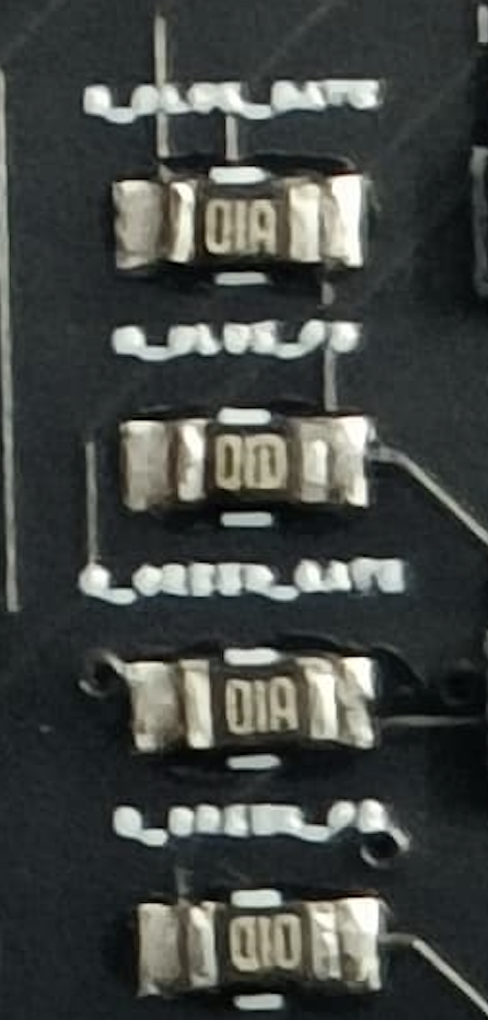

<@757706909351411845> after fabrication the default silkscreen size of components sucks
default is 0.4mm
but the 1mm is ok
Tru
Yea all our silkscreen is bad ye
we need to tweek our font ?
Nah
Just default sizing
hmm..
i feel like the stroke width looks large for small components ,, what if we can have a strokeWidth ?
i think kicad also have stroke width
Isnt it a size not stroke issue?
yea this is a size thing,

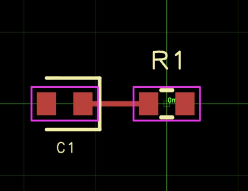

is this good to have 1mm default ?
maybe 0.7mm ? R1 here is 0.7mm C1 is 0.4mm(default)

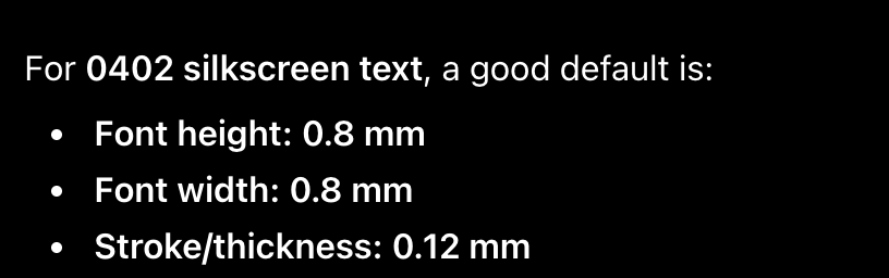

Hard to say, what does kicad use for 0402s
yea this is soo hard to decide
0.4 vs 0.8
