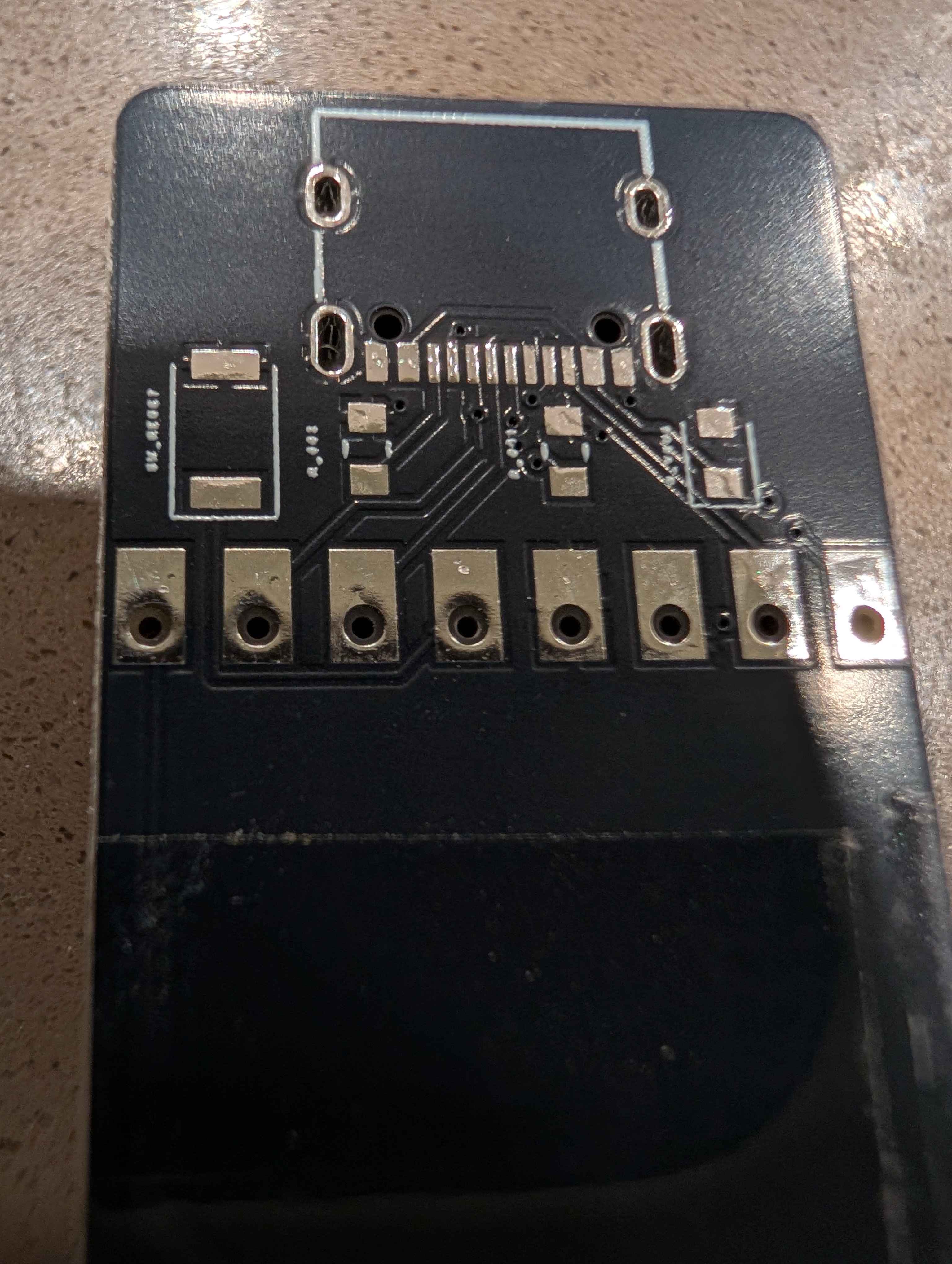

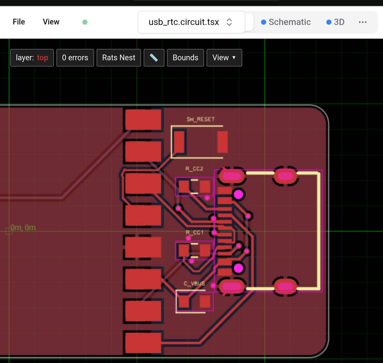

Somehow the thruhole and the pad isn't connected

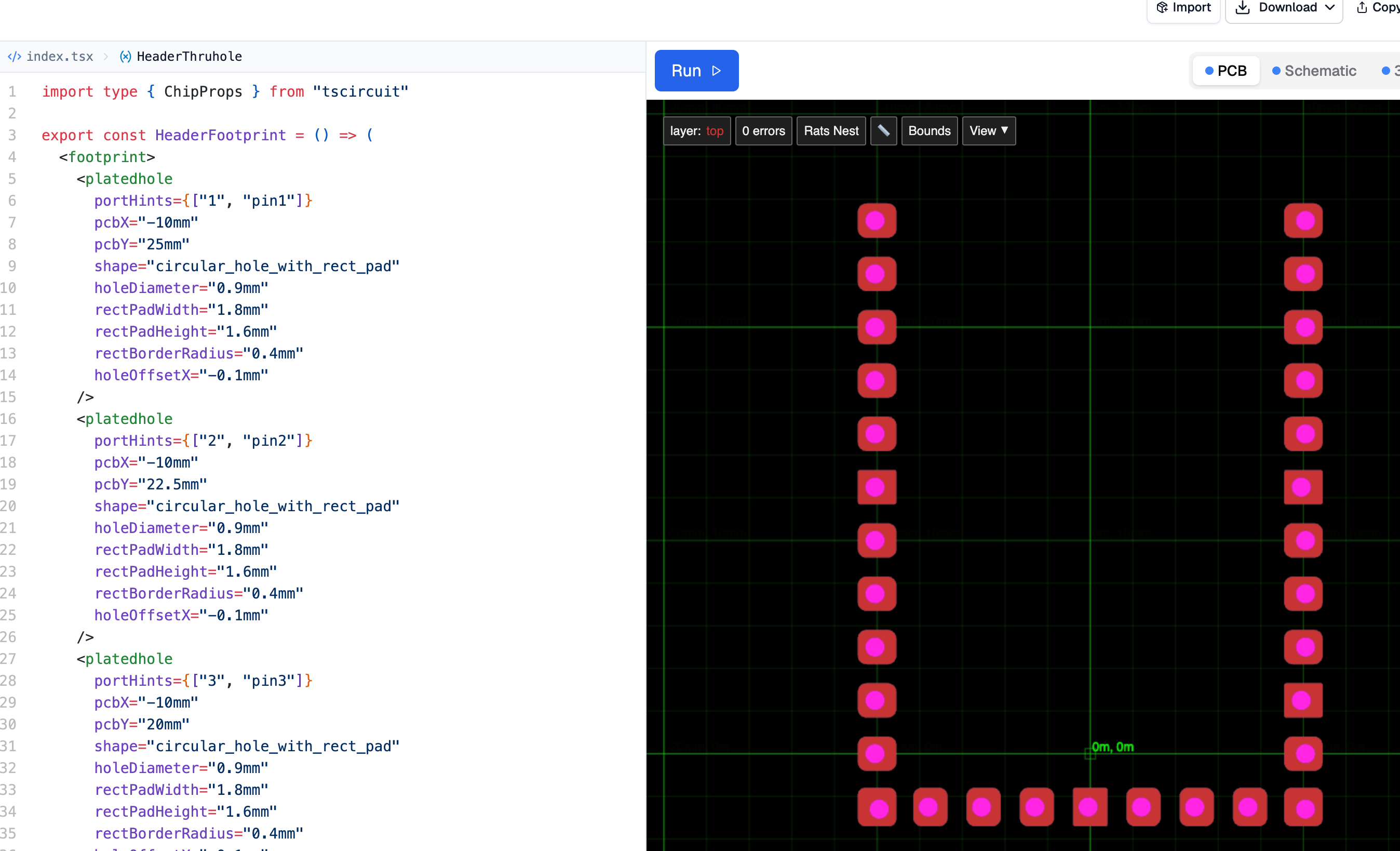

<@481019381623554049> We don't support asymetric plated holes shapes on different layer yet. But I think you can hack the <platedhole /> with overlapping <smtpad layer="top" /> and <smtpad layer="bottom" /> to get different shape
but we will add support for that
interesting, can you share the reproduction or the code snippet for that section ?

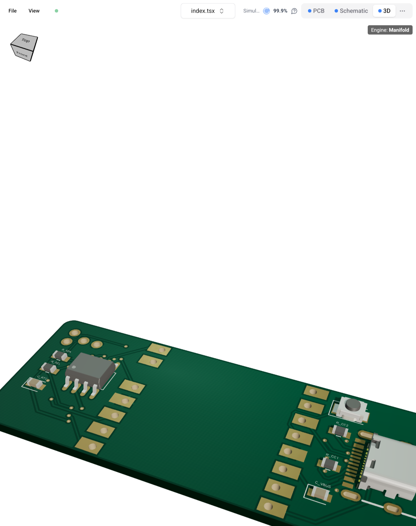

nice board <@481019381623554049> !!!!
crides
Check the other footprint in there
