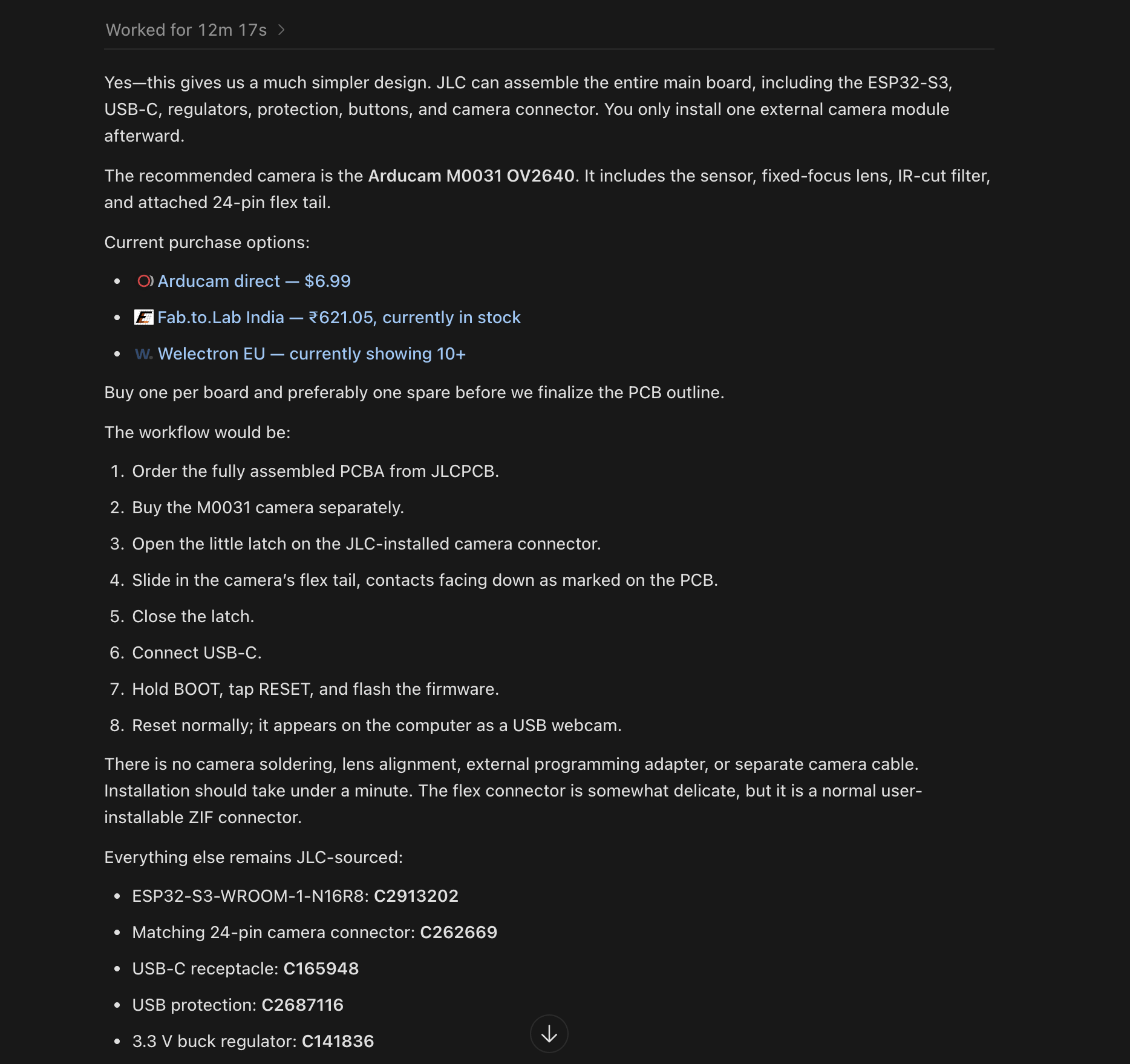

Why are these parts not available in JLCPCB? I want to make this camera module, but the required camera components are always missing from JLCPCB’s parts library. It keeps asking me to a pre-built camera module instead.
you need an FPC connector
that camera does not have a footprint, it's a part that goes into an FPC connector
you will need to select the FPC connector
