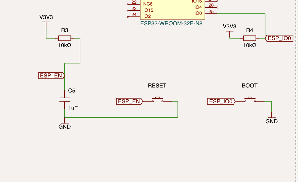

i think this is older version

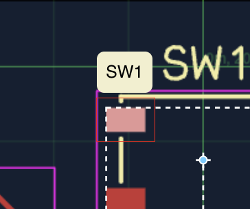

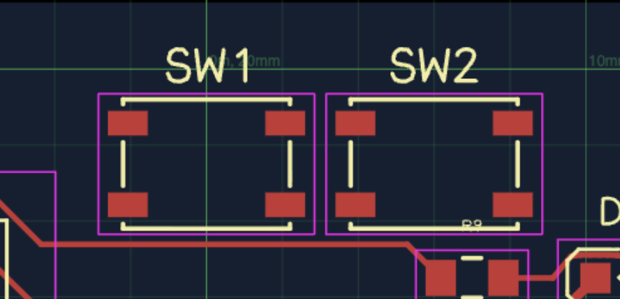

i feel like button were not connected in pcb ,
these button also not exposing any pins too
ig that would be caught in netlist check
those were kicad imported switches
https://github.com/tscircuit/core/pull/3320 , maybe some caching issue <@757706909351411845>
nice catches
