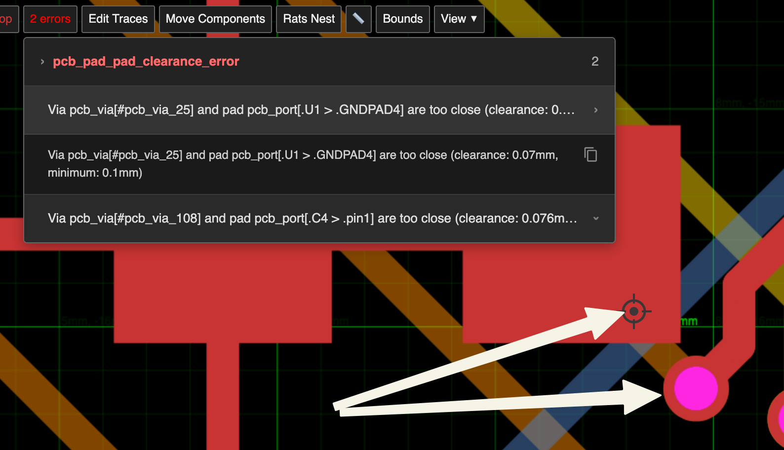

Via is too close to pads, seems a bug
Started by techmannihAug 19, 202610 messages
hmm
this may be due to a new check
actually this looks legit
you should just repro in the autorouter and open a bug report
that via plating is too close to the pad
also why are you vague posting, leave a comment lol
yea added comment
Probably a repair03 bug ig cc <@756504518417711104>
