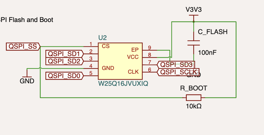

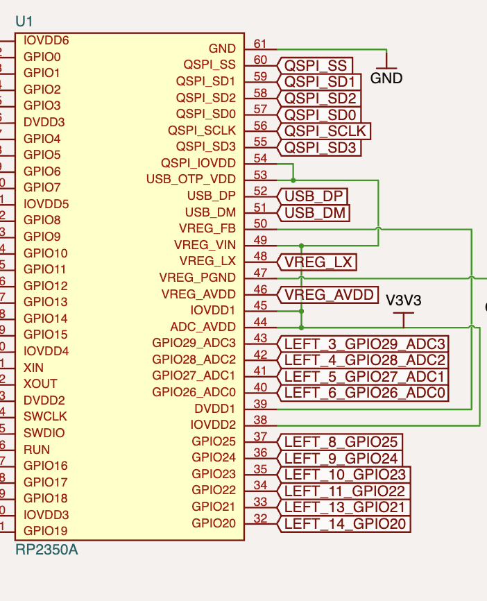

<@757706909351411845> https://tscircuit.com/editor?package_id=414b4fbb-4db3-414e-8856-3e10c615fef5&file_path=index.circuit.tsx
<@809856037376491570>
ok
<@757706909351411845> https://pip-assets.raspberrypi.com/categories/1214-rp2350/documents/RP-008280-DS-1-hardware-design-with-rp2350.pdf
https://tscircuit.com/editor?package_id=e57dec57-6560-49a6-b583-798b18d5cbd3
