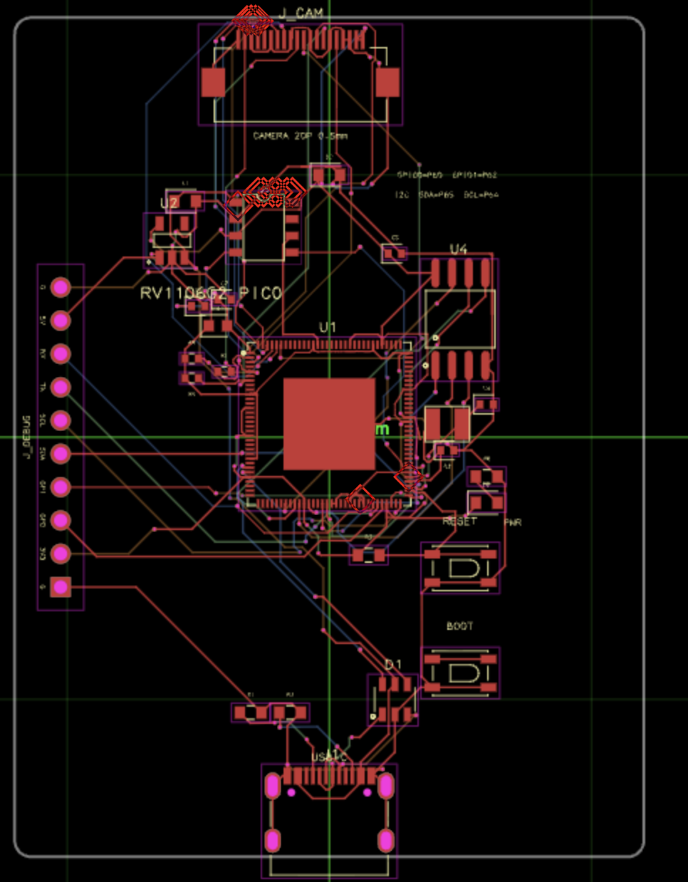

these chips were cool <@757706909351411845> building a RV1106G2 dev board rn

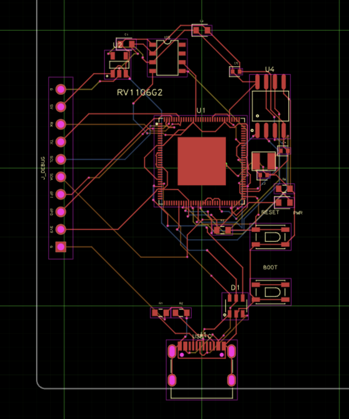

got to able to route this basic board dev board rn , exploring more still .. this has lot more cool pins ,, will expand the board
will add those connectors in the next iterations
nice that's awesome
awww , adding one more connector ends up consuming more time to route 😭

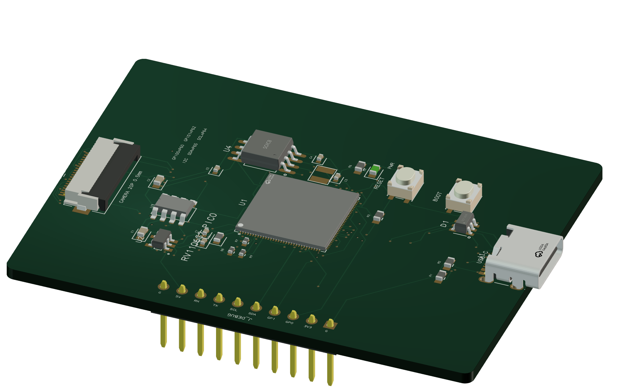

uff finally got able to add one camera connector !
https://tscircuit.com/mohan-bee/RV1106G2
make sure to use four layers
yea that is four layer
and yea i would make it smaller
add pours
your flex cable for the camera looks backwards imo
idk if that's intentional
