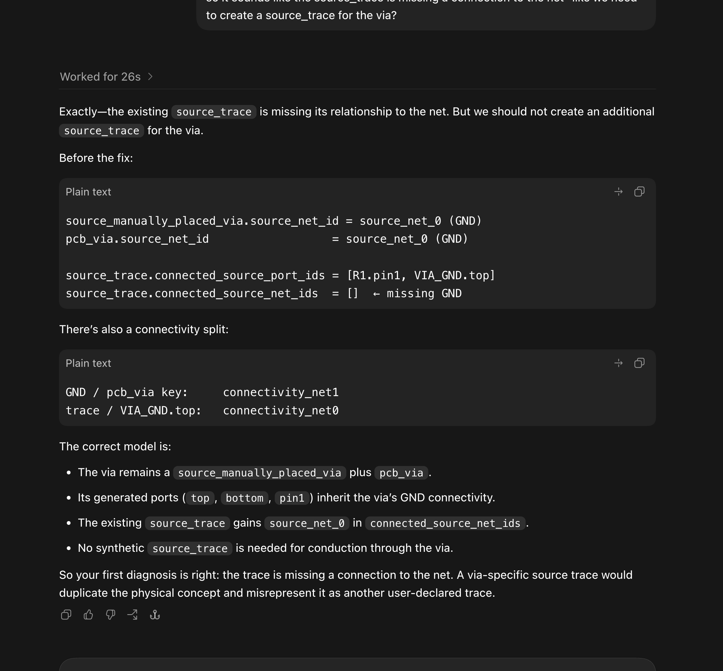

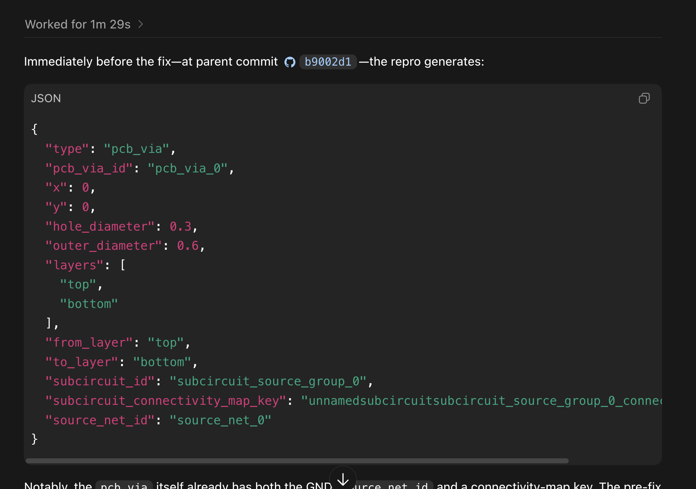

<@398467566588264449> ๐Ÿงต for the pcb_via connectivity
<@398467566588264449> https://github.com/tscircuit/core/pull/3224/files I think this implementation is pretty solid
<@757706909351411845> https://github.com/tscircuit/core/pull/3270
subcircuit drc was not working
