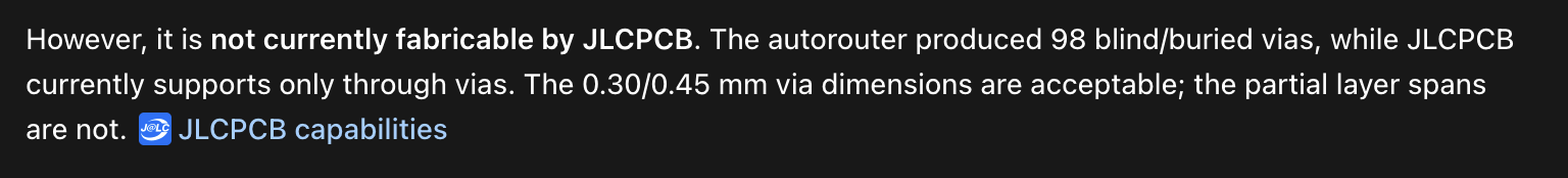

shibo - @Seve what does this mean?
mention what does this mean?

you're using blind/buried vias
are you using the fanout solver
no
so these vias are a result of trying to route bgas without using fanouts?
no... i don't think the regular autorouter supports buried/blind vias so i'm wondering how you could possibly have them
they are vias that are only on some layers and not others
they are used during HDI/fanout
sometimes
