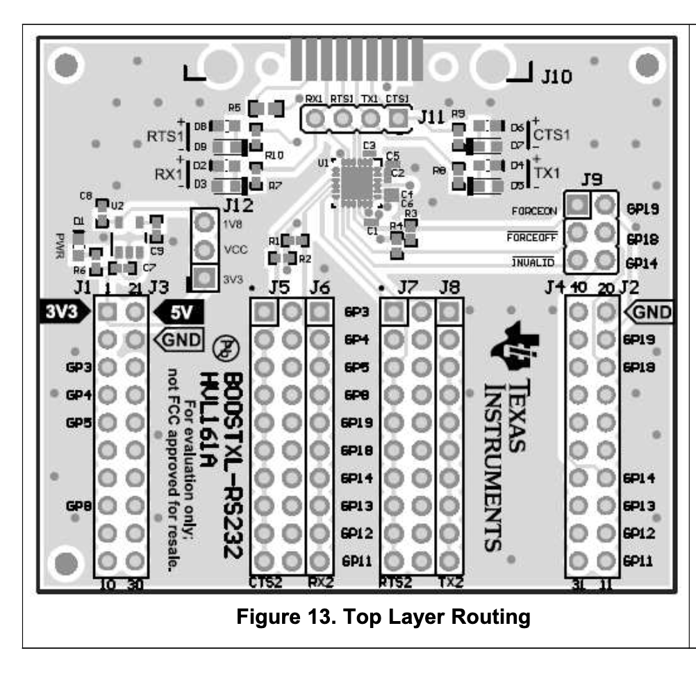

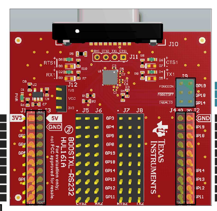

https://www.ti.com/tool/BOOSTXL-EDUMKII Something like this
i am on it, TY

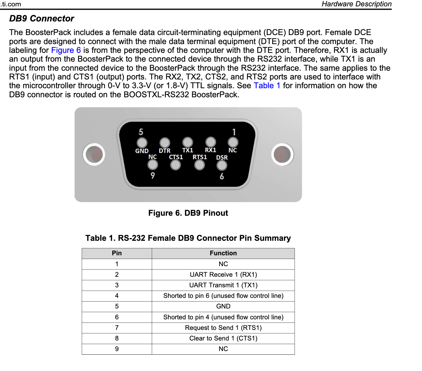

<@809856037376491570> https://www.ti.com/tool/BOOSTXL-RS232 is it okay?
https://www.ti.com/lit/ug/sllu250/sllu250.pdf?ts=1786613928353&ref_url=https%253A%252F%252Fwww.ti.com%252Ftool%252FBOOSTXL-RS232
Yeah
rest board is done
