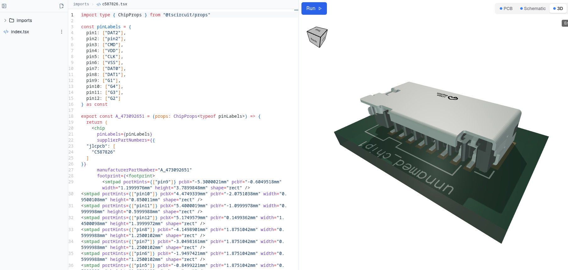

CAD model pins mismatching the footprint. JLCPCB: C587826

it seem correct on the website, maybe we need to update the version on cli

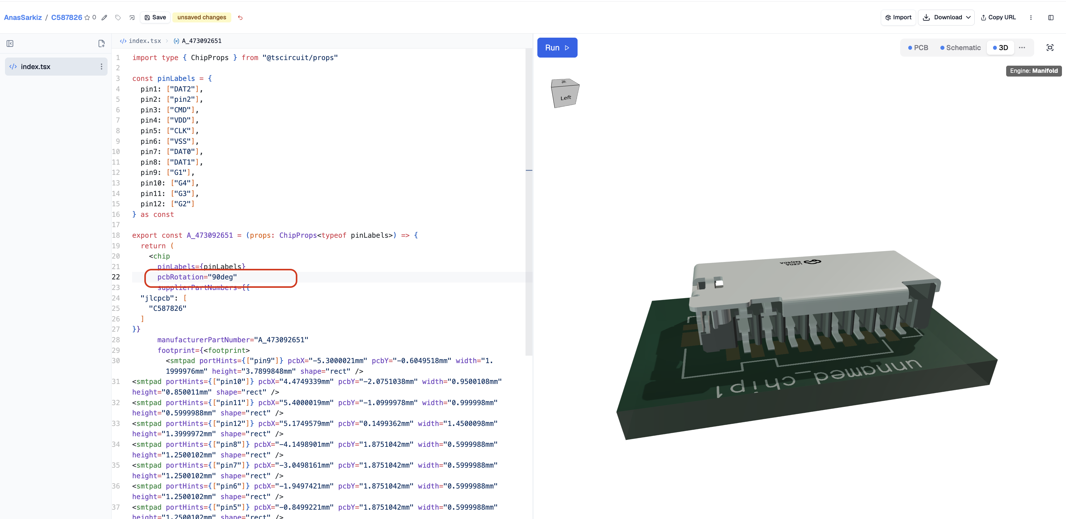

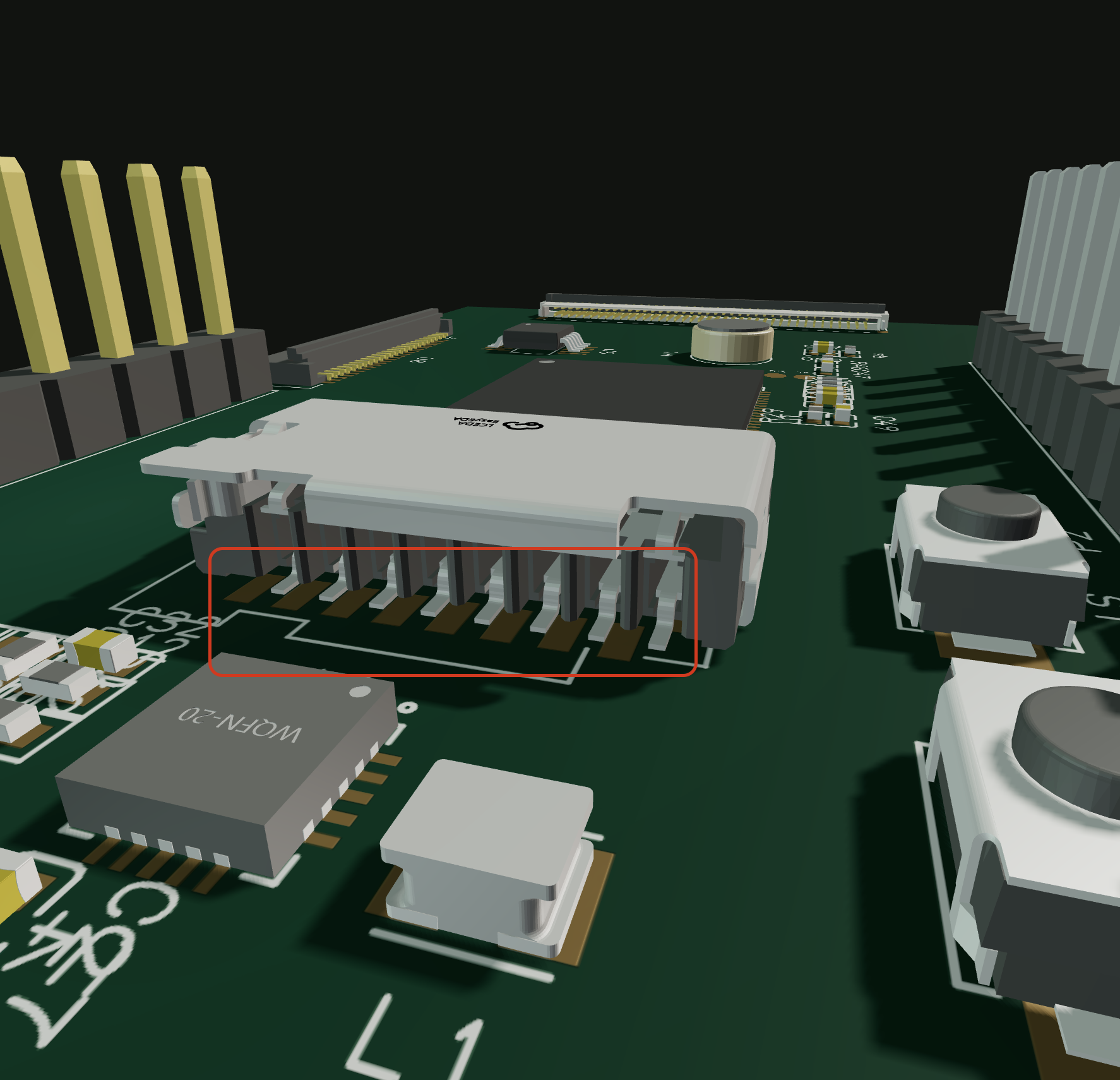

the issue when adding rotaion
ooh
nice find, let's fix it!
