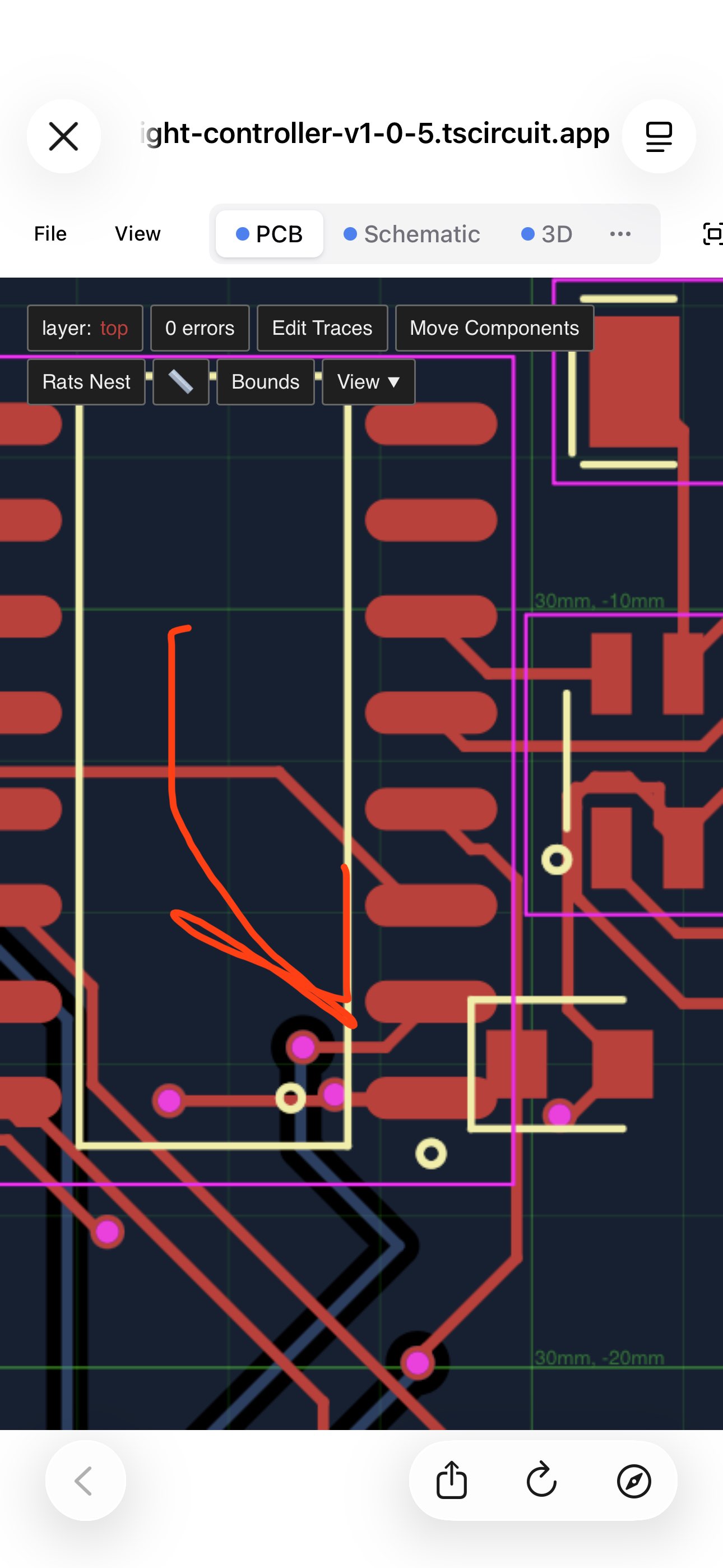

<@757706909351411845> <@809856037376491570> https://mohan-bee--light-controller-v1-0-5.tscircuit.app/ https://tscircuit.com/mohan-bee/light-controller design review pls
I think u might needvto run tsci check placement Also tsci check shorts
Overlapping courtyards
wth .. that should be in drc right ?
pad overlap ?
check shorts got that .. but i think we need to have that in drc ? wdyt

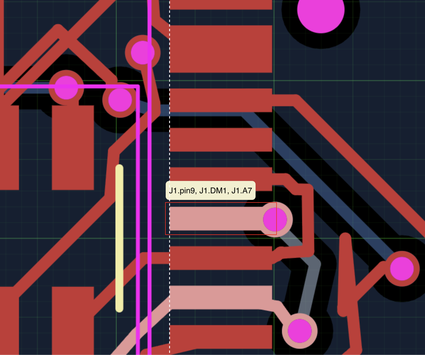

is this ok ? the via on a pad ?
i think it's ok
yes that should be in DRC
idk why it wasn't caught
that's a courtyard overlap issue
looks good to me!
