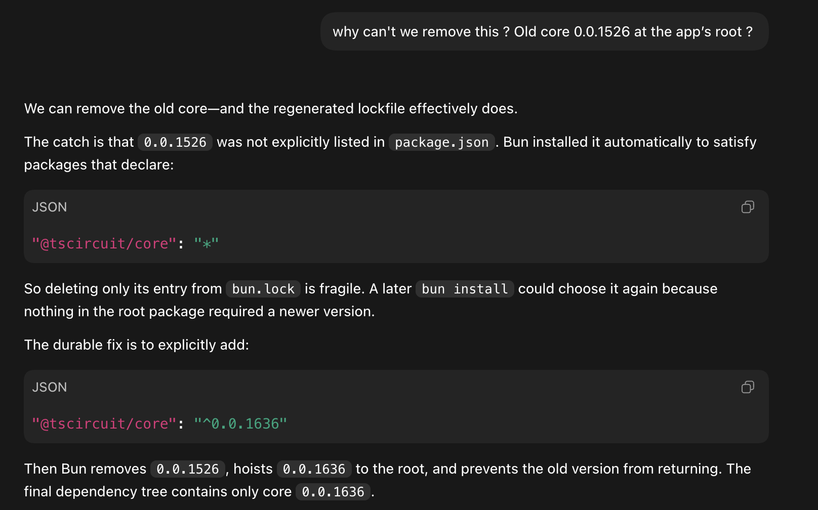

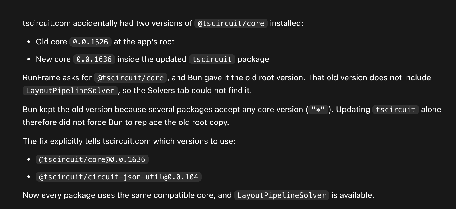

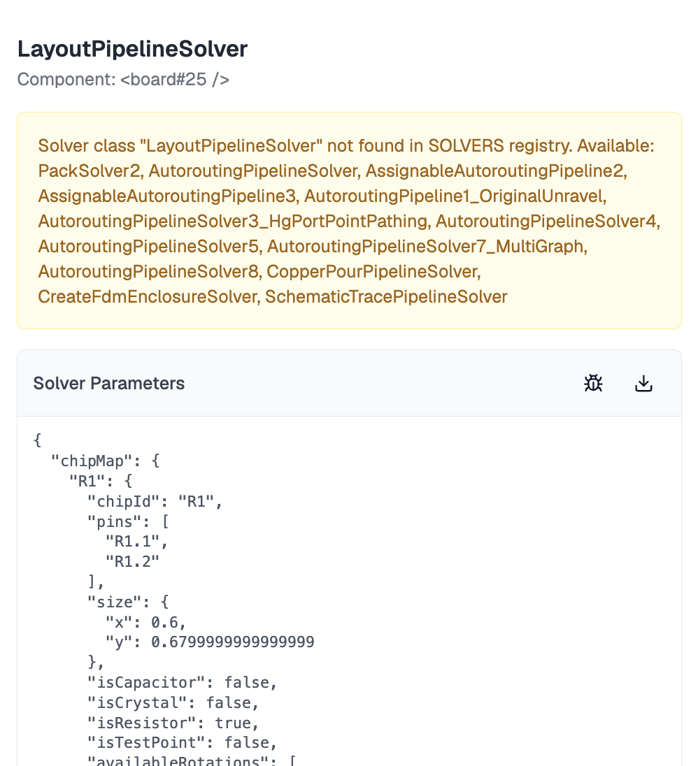

i just added the mathpack solver to runframe .. in runframe that works fine becuase runframe gets the proper core version .. but in tscircuit.com .. it breaks and i have been fighting with ai on full day. .. and it says in tscirucit.com bun.lock has 2 version of core one pins to the old which caused this issue !!

i mean LayoutPipelineSolver in solvers tab https://github.com/tscircuit/runframe/pull/4403
maybe the bun.lock is stale. Delete it in tscircuit.com and install the dep again. Then push that bun.lock
okay.. leme try
gotchaaa !! fixedd thanks <@809856037376491570> ❤️ https://github.com/tscircuit/tscircuit.com/pull/4327
