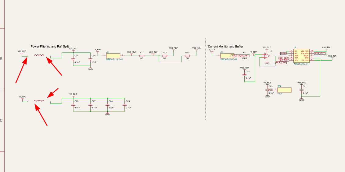

Schematic looks bad
yeah still working on it
I think this means theres a dep needs to be updated ??
for the small symbols ?
Not sure, could be a trace solver issue or placement issue as well
yea definitely inductor needs to be shrunk i think
Cause the stem of that inductor is missing
yea
inductor needs to match the kicad standard sizes we're doing for caps and resistors, and yea there's a stem issue too

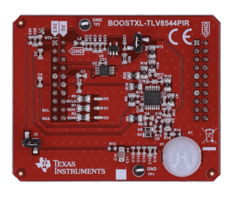

<@809856037376491570> <@757706909351411845> can I get another review https://tscircuit.com/editor?package_id=bed74543-57fe-4324-8e84-63b1dadd5986&file_path=index.circuit.tsx
Ref https://www.ti.com/tool/BOOSTXL-TLV8544PIR

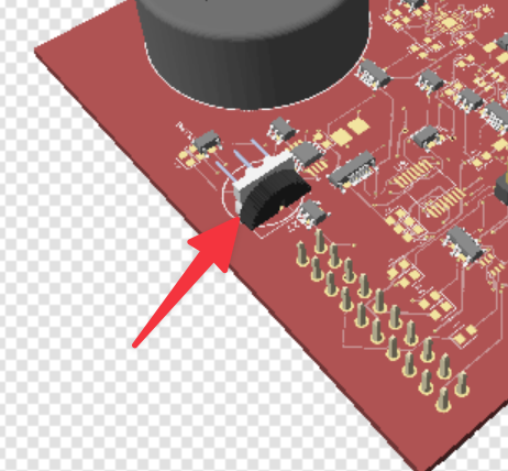

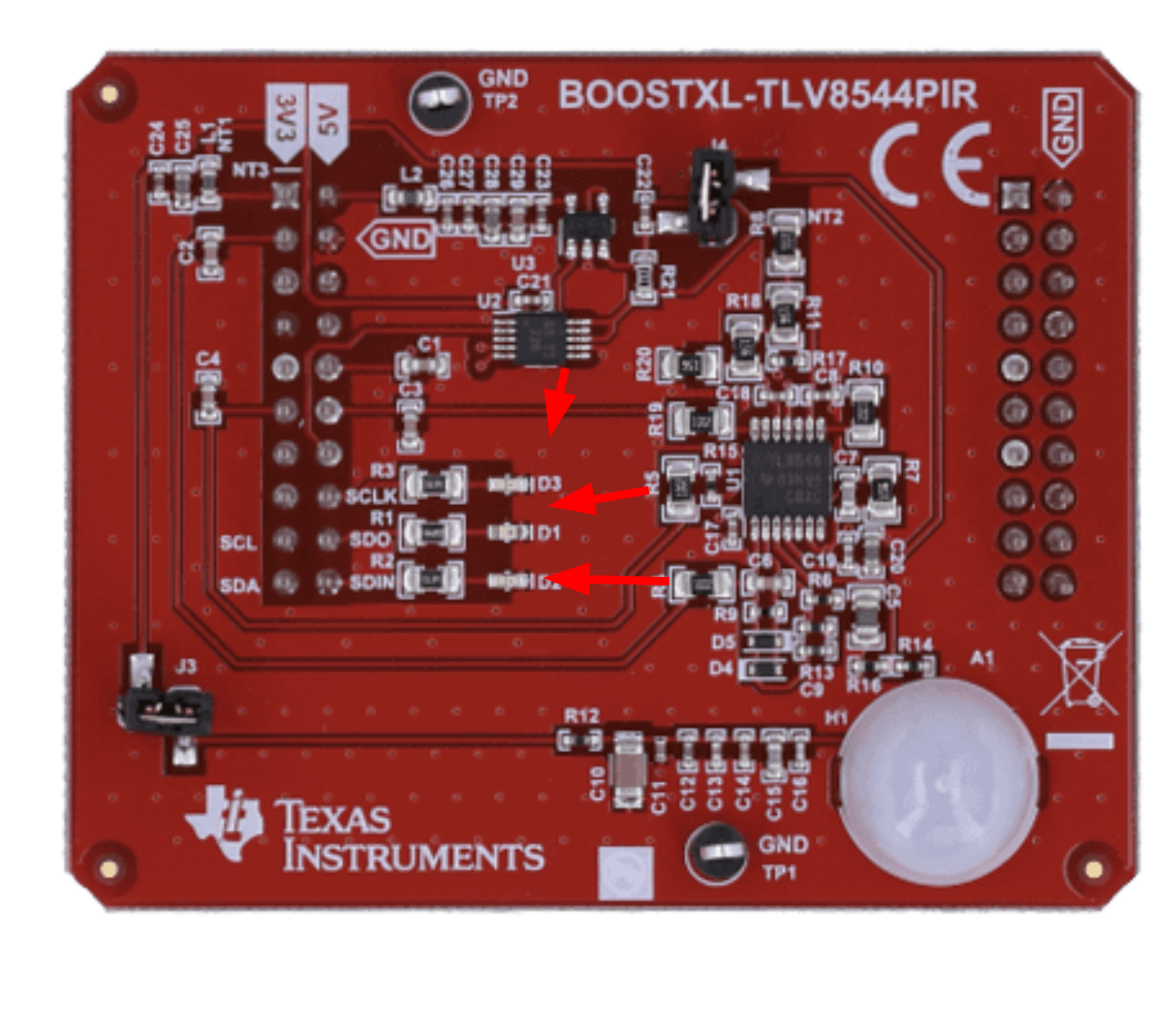

Are the LEDs going to be visible under the board
wdym under the board ?
these are the leds right ?
Your design has females
Pointed above board
So id toy fix the headers maybe?
Ok
