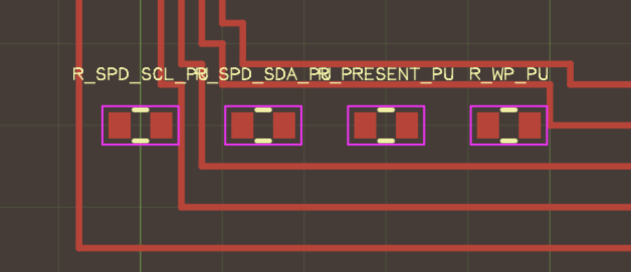

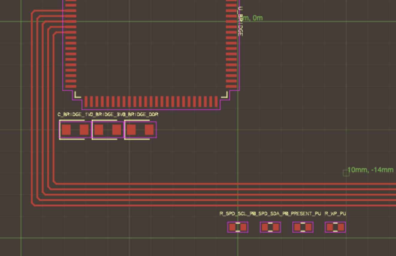

for routing the bus at the start this can be an real pain how to not block off components haa
Started by 0hmxAug 6, 202613 messages
Yep exactly
It may need to know about future traces for penalties etc
I just asked it to move the components, and it did it really well. Now I'm thinking—can I just throw these kinds of error at it? Maybe we're just not that good at doing things like this, and moving components is exactly the kind of job AI is great at.
yep 100% agree
also i think we should be able to analyze those situations and basically be like "the bus is unnecessarily blocking a component's escape" so that the LLM can work in a loop correcting it
basically we need to be able to generate issues for a partially routed PCB
if we keep collecting issues and AI can do partial routing, then it could analyze the routing before it attempts a 2hr route job (my AI is often taking 1-2 hours because it increases effort rather than solving the problem)
