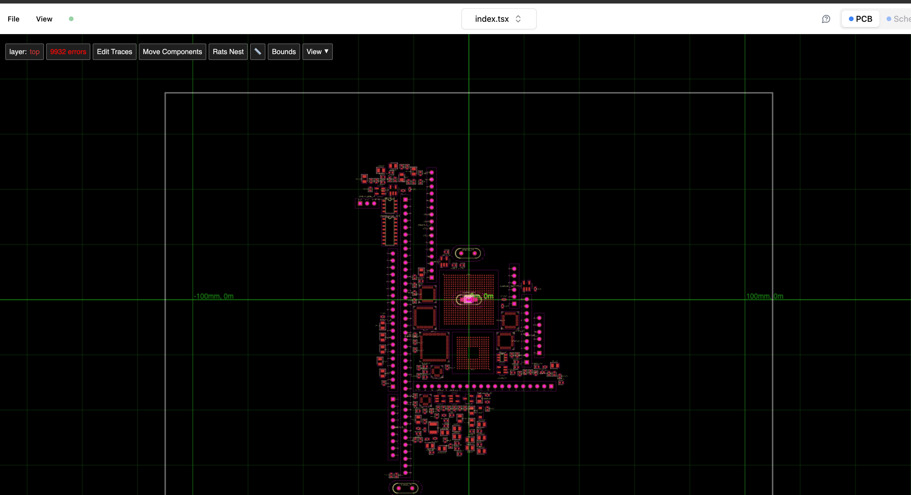

Hey team! I tried to generate this pcb. Its a bit big, but it should be working and it takes 4h at the placement part. Is there a way to accelerate the autoplacement or all I need to do is buy a better CPU?

well not even the routing. it like froze at the placement part
abeh
i even disabled the routing

its 213 components tho so that might be why

I can try to investigate this
Took 30sec to get the pcb preview, it was because of redundant `<trace />` elements, when the `connections={..}` on the components are already capturing the connectivity. The packer converts port-to-port <trace /> into weightedConnections, which takes really long to compute as there are 825 such constraints cc <@757706909351411845>
