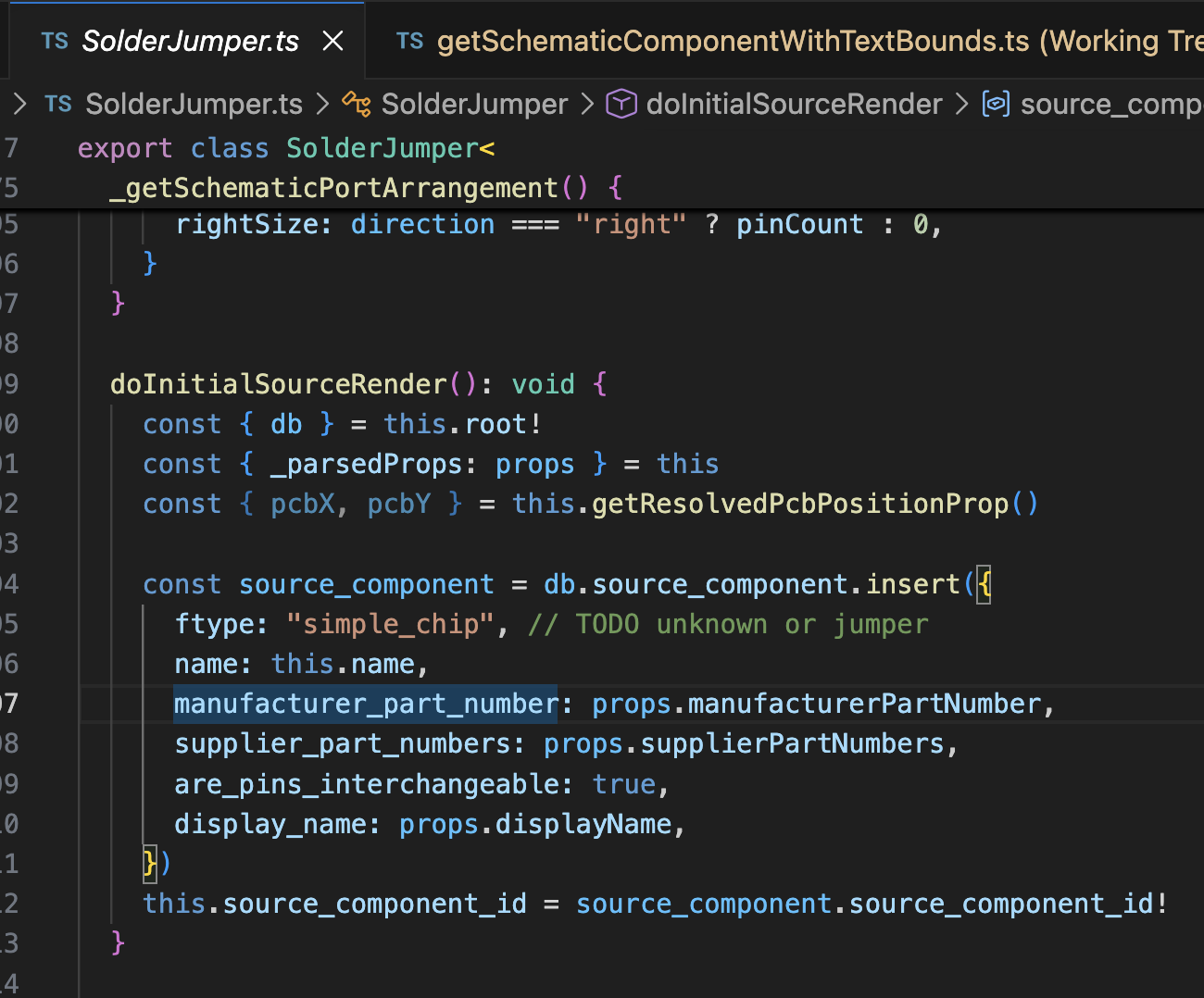

why is solderjumper's ftype simple chip?
Started by Mustafa7Aug 4, 202612 messages
probably a bug
simple_chip is a backup in many cases
What should it be then? There is no "simple_solder_jumper" type
sometimes we can propose a new one but a solder jumper is more like a jumper
wondering why this is coming up btw

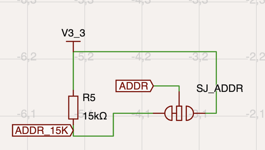

for this, was trying to add solderjumper for textbounds of trace-solver input
nvm
astrimid
> What should it be then? There is no "simple_solder_jumper" type in SPICE modeled as a resistor with very small resistance and a switch. On schematics, zero ohm resistor with "optional" annotation. In PCB, it's probably just footprint, pads with solder mask or copper trace which acts as "do not place" constraint

As I understand, there are two solder jumpers: normally open (jumper_open, very close pads) and normally closed (jumper_bridge, net tie)
