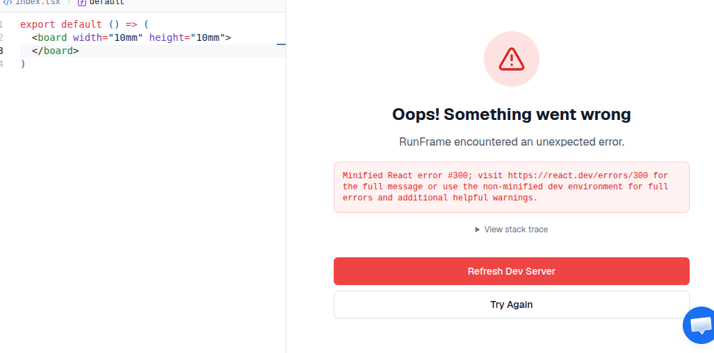

0hmx - anyone else face this in regular?
Started by 0hmxAug 3, 202694 messages
astrimid
Yes, I face this every couple of hours
astrimid

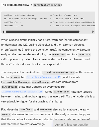

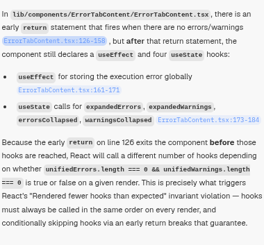

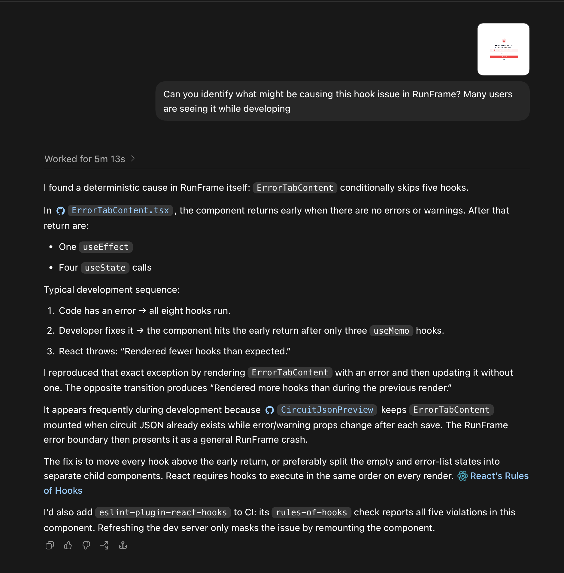

From my react experience, this happens when you wrap hook in a condition
astrimid
So it looks like if there are any errors the ErrorTabComponent exits early and doesn't render anything, but then if error appear while the component is still mounted and there were no error previously, it would crash. If my theory is right, here are steps to reproduce: 1. Make sure there are no errors 2. Open error tab 3. Introduce a code change that triggers an error You should see the error/warning tab crashed

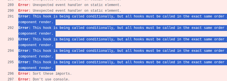

https://github.com/tscircuit/runframe/pull/4295 If this fails, it probably means there's something wrong with biome documentation or version or config If this passes, it means, the biome doesn't catch the error, which would mean the problem with either biome not part of CI or ErrorTabComponent is excluded from linting.
astrimid
Ok. It passes. Which makes it more puzzling
astrimid
Ok. I checked the workflow files, and there's no trace of biome running at all, meaning that it's not a part of CI
astrimid
Yeah, biome wasn't running at all: https://github.com/tscircuit/runframe/actions/runs/30852249198/job/91814790604?pr=4296

<@757706909351411845> This is a kind of task I would delegate to AI ^
astrimid
But I suspect it would fail meserably

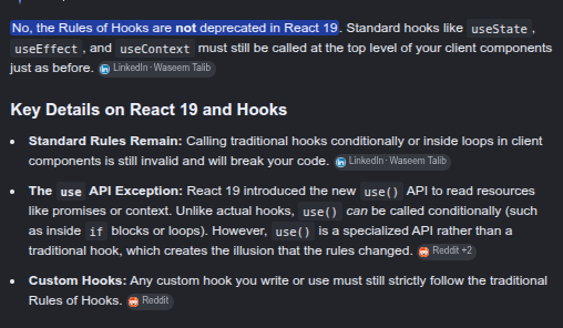

rule of hooks is a basic rule that would cause a component to crash if you don't follow it
astrimid
it is non-negotiable
astrimid
if you don't trust me, ask AI
it has nothing to do with that
you're literally referencing some random third party library
it isn't built into biome

so I dug deeper and discovered biome isn't being run at CI at all
astrimid
So I added the workflow to run biome
astrimid
Which expectedly failed with a number of issues

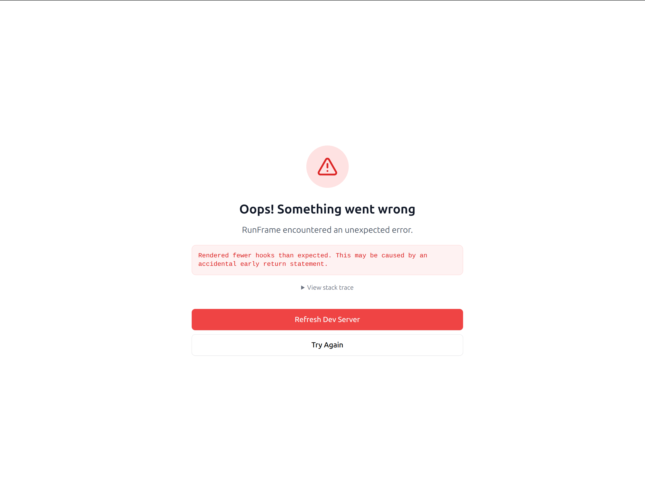

how was this reproduced?
astrimid
what exactly?
the error tab content has an obvious bug, but i'm not sure that's the actual root cause (hopefully it is)
astrimid
It's literally written on the screenshot "rendered fewer hooks than expected". This is an error message from react
yes we all know that is the error
astrimid
any time you change number of hooks by changing the conditional
how do you reproduce it is the question

the question is how does a user reproduce the issue
i.e. what action do they perform in RunFrame or with their circuit that causes this error page to appear
https://github.com/tscircuit/runframe/pull/4297
^ i'm suggesting that this is not the root cause
astrimid
I've posted the steps at the very start of the thread: 1. Create a circuit that doesn't cause any warnings or errors 2. Make sure the errors tab is open 3. Introduce a warning or error 4. Fix that warning or eror

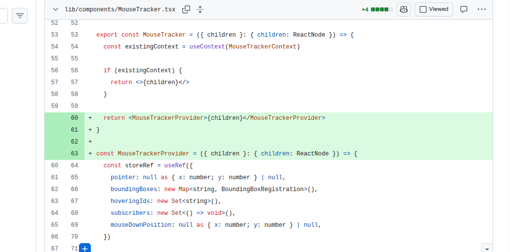

https://github.com/tscircuit/schematic-viewer/pull/248/files
astrimid
The lint error is gone
astrimid
So it was the only occurrence in runframe
check out the schematic-viewer PR, that is also an out of order issue- but not one a linter picks up
